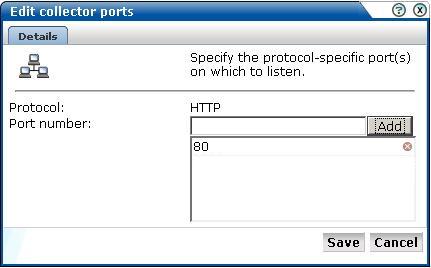

Select Configuration, then Security, and then Protocols. The currently monitored ports are displayed. An example is shown in Figure 1-1.
Use the View menu to select each Collector. The System (localhost) item represents the local server system.
If the port number is not already listed, click the required protocol (HTTP or HTTPS). The dialog shown in Figure 1-2 appears.
To add a new port number, enter the required number in the Port number field, and click Add. To remove a port from the list, click the Remove icon to the right of the port number. When ready, click Save.
For each Collector, you are prompted to restart the Collector. This is necessary in order to make the changes effective. Note you can also restart the selected Collector by clicking the Restart Collector icon shown in Figure 1-1.

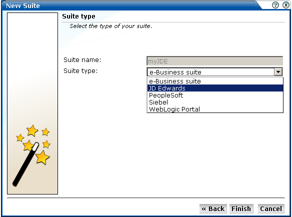

Within the RUEI Reporter, create and configure the suite definition(s) required for your JD Edwards-based applications. Do the following:

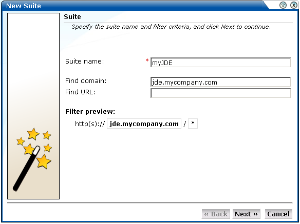

Select Configuration, then Applications, and Suites. Click New Suite. The dialog shown in Figure 1-3 appears.
Specify a name for the suite. The name must be unique across suites, services, and applications, and is restricted to a maximum of six characters. Note the suite cannot be renamed later.
Use the remaining fields to specify the scope of the suite. This is defined in terms of partial page URLs. Note that as you enter this information, you can see the effect of your definition through the Filter preview column. The use of blank filters is not permitted. While the use of a wildcard character (*) is permitted, all other specified characters are interpreted as literals. When ready, click Next. The dialog shown Figure 1-4 appears.
Filter definitions should be mutually exclusive across suites, applications, SSO profiles, and services. For example, do not define a suite filtered on the domain "us.oracle.com" and then another suite, application, SSO profile, service filtered on "us.oracle.com/application_servlet". The use of non-mutually exclusive filter definitions can lead to unpredictable results.This dialog allows you to specify the Oracle Enterprise architecture upon which the suite is based. The number of options available in this menu depends on the suite packages currently installed. Select the option "JD Edwards". When ready, click Finish. The suite definition you have specified is displayed. An example is shown in Figure 1-5.

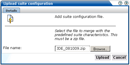

Select Configuration, then Applications, then Suites, and select the suite you defined earlier in Section 1.5, "Creating the JD Edwards Suite Definition". The dialog shown in Figure 1-6 appears.
Figure 1-6 Upload Suite Configuration File
Specify the name of the .zip file containing the generated .txt files. If you manually create .txt files, you should use the same structure present in the .zip file. To protect against empty definitions, the upload will fail when it contains empty .txt files. When ready, click Upload.

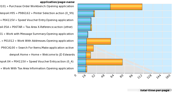

To ensure the quality of the data being collected and reported by RUEI for your JD Edwards-based applications, it is strongly recommended you verify their reported details. You should pay particular attention to the number of associated pages detected for the defined suite(s).
Select Browse data, then select the All pages group, and then the Applications sub-group. Within the individual dimensions, such as Pageviews and hits, you can see pageviews are reported for several applications. The suite name in the definition is shown between brackets. An example is shown in Figure 1-7.
