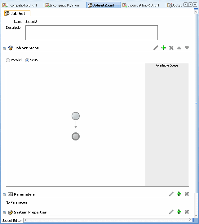

    4. Click OK. This creates the job set and displays the Job Set Definition page, as shown in Figure 11-1.
      Figure 11-1 Job Set Editor with Serial Job Set
      Job Set Editor with serial job set
  5. In the Job Set Editor pane, in the Description field enter a description for the job set.
  6. In the Job Set Steps area, select the Parallel or Serial radio button to specify parallel or serial execution mode for the job set.

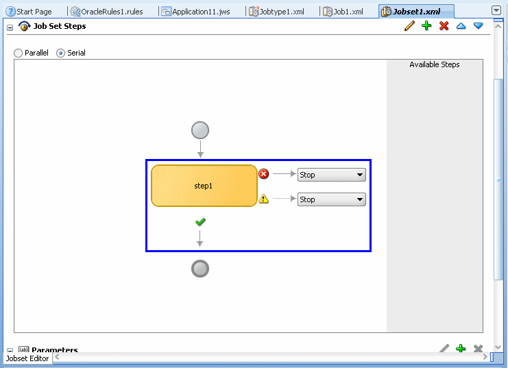

    Figure 11-2 Job Set with a Step Added
    Job set with a step added
  10. From the dropdown list next to the error icon, select Stop or select the step for the ERROR terminal state for the step. For example, from the dropdown list select Step_error (Step_error needs to be defined).
  11. From the dropdown list next to the warning icon, select Stop or select the step for the WARNING terminal state for the step. For example, from the dropdown list select Step_warning (Step_warning needs to be defined).

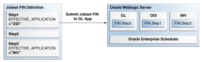

11.3 Cross Application Job Sets
Oracle Enterprise Scheduler provides the capability for a job or a job set to execute across multiple applications as shown in Figure 11-5:
Figure 11-5 Cross Application Job Set Steps
Cross application job set steps
11.3.1 Overview of Cross Application Job Sets
A job set runs in its hosting application and by default, all job set steps also run in this application. A job set step can be associated with a different application by defining the EFFECTIVE_APPLICATION system property on the step. If the step is a job, the job will execute in the effective application. If the step is a nested job set, the jobs in the nested job set execute in the effective application. When EFFECTIVE_APPLICATION is defined for a step, the request for the step and any child requests of the step are associated with the effective application, meaning the APPLICATION system property for those requests will be set to the effective application.
The EFFECTIVE_APPLICATION system property may only be defined in metadata, specifically job set, job set step, job type, and job. The property EFFECTIVE_APPLICATION is not supported in the request parameters. The effective application must be in the same cluster as the hosting application, or an error will result. If a submitted job set defines the effective application, that value must be the same as the hosting application, or the job set submission will be rejected.
Subrequests created by a job set step must run in the same application as the job set step. In other words, EFFECTIVE_APPLICATION is not supported for subrequests. If the job for a subrequest defines the effective application, that value must be the same as the application of the job submitting the subrequest, or the subrequest submission will be rejected.
For a job set that executes across multiple applications, querying for requests by application is not sufficient to retrieve all children. Oracle Enterprise Scheduler supports absolute parent id as a query field, making it possible to query for all requests in a job set regardless of the application. The absolute parent id is the request id of the job set that was submitted to the hosting application.
