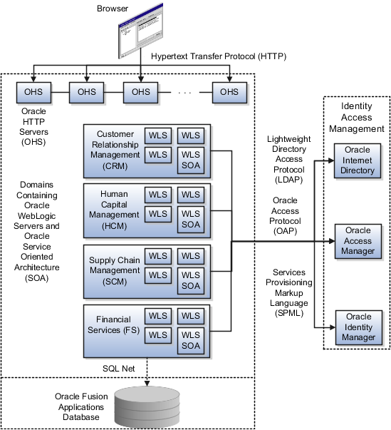

As the guiding network security principle of most deployments, the middleware servers for Oracle Fusion Applications run on an isolated network within the larger corporate network. Accordingly, Enterprise Deployment Architecture (EDA) stipulates network isolation for various functional groups. Each functional group of software components is isolated in its own firewall separated by demilitarized zones (DMZ). All traffic is restricted by protocol and port. SSL is configured to secure all the network segments between Oracle Fusion Application components and enterprise infrastructures outside of the Oracle Fusion Application functional groups.
The network architecture of the enterprise deployment guidelines includes the following.
The Web servers (Oracle HTTP Server (OHS)), the application servers (WebLogic Server (WLS)), and all other servers for your Oracle Fusion Applications instance run within a single isolated network.
The Oracle Fusion Applications Database, Business Intelligence, Content Management, and Search services all run in either the same isolated network or each in its own isolated network that can only be reached via the applications private network.
Centralized services such as Oracle Identity Management (OIM) servers are assumed to operate outside of these isolated networks.
The connection to the database is assumed to be between two isolated networks.
There are no connections to external Web services configured by initial provisioning.
Given that this network topology is the target, the enterprise deployment guidelines recommend enabling SSL appropriately for all connections leading into or out of the isolated networks.
The figure shows the connections that are SSL enabled in an Oracle Fusion Applications deployment. The connections among the Oracle WebLogic Servers (WLS) and domains of the Oracle Fusion Applications deployment are not SSL enabled because the enterprise deployment guidelines require and assume that the subnets in the data center where Oracle Fusion Application is deployed are secured by network firewalls preventing direct access of Oracle Fusion Application components by users and applications outside the data center. The connection to the Oracle Fusion Applications database in an adjoining protected zone is also not SSL enabled. But connections to the identity access management components are SSL enabled.
