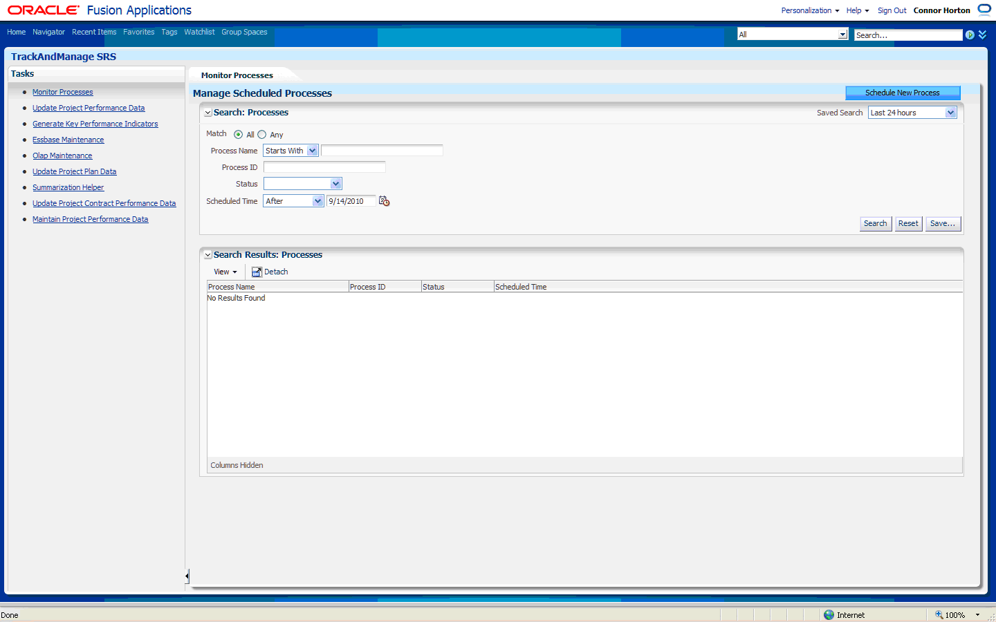

    In the upper left corner, select Manage Scheduled Processes.
    Figure 43. Monitor Processes Link
    This screen shot displays the location of the Monitor Processes link.
  3. Select Manage Scheduled Process button in the upper left corner.
  4. Select Schedule New Process button in the upper right corner.
    Figure 44. Schedule New Process
    This screen shot displays the location of New Process button on Schedule New Process dialog.

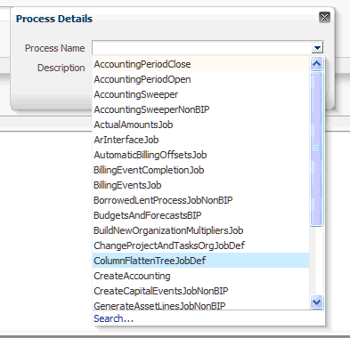

  5. Select the process name ColumnFlattenTreeJobDef.
    Figure 45. Process Details
    This screen shot displays the Process Details window with available process names.

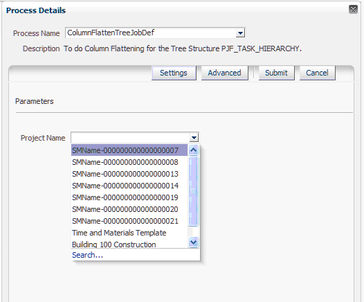

  6. A list of existing Project names is displayed. Select the desired Project.
    Figure 46. Project Name
    This screen shot displays how to select a project name from the Process Details window.

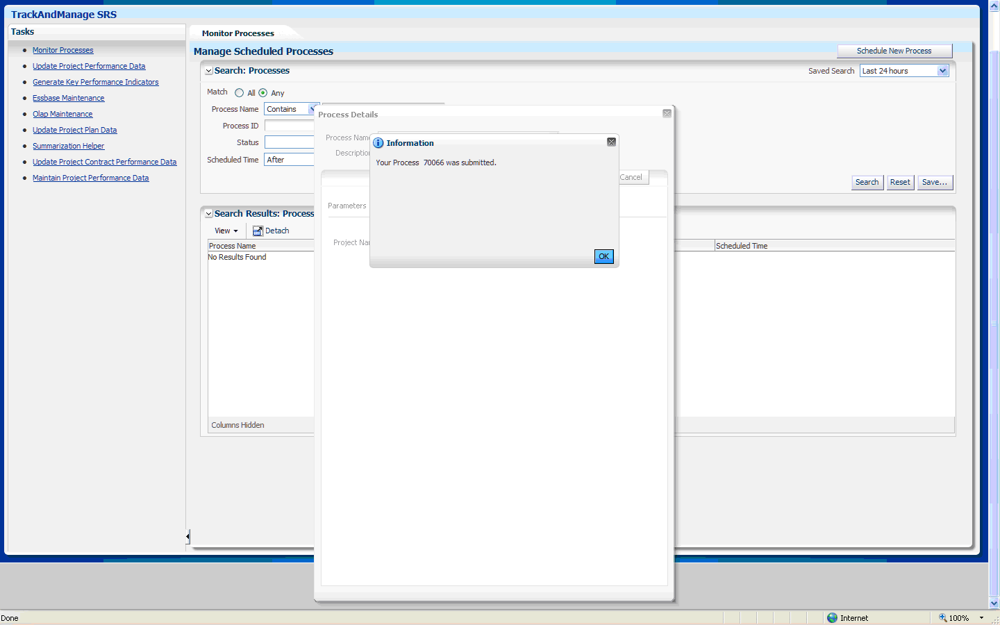

  7. A confirmation on the process submission is displayed. Note the Process ID.
    Figure 47. Process ID Confirmation
    This screen shot displays confirmation on the process submission and to note the Process ID number.

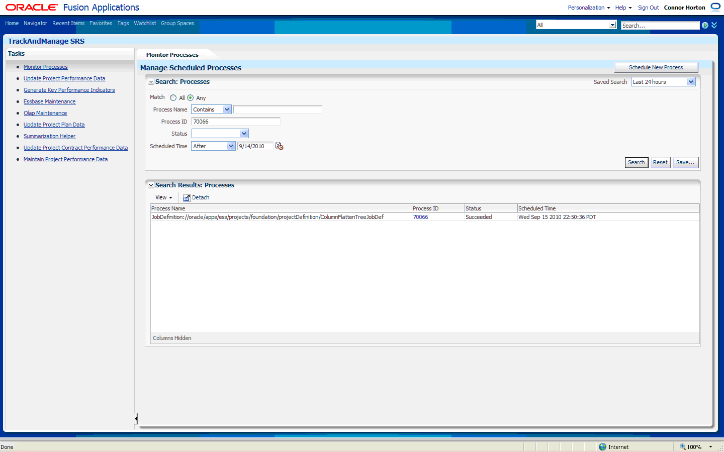

  8. Selecting the confirmation button launches the ESS column-flattening job as a background ESS process. From this point forward, you can monitor the progress of the column-flattening job through the Process Status window using the previously returned Process ID.
    Figure 48. Search for Process ID
    This screen shot displays the ESS column-flattening job as a background ESS process. and monitors the progress of the column-flattening job through the Process Status window using the previously returned Process ID.
