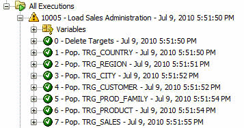

  3. The log for the execution session of the Load Sales Administration Package appears as shown in Figure 8-1.
    Figure 8-1 Load Sales Administration Package Session Log
    Surrounding text describes Figure 8-1 .

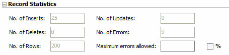

8.1.3.1 Determining the Number of Processed Records
To determine the number of records that have been processed by the Pop. TRG_CUSTOMER interface (this is the number of inserts, updates, deletes, and errors):
  1. In the Session List accordion in Operator Navigator, expand the All Executions node.
  2. Refresh the displayed information clicking Refresh in the Operator Navigator toolbar menu.
  3. Expand the Load Sales Administration Package Session and open the Session Step Editor for the Pop. TRG_CUSTOMER step. This is step 4.
  4. On the Definition tab of the Session Step Editor, you can see in the Record Statistics section that the loading of the TRG_CUSTOMER table produced 25 inserts and isolated 9 errors in an error table.
    Figure 8-2 shows the Record Statistics section of the Session Step Editor:
    Figure 8-2 Record Statistics in the Session Step Editor
    Surrounding text describes Figure 8-2 .

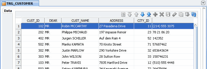

8.1.3.2 Viewing the Resulting Data
In this example, the resulting data are the 25 rows that have been inserted in the TRG_CUSTOMER table during the interface execution.
To view the data resulting of your interface execution:
  1. In Designer Navigator, expand the Models accordion and the Sales Administration - HSQL model.
  2. Select the TRG_CUSTOMER datastore.
  3. Right-click and select View Data to view the data in the target table.
    Note that you can also select Data... to view and edit the data of the target table.
    The View Data Editor is displayed as shown in Figure 8-3.
    Figure 8-3 View Data Editor
    Surrounding text describes Figure 8-3 .

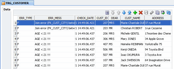

8.1.3.3 Reviewing the Invalid Records and Incorrect Data
You can access the invalid records by right-clicking on the datastore in your model and selecting Control > Errors...
To review the error table of the TRG_CUSTOMER datastore:
  1. In Designer Navigator, expand the Sales Administration - HSQL model.
  3. Right-click and select Control > Errors...
  4. The Error Table Editor is displayed as shown in Figure 8-4.
    Figure 8-4 Error Table of TRG_CUSTOMER
    Surrounding text describes Figure 8-4 .
The interface that you have executed has identified and isolated 9 invalid records in an error table that was automatically created for you.
In this error table, you can see that the interface rejected:
  • 2 records that did not satisfy the FK_CUST_CITY constraint (for example, the CITY_ID value does not exist in the table of cities SRC_CITY table).
  • 7 records that did not satisfy the business rule acting on customers under 21 (AGE > 21 constraint).
    The invalid records were saved into an error table and were not integrated into the target table.

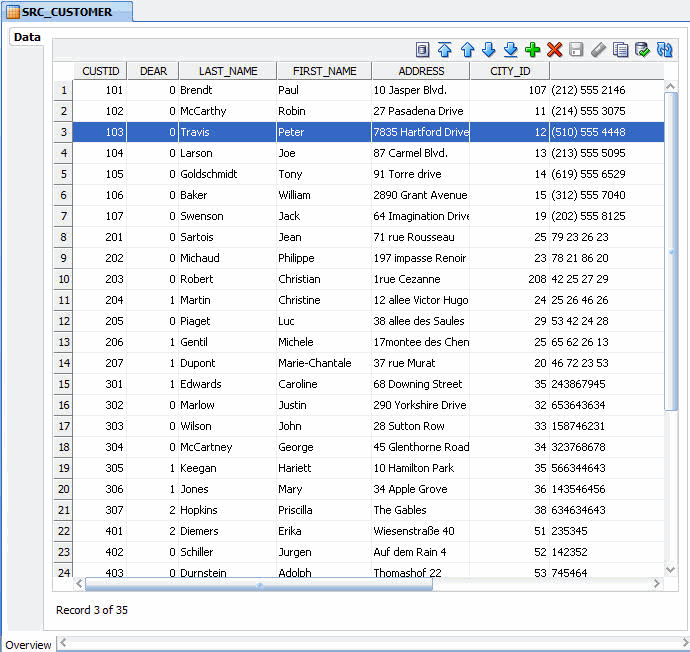

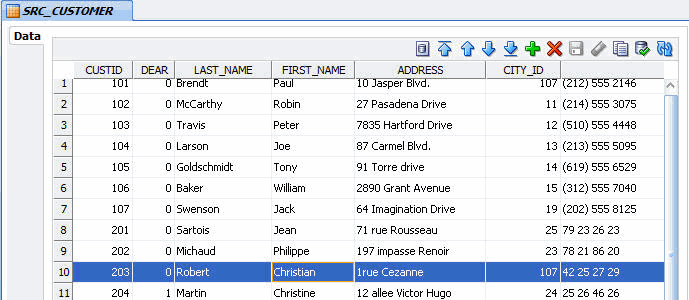

8.1.3.4 Correcting Invalid Data
To rectify invalid data:
  1. In Designer Navigator, expand the Orders Application - HSQL model.
  2. Select the SRC_CUSTOMER datastore.
  3. Right-click and select Data.
  4. The Data Editor is displayed as shown in Figure 8-5.
    Figure 8-5 Data Editor
    Surrounding text describes Figure 8-5 .
    In the Data table, search for the client row having a CUSTID equal to 203.
    Note that you can sort the table by clicking on the column headers. If the customer 203 is not visible, click Refresh data in the menu toolbar to refresh the display.
  5. The CITY_ID value of this customer is 208. This CITY_ID is not listed in the SRC_CITY table. Double-click on the value of the CITY_ID column for this customer in order to modify it. Enter 107 in the CITY_ID field.
  6. Press Enter to validate your entry.
  7. The Data Editor is displayed as shown in Figure 8-6.
    Figure 8-6 Data Editor with new CITY_ID value
    Surrounding text describes Figure 8-6 .

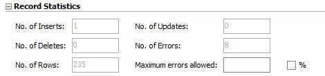

8.1.3.5 Review the Processed Records
To review the processed records:
  1. In Operator Navigator, open the Session Step Editor for the Pop. TRG_CUSTOMER step.
  2. If required, click Refresh in the Operator Navigator menu toolbar.
  3. On the Definition tab of the Session Step Editor, you can see in the Record Statistics section that the loading of the TRG_CUSTOMER table produced 1 insertion (this is the record that you have modified in Section 8.1.3.4, "Correcting Invalid Data") and isolated 8 errors in an error table.
    Figure 8-8 shows the Record Statistics section of the Session Step Editor.
    Figure 8-7 Record Statistics of the Session Step Editor
    Surrounding text describes Figure 8-7 .

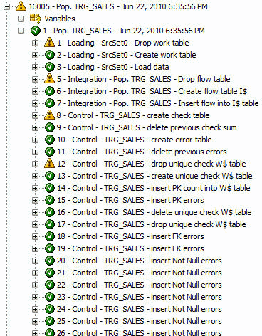

8.2.2 Follow the Execution of the Interface in Operator Navigator
To view the execution results of your integration interface:
  3. The log for the execution session of the Pop. TRG_SALES interface appears as shown in Figure 8-8.
    Figure 8-8 Pop. TRG_SALES Interface Session Log
    Surrounding text describes Figure 8-8 .

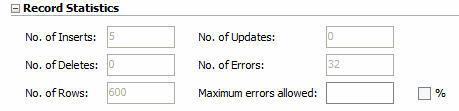

8.2.3.1 Determining the Number of Processed Records
To determine the number of processed records:
  1. In Operator Navigator, open the Session Step Editor for the Pop. TRG_SALES step.
  3. On the Definition tab of the Session Step Editor, you can see in the Record Statistics section that the loading of the TRG_SALES table produced 5 inserts and isolated 32 errors in an error table.
    Figure 8-9 shows the Record Statistics section of the Session Step Editor:
    Figure 8-9 Record Statistics in the Session Step Editor
    Surrounding text describes Figure 8-9 .

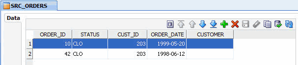

    These 5 inserts are the 5 rows that have been inserted because of the changes you have performed in Section 8.1.3.4, "Correcting Invalid Data". Changing the CITY_ID of the customer with the CUST_ID = 203 to a CITY_ID that is listed in SRC_CITY table, adds the sales performed by the customer 203 to the TRG_SALES table. These 5 sales operations are highlighted in Figure 8-12.

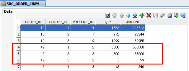

    Note that the customer with the CUST_ID = 203 actually performed 7 sales operations. You can identify these 7 operations as follows:
    1. In the SRC_CUSTOMER table, determine the ORDER_IDs of the customer with the CUST_ID = 203. Figure 8-10 shows that this customer has two ORDER_IDs: 10 and 42.
      Figure 8-10 ORDER_IDs corresponding to CUST_ID = 203
      Surrounding text describes Figure 8-10 .
    2. As shown in Figure 8-11, the SRC_ORDER_LINES table lists 7 order lines for the ORDER_IDs 10 and 42.
      Figure 8-11 ORDER_LINES for ORDER_IDs 10 and 42
      Surrounding text describes Figure 8-11 .
      The highlighted order lines have the same PRODCT_ID and are merged into one line (line 23) in the TRG_SALES table shown in Figure 8-12.

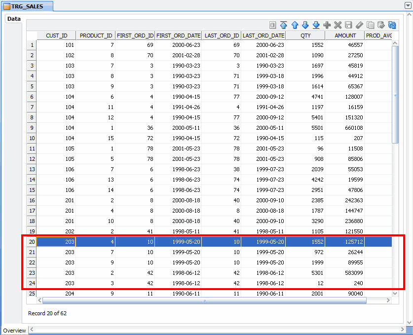

8.2.3.2 Viewing the Resulting Data
Note that the Pop. TRG_SALES interface has already been executed in the Load Sales Administration package. This is why the TRG_SALES table now contains 62 rows and not only 5 inserts as shown in Figure 8-9.
  2. Select the TRG_SALES datastore.
    The View Data Editor is displayed as shown in Figure 8-12.
    Figure 8-12 View Data Editor for TRG_SALES
    Surrounding text describes Figure 8-12 .

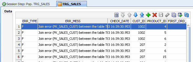

8.2.3.3 Reviewing the Invalid Records and Incorrect Data
To review the error table of the TRG_SALES datastore:
  4. The Error Table Editor is displayed as shown in Figure 8-13.
    Figure 8-13 Error Table of TRG_SALES
    Surrounding text describes Figure 8-13 .
The interface that you have executed has identified and isolated 32 invalid records in an error table that was automatically created for you.
  • 31 records in violation of the FK_SALES_CUST constraint (for example, have a customer number that does not exist in the table of customers)
  • 1 record in violation of the FK_SALES_PROD constraint (has a product number that does not exist in the table of products)
The invalid records were saved into an error table and not integrated into the target table.
