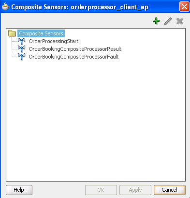

Right-click a specific service or reference binding component in the Exposed Services or External References swimlane to which to add a composite sensor, and select Composite Sensors.
The Composite Sensors dialog for the selected binding component appears, as shown in Figure 47-1.
Figure 47-1 Composite Sensors Dialog for the Selected Binding Component

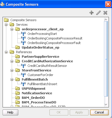

Click the Composite Sensor icon above the SOA Composite Editor, as shown in Figure 47-2.
The Composite Sensors dialog for the SOA composite application appears, as shown in Figure 47-3.
Select the specific service or reference to which to add a composite sensor, then click the Add icon.

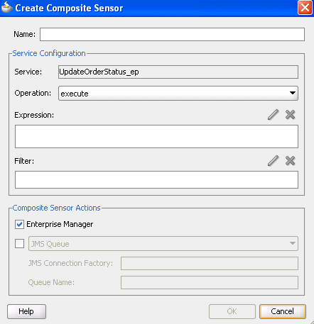

The Create Composite Sensor dialog appears, as shown in Figure 47-4.
Figure 47-4 Create Composite Sensor Dialog
Enter the details shown in Table 47-1.
Table 47-1 Create Composite Sensor Dialog
| Name | Description |
Name |
Enter a name for the composite sensor. You must enter a name to enable the Edit icon of the Expression field. |
Service |
Displays the name of the service. This field only displays if you are creating a composite sensor for a service binding component. This field cannot be edited. Service sensors monitor the messages that the service receives from the external world or from another composite application. |
Reference |
Displays the name of the reference. This field only displays if you are creating a composite sensor for a reference binding component. This field cannot be edited. Reference sensors monitor the messages that the reference sends to the external world or to another composite application. |
Operation |
Select the operation for the port type of the service or reference. |
Expression |
Click the Edit icon to invoke a dropdown list for selecting the type of expression to create:
Filter |
Click the Edit icon to invoke the Expression Builder dialog to create an XPath filter for the expression. You must first create an expression to enable this field. For example, you may create an expression for tracking purchase order amounts over $in.inDict/tns:inDict/ns2:KeyValueOfstringstring/ns2:Value > 10000.00 |
Composite Sensor Actions |
Displays the supported sensor actions. This feature enables you to store runtime sensor data. You can select both Enterprise Manager and either JMS Queue or JMS Topic.
Notes: The JMS Queue and JMS Topic selections enable the composite sensor data (XML payload) to be used by other consumers, including Oracle Business Activity Monitoring and Oracle Complex Event Processing (CEP). Both selections use the native JMS support provided with Oracle WebLogic Server, and not the Oracle SOA Suite JMS adapter described in Oracle Fusion Middleware User's Guide for Technology Adapters. You can view JMS messages in the Oracle WebLogic Server Administration Console. For information about using sensor data with Oracle Business Activity Monitoring, see Chapter 50, "Integrating Oracle BAM with SOA Composite Applications." |
Click Apply to add more composite sensors.
Click OK when complete.

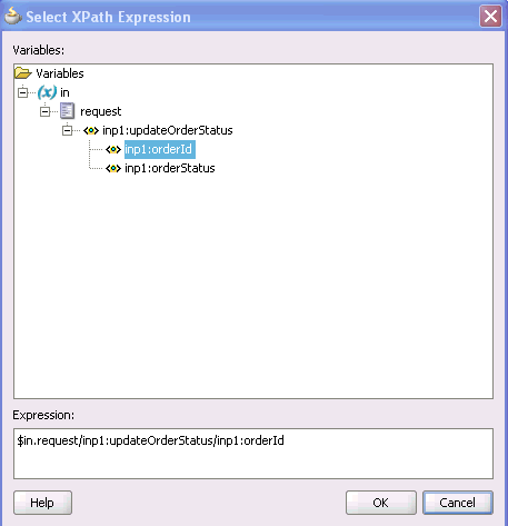

The Select XPath Expression dialog shown in Figure 47-6 enables you to select an element for tracking.
To add a variable:
Expand the tree and select the element to track.

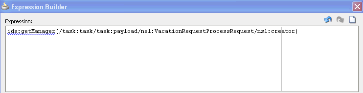

The Select Properties shown in Figure 47-7 enables you to create an expression for tracking.
To add an expression:
Build an XPath expression of an element to track.

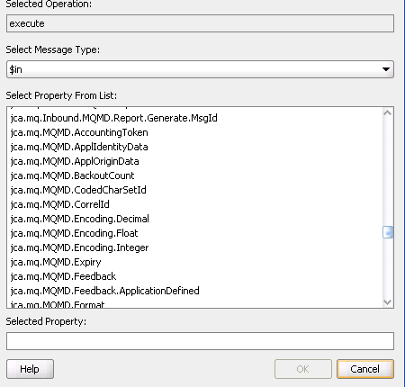

The Select Property shown in Figure 47-8 enables you to select a normalized message header property for tracking.
To add a property:
Select a normalized message header property to track.
