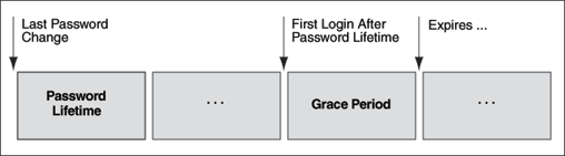

You can also specify a grace period for password expiration. Users enter the grace period upon the first attempt to log in to a database account after their password has expired. During the grace period, a warning message appears each time users try to log in to their accounts, and continues to appear until the grace period expires. Users must change the password within the grace period. If they do not change the password within the grace period, then they are prompted for a new password each time they try to access their accounts. Access to an account is denied until a new password is supplied.
Figure 3-1 shows the chronology of the password lifetime and grace period.
Figure 3-1 Chronology of Password Lifetime and Grace Period
In the following example, the profile assigned to johndoe
includes the specification of a grace period: PASSWORD_GRACE_TIME = 3
(the recommended value). The first time johndoe
tries to log in to the database after 90 days (this can be any day after the 90th day, that is, the 91st day, 100th day, or another day), he receives a warning message that his password will expire in 3 days. If 3 days pass, and if he does not change his password, then the password expires. After this, he receives a prompt to change his password on any attempt to log in, and cannot log in until he does so.
