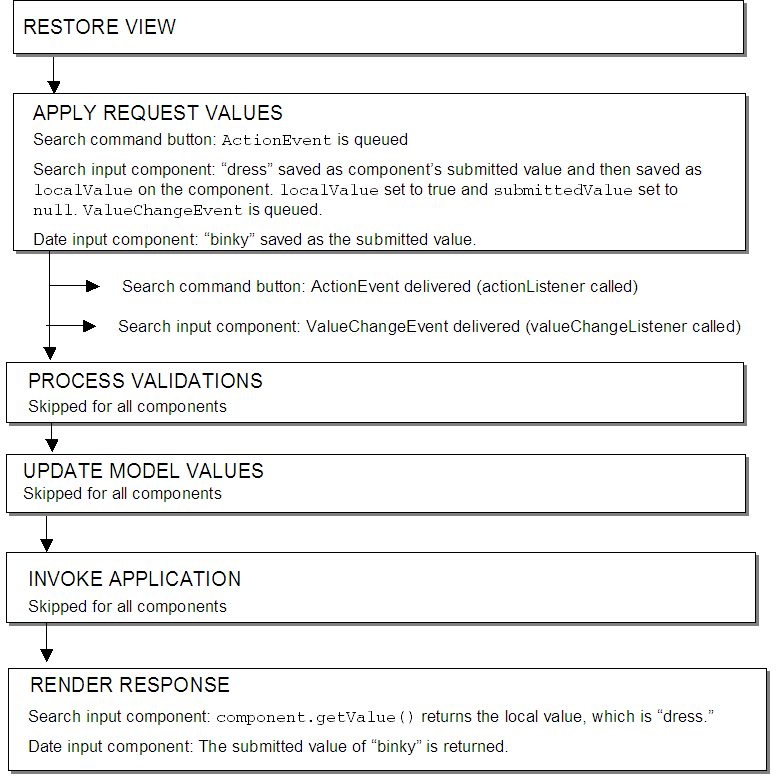

Figure 4-5 shows the lifecycle for this page when a user does the following:
Enters binky
into the Date input field (which is not a valid entry)
Enters dress
into the Search field
Clicks the Search button to execute the search on dress
Clicks the Save button to save the value binky
as the date

Example 4-5 Using the immediate Attribute and a valueChangeListener
<af:form> <af:selectOneRadio immediate="true" valueChangeListener="#{validate.toggle}" id="show2" autoSubmit="true" text="Show" value="#{validate.show2}"/> <af:selectOneRadio id="hide2" autoSubmit="true" text="Hide" value="#{validate.hide2}"/> <af:panelGroupLayout partialTriggers="show2 hide2"> <af:inputText label="Required Field" required="true" rendered="#{validate.show2}"/> </af:panelGroupLayout> </af:form>
Example 4-6 shows the valueChangeListener
code.
