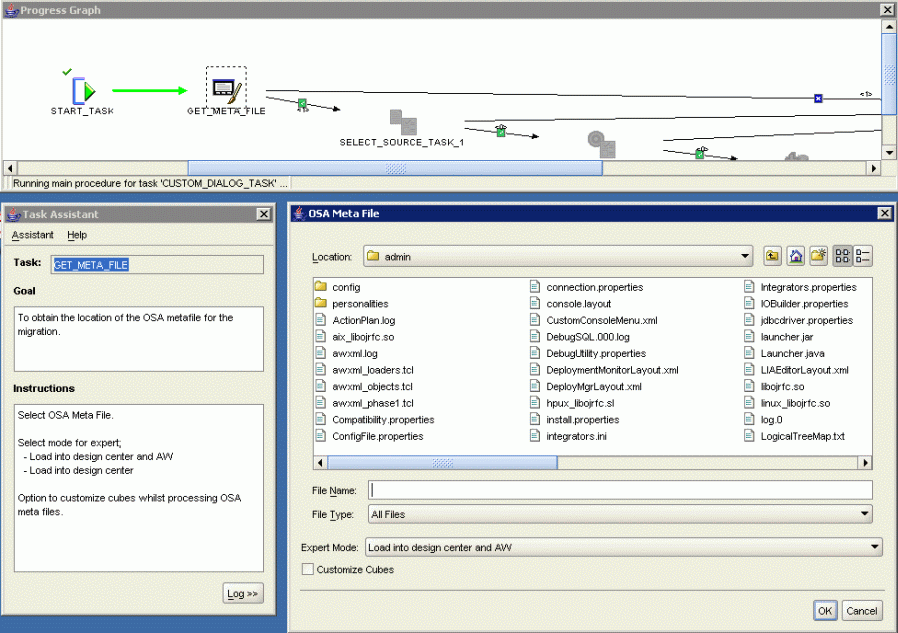

Figure 4-1 shows how an expert might look to a user. Three separate windows are displayed:
Progress Graph: Displays the expert in the same format as it appears on the editing canvas, but the executed transitions and the current task are highlighted. This window serves the same purpose as bread-crumbs, tracking the user's progress through the expert. It can also be a helpful debugging tool. You can set a property on the expert that controls whether the progress graph is displayed or hidden.
Task Assistant: Displays the name of the current task, its goal, and instructions for using it. You provide this information on the property sheets for the task as part of its definition. You can set a property on the expert that controls whether the task assistant is displayed or hidden.
Task Display: Tasks that obtain information from the user display various types of graphical user interfaces. Among these tasks are those that display Warehouse Builder components, such as the Object Editor, and those that provide basic functions, like the file selector shown in the figure. In this example, the user selects a file, and the filename is passed as an input parameter to the next task. You can also store the value in a variable to use later.

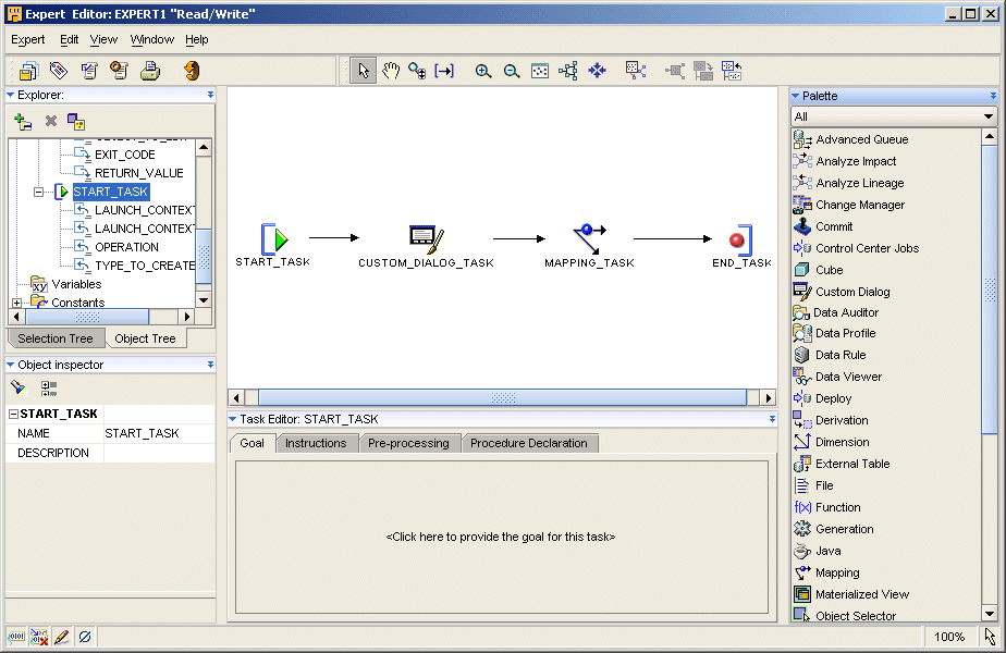

The Expert Editor provides the canvas and the palette that you need to create, modify, and deploy experts.
Figure 4-2 shows the Expert Editor with a sample expert. Tasks appear as icons on the canvas. The arrows connecting the tasks are transitions. Transitions identify the order in which the tasks are executed.
The Expert Editor is very similar to the Process Flow Editor. If you have created process flows, you will be able to adapt your knowledge very quickly to developing experts. However, there are important differences as well as important similarities.

Tasks represent units of work for the expert. When you design an expert in Warehouse Builder, you select tasks from the Expert Editor palette and drag them onto the canvas. The Expert Editor initially has the Start and the End tasks already positioned on the canvas.
To add a task to an Expert:
Select a task from the palette and drag it onto the canvas.
Or
From the Expert menu, choose Add, then choose a category from the popup menu. Select a task from the category.
The editor displays the task on the canvas.
In the Task Editor, complete the tabs for the various properties of that task.
These properties vary according to the type of task. All tasks have the Goal, Instructions, Pre-processing, and Post-Processing properties. Some tasks such as the Custom Dialog and OMB tasks include additional properties.
For information about these properties, click Help from the popup menu on the Task Editor title bar.
Use the Explorer and the Object Inspector to enter values for the parameters of the task.
Tasks have input parameters and output parameters. Refer to "Passing Data Values Among Tasks" for methods of providing values to the input parameters.
To change the name of the task or add a description, right-click the icon on the palette and select Edit Details from the popup menu.
The Edit Task dialog box is displayed. Click Help for more information.
