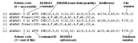

Set the debug environment generalTrace parameter to true to generate entries in the standard log racing the access to Adabas data.
