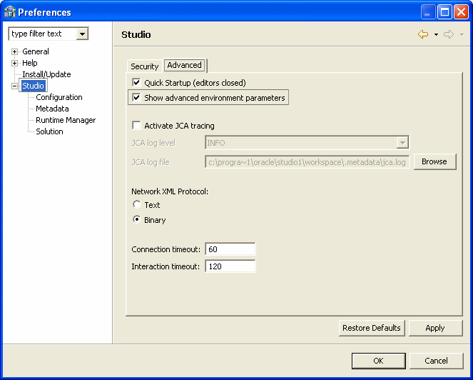

  1. Open Oracle Studio for IMS, VSAM, and Adabas Gateways.
  2. From the main menu, click Windows, Preferences.
    The Preferences screen is displayed.
    Figure 4-2 Studio Preferences
    Studio Preferences
    Description of "Figure 4-2 Studio Preferences"
  3. In the left pane, click the Studio node.
  4. Click the Advanced tab.
  5. Select the Show advanced environment parameters check box.
  6. Click OK.

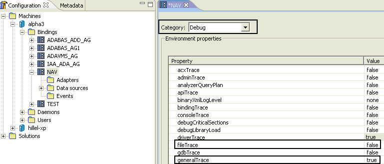

  7. In the Design Perspective Configuration view, right-click the binding under which the Oracle data source is located and select Edit Binding.
  8. From the Category list, select Debug.
  9. Set the driverTrace and generalTrace parameters to TRUE.
    Figure 4-3 Binding Properties
    Binding Properties
    Description of "Figure 4-3 Binding Properties"
  10. Execute the following query: Select * from upd_dt limit to 3 rows
The following is a sample log file output:
