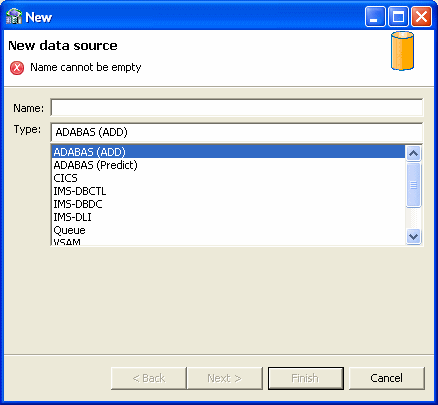

Right-click Data Source and select New Data Source.
The New Data Source screen opens, as shown in Figure 5-2.
Specify a name for the data source in the Name field.
Select IMS-DLI from the Type list.
Click Next.
The Data Source Connect String screen opens.
Click Finish.
The New Data Source screen opens, as shown in Figure 5-4.
Select IMS-DBDC from the Type list.
Click Next.

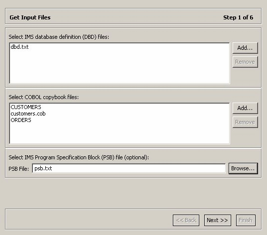

This section describes the steps required to select the input files that will be used to generate the metadata. The IMS/DB data source requires three types of files, DBD files, COBOL copybooks, and PSB source files. See Select the Input Files for an explanation of these files.
Perform the following task to enter the input files.
In the Configuration view, right-click the data source and select Edit Metadata.
The Metadata tab is displayed with the data source displayed in the Metadata view.
Right-click the Imports node under the data source and select the New Import menu option.
Enter a name for the import. The name can contain letters, numbers and the underscore character.
Select IMS/DB Import Manager as the import type.
Click Finish. The Metadata Import Wizard is displayed.

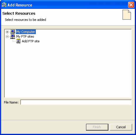

Click Add in the Import Wizard to add DBD files. The Add Resource screen opens, providing the option of selecting files from the local machine or copying the files from another machine.
Figure 5-5 shows the Add Resource screen.
If the files are located on a UNIX or Windows computer, do the following:
Right-click My FTP Sites and select Add.
The Add FTP Site screen opens, as shown in the following figure.
Enter the server name where the COBOL copybooks are located and, if not using an anonymous connection, enter a valid username and password to access the computer. The username is then used as the high-level qualifier.
Click OK. After accessing the remote computer, you can change the high-level qualifier by right-clicking the machine in the Add Resource screen and selecting Change Root Directory.
Select the files to import and click Finish to start the file transfer. When complete, the selected files are displayed in the Get Input Files screen.

Click Add in the Import wizard to add a PSB source file, if necessary.
The selected files are displayed in the Get Input Files screen, as shown in Figure 5-6.

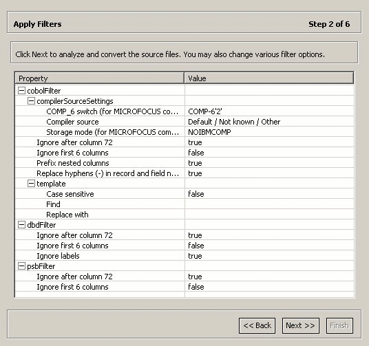

This section describes the steps required to apply filters on the COBOL Copybook files used to generate the Metadata. It continues the Select the Input Files task.
Perform the following task to apply filters.
Click Next.
The Apply Filters screen opens in the editor, as shown in Figure 5-7.
Apply filters to the copybooks, as needed.
The following COBOL filters are available:
COMP_6 switch: The MicroFocus COMP-6 compiler directive. Specify either COMP-6'1' to treat COMP-6 as a COMP data type or COMP-6'2' to treat COMP-6 as a COMP-3 data type.
Compiler source: The compiler vendor.
Storage mode: The MicroFocus Integer Storage Mode. Specify either NOIBMCOMP for byte storage mode or IBMCOMP for word storage mode.
Ignore after column 72: Ignore columns 73 to 80 in the COBOL copybooks.
Ignore first 6 columns: Ignore the first six columns in the COBOL copybooks.
Prefix nested column: Prefix all nested columns with the previous level heading.
Replace hyphens (-) in record and field names with underscores (_): A hyphen, which is an invalid character in Oracle metadata, is replaced with an underscore.
Case sensitive: Specifies whether to consider case sensitivity or not.
Find: Searches for the specified value.
Replace with: Replaces the value specified for in the Find field with the value specified here.
The following DBD filters are available:
Ignore labels: Ignore labels in the DBD files.
The following PSB filters are available:

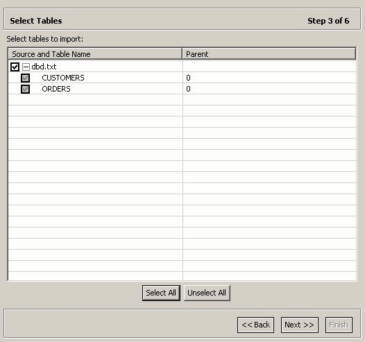

Click Next to go to the Select Tables task.
This section describes the steps required to select the tables from the COBOL Copybooks.
The following task continues the Apply Filters task.
From the Select Tables screen, select the tables that you want to access. To select all tables, click Select All. To clear all the selected tables, click Unselect All.
Figure 5-8 shows the Select Tables screen.
The import manager identifies the names of the segments in the DBD files that will be imported as tables.

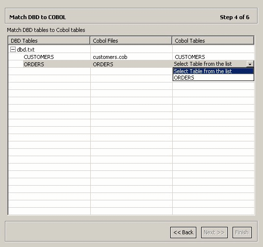

Click Next to continue to the Match DBD to COBOL task.
The Import Manipulation screen open.
This step lets you match the DBD file to your COBOL copybook. It is a continuation of the Select Tables task. Figure 5-9 shows the DBD to COBOL task that is displayed in the Editor.
Match each table selected from the DBD file with the COBOL copybook that contains the relevant table structure. Select the files and tables from the lists for each DBD entry.
Click Next to continue to the Manipulate the Imported Records task.

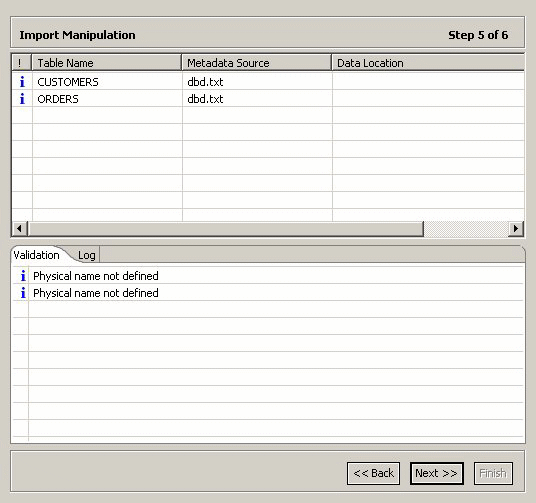

The Import Manipulation screen opens.
If required, you can now manipulate the imported records. This is an optional task.
This section describes the operations available for manipulating the imported records (tables). It continues the Select Tables task.
The import manager identifies the names of the records in the DDM Declaration files that will be imported as tables. You can manipulate the general table data in the Import Manipulation Screen.
Perform the following steps to manipulate the table metadata.
From the Import Manipulation screen (see Import Manipulation Screen figure), right-click the table record marked with a validation error, and select the relevant operation. See the table, Table Manipulation Options for the available operations.
Repeat step 1 for all table records marked with a validation error. You resolve the issues in the Import Manipulation Screen.
Once all the validation error issues have been resolved, the Import Manipulation screen is displayed with no error indicators.
Click Next to continue to the Select the Metadata Model task.
Figure 5-10 shows the Import Manipulation screen.
The upper area of the screen lists the DDM Declaration files and their validation status. The metadata source and location are also listed.
The Validation tab at the lower area of the screen displays information about what needs to be resolved in order to validate the tables and fields generated from the COBOL. The Log tab displays a log of what has been performed (such as renaming a table or specifying a data location).
The following operations are available in the Import Manipulation screen:
Resolving table names, where tables with the same name are generated from different files during the import.
Selecting the physical location for the data.
Selecting table attributes.
Manipulating the fields generated from the COBOL, as follows:
Merging sequential fields into one (for simple fields).
Resolving variants by either marking a selector field or specifying that only one case of the variant is relevant.
Adding, deleting, hiding, or renaming fields.
Changing a data type.
Setting the field size and scale.
Changing the order of the fields.
Setting a field as nullable.
Selecting a counter field for array for fields with dimensions (arrays). You can select the array counter field from a list of potential fields.
Setting column-wise normalization for fields with dimensions (arrays). You can create new fields instead of the array field where the number of generated fields will be determined by the array dimension.
Creating arrays and setting the array dimension.

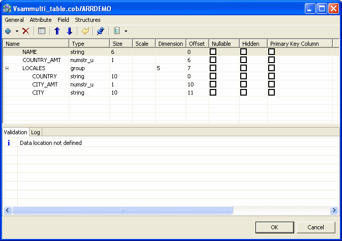

You can manipulate the data in the table fields in the Field Manipulation Screen. Double-click a line in the Import Manipulation Screen to open the Field Manipulation screen.
The Field Manipulation screen lets you make changes to fields in a selected table. You get to the Field Manipulation screen through the Import Manipulation Screen. Figure 5-11 shows the Field Manipulation screen.
The values displayed in the table on the Field Manipulation screen are calculated by the import process.
You can use the Primary Key Column column to define the primary key of the table and of the virtual views created for the table's arrays. When you select the Primary Key Column check box of array members, these columns form the primary key of the virtual view, together with the selected primary key columns of the parent.
You can carry out all of the available tasks in this screen through the menu or toolbar. You can also right click anywhere in the screen and select any of the options available in the main menus from a shortcut menu.
Table 2-3 describes the commands that are available in the Field Manipulation screen. If a toolbar button is available for a task, it is pictured in the table.
This screen allows you to generate virtual and sequential views for tables containing arrays. In addition, you can configure the properties of the generated views.

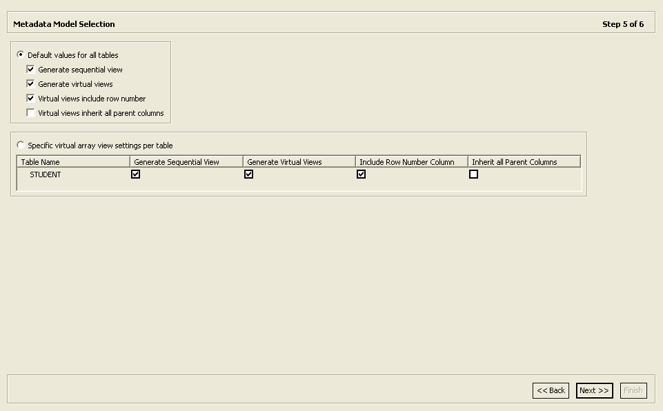

In the Metadata Model Selection screen, you can select default values that apply to all tables or set specific settings per table. This screen inherits its default settings from the settings that you defined for the virtual view policy when you configure the data source properties (see Configuring the IMS/DB DLI Data Source Properties, Configure the IMS/DB DBCTL Data Source Properties, or Configure the IMS/DB DBDC Data Source Properties).
Note: Selecting the Default values for all tables check box discards any table-specific settings that you set. |
Perform the following steps to select the metadata model.
Select from the following:
Default values for all tables: Select this option if you want to apply the same values to all tables to be imported.
Generate sequential view: Select this option if you want to map a non-relation file to a single table.
Generate virtual views: Select this option if you want to have an individual table created for every array in the non-relational file.
Virtual views include row number: Select this option if you want to include a column that specifies the row number in the virtual or sequential view.
Virtual views inherit all parent columns: Select this option if you want the virtual views to include all the columns of the parent record.
Specific virtual array view settings per table: Select this option if you want to apply different values to the tables to be imported. Then select the relevant check boxes.
Note: After importing a table, you can change these settings on the Modeling tab of the table editor. |
Click Next to continue to the Import the Metadata task.

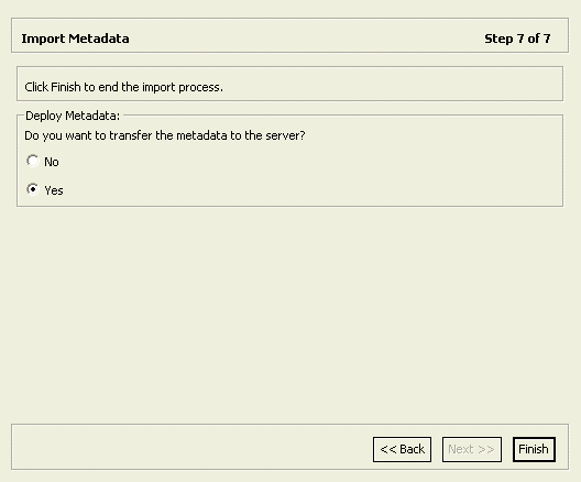

This section describes the steps required to import the metadata to the target computer. It continues the Select the Metadata Model step.
You can now import the metadata to the computer where the data source is located, or import it later (in case the target computer is not available).
Perform the following steps to transfer the metadata.
Select Yes to transfer the metadata to the target computer immediately or No to transfer the metadata later.
Click Finish.
Figure 5-13 shows the Import Metadata screen.
