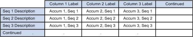

The following diagram shows how column numbers, sequences, and accumulator numbers appear on the printed payslip.
Columns and rows in the Pay Summary region of the payslip
