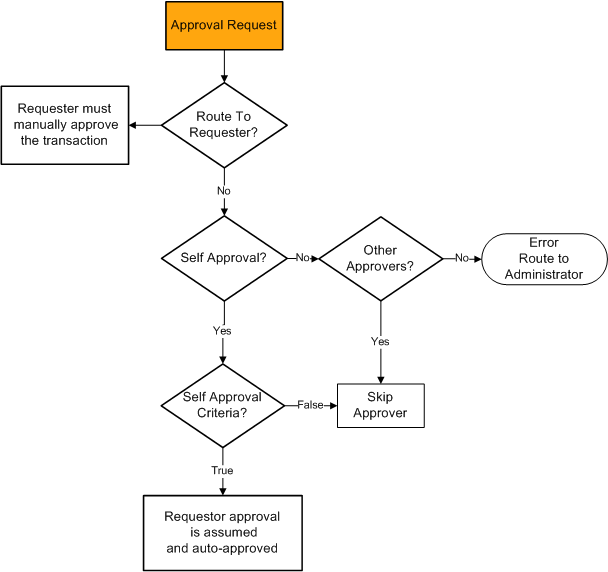

A requester can also be an approver. If requesters approve their own transactions, it's called self-approval. A check box setting enables self-approval. If enabled, the requester’s approval is assumed, and the process continues. However, you can establish criteria that helps control the requester's approval authority. For example, you can place a limit on the dollar amount for the requester so that if the transaction is over that amount, the requester is not used as an approver.
If self-approval is not enabled, then the requester must manually approve the transaction.
If self-approval is enabled, then the self-approval criteria must be specified. Then, if the requester appears as an approver, the criteria is evaluated. If the criteria are met, then the requester's approval is assumed and the minimum approvers for that step decrements by one.
When a requester is an approver, you can configure the path to skip the steps in that path prior to the requester's step.
Self-approval is configured at the step level.
Route to Requester
Route to requester is a feature that informs the system that an approval should be sent to a requester. In some cases the requester may already be listed in the approval path. The flow of this option is also dependant on the self-approval feature as displayed in this diagram:
Route to requester and self-approval feature flow
If route to requester is selected, the requester must always manually approve the transaction regardless of the self-approval setting.
Note. Even if the self-approval criteria is met, the requester must manually approve the transaction.
If the requester is the only approver and neither route to requester or self-approval are selected, the system will produce an error and route the transaction to the administrator
If there are enough other approvers in the path and neither route to requester or self-approval are selected, the requester approval is skipped.
If route to requester is not selected and self-approval is selected, the self-approval criteria is checked. If the requester meets the approval criteria, the approval is assumed and auto-approved. If the requester does not meet the approval criteria the requester approval is skipped.
