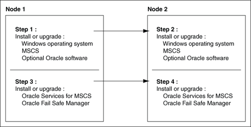

Although this guide describes the Oracle Fail Safe installation in detail, other products must also be installed to implement the Oracle Fail Safe environment. Figure 1-1 shows the recommended order for installing software on a two-node cluster
(The numbers in Figure 1-1 do not correspond to the numbered steps in the subsequent list because the list contains more detailed information than the figure.Figure 1-1 Recommended Order for Installing Software on a Two-Node Cluster
The following list provides more detail about the installation order and other tasks to help you get started with Oracle Fail Safe:
On each cluster node, install:
Microsoft Distributed Transaction Coordinator and correctly configure for a cluster environment.
See Oracle Fail Safe Release Notes for information about the versions of Microsoft Windows that can be used with Oracle Fail Safe. The Oracle Fail Safe Web site contains more information about installing Microsoft Cluster Server.
On each cluster node for each Oracle product that you intend to install, create an Oracle home on a private disk (for example, the system disk). To minimize downtime during future upgrades, Oracle recommends that you use a separate Oracle home for each major component (for example, a separate Oracle home each for the database, application software, and Oracle Fail Safe). To allow applications to fail over, ensure that the Oracle homes on each cluster node have the same name. For example, name the Oracle Fail Safe home on each cluster node ofs_home, and name the database home on each cluster node dbs_home.
On each cluster node, install the optional Oracle software (Oracle Database and other applications) that you plan to use with Oracle Fail Safe. Place all application and database data, control, and log files on shared cluster disks so that they can fail over.
If you are installing Oracle Database software, you can create the database before or after you install Oracle Fail Safe. Create the database as you would in a noncluster environment, including the database listener. However, the database must be created on a cluster disk or disks.
On each cluster node, install the server component of Oracle Fail Safe, Oracle Services for MSCS. If you want, you can install the client component, Oracle Fail Safe Manager, at the same time.
See Chapter 2 for complete information about installing Oracle Fail Safe.
On one or more client systems, optionally, install Oracle Fail Safe Manager (for example, to set up additional management consoles).
