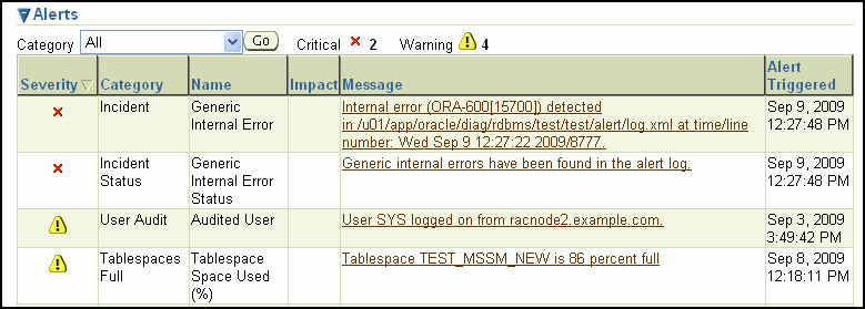

To view critical error alerts:
Go to the Database Home page in Enterprise Manager.
In the Alerts section, examine the table of alerts.
Critical error alerts are indicated by an X in the Severity column, and the text "Incident" in the Category column.
You may have to click the hide/show arrowhead icon next to the Alerts heading to display the alerts table.
(Optional) In the Category list, select Incident to view alerts of type Incident only.
In the Message column, click the message of the critical error alert to investigate.
An Incident detail or Data Failure page appears for the type of incident you selected. For example, if you clicked a message about an ORA-600 error, then the Incident - Generic Internal Error page appears.

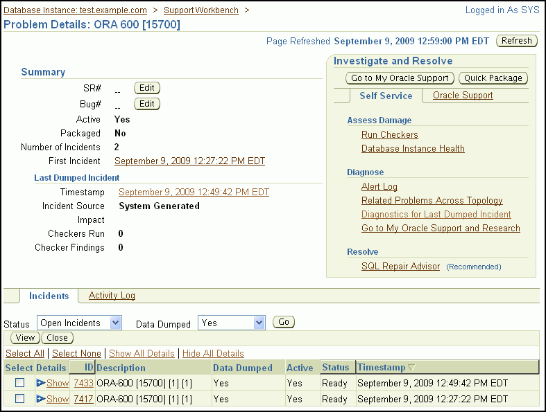

You continue your investigation with the Problem Details page.
To view problem details:
On the Incident detail or Data Failure page, click View Problem Details.
The Problem Details page appears, showing the Incidents subpage.
(Optional) To view incident details, in the Incidents subpage, select an incident, and then click View.
The Incident Details page appears, showing the Dump Files subpage.
(Optional) On the Incident Details page, select Checker Findings to view the Checker Findings subpage.
This page displays findings from any health checks that were automatically run when the critical error was detected.

To create a service request:
On the Problem Details page, in the Investigate and Resolve section, click Go to My Oracle Support.
Tip:
If you followed the steps described in Task 2, then from the Incident Details page, click Problem Details in the breadcrumb to return to the Problem Details page.
The My Oracle Support Login and Registration page appears in a new browser window.
Log in to My Oracle Support and create a service request in the usual manner.
(Optional) Remember the service request number (SR#) for the next step.
(Optional) Return to the Problem Details page, and then do the following:
In the Summary section, click the Edit button that is adjacent to the SR# label.
In the page that opens, enter the SR#, and then click OK.
The SR# is recorded in the Problem Details page. This is for your reference only.

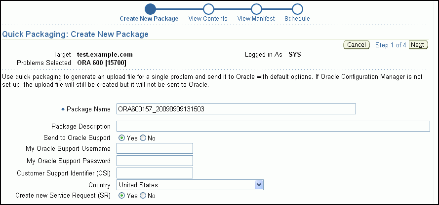

For this task, you use the quick packaging process of the Support Workbench to package and upload the diagnostic information for the problem to Oracle Support Services. Quick packaging has a minimum of steps, organized in a guided workflow (a wizard). The wizard assists you with creating an incident package (referred to as a package) for a single problem, creating a ZIP file from the package, and uploading the file. With quick packaging, you are not able to edit or otherwise customize the diagnostic information that is uploaded. Using quick packaging is the direct, straightforward method to package and upload diagnostic data.
To edit or remove sensitive data from the diagnostic information, enclose additional user files (such as application configuration files or scripts), or perform other customizations before uploading, you must use the custom packaging process. See Oracle Database Administrator's Guide for instructions. When you complete those instructions, you may continue with Task 5 – Track the Service Request and Implement Any Repairs.
The Support Workbench uses Oracle Configuration Manager to upload the diagnostic data. If Oracle Configuration Manager is not installed or properly configured, then the upload may fail. In this case, a message is displayed with a request that you upload the file to Oracle Support manually. You can upload files manually with My Oracle Support.For more information about Oracle Configuration Manager, see Oracle Configuration Manager Installation and Administration Guide.
To package and upload diagnostic data to Oracle Support:
On the Problem Details page, in the Investigate and Resolve section, click Quick Package.
The Create New Package page of the Quick Packaging wizard appears.
(Optional) Enter a package name and description.
Fill in the remaining fields on the page. If you have created a service request for this problem, then select the No option button for Create new Service Request (SR).
If you select the Yes option button for Create new Service Request (SR), then the Quick Packaging wizard creates a draft service request on your behalf. You must later log in to My Oracle Support and fill in the details of the service request.
Click Next.
The Quick Packaging wizard displays a page indicating that it is processing the command to create a new package. When it finished, the Quick Packaging: View Contents page is displayed.
Review the contents on the page, making note of the size of the created package, then click Next.

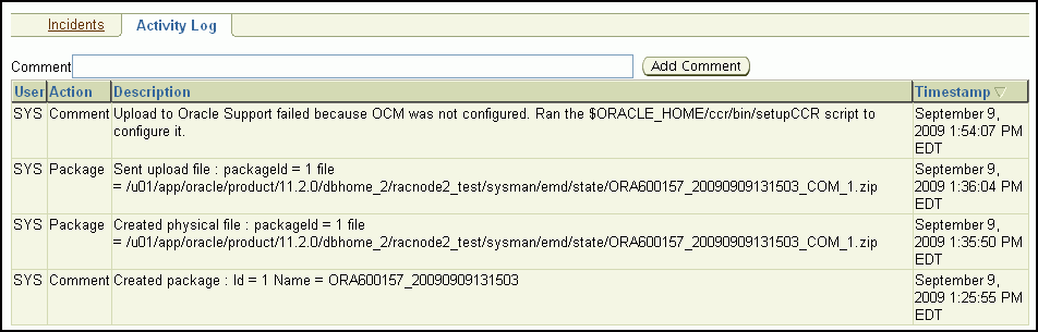

Adding comments to the problem activity log.
You may want to share problem status or history information with other DBAs in your organization. For example, you could record the results of your conversations with Oracle Support.
To add comments to the problem activity log:
Go to the Problem Details page for the problem, as described in "Viewing Problems Using the Enterprise Manager Support Workbench".
Click Activity Log to display the Activity Log subpage.
In the Comment field, enter a comment, and then click Add Comment.
Your comment is recorded in the activity log.
