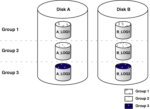

Every Oracle database has a set of two or more online redo log files. The set of online redo log files is collectively known as the redo log for the database. A redo log is made up of redo entries, which are also called redo records.
The online redo log stores a copy of the changes made to data. If a failure requires a data file to be restored from backup, then the recent data changes that are missing from the restored data file can be obtained from the online redo log files, so work is never lost. The online redo log files are used to recover a database after hardware, software, or media failure. To protect against a failure involving the online redo log file itself, Oracle Database can multiplex the online redo log file so that two or more identical copies of the online redo log file can be maintained on different disks.
The online redo log for a database consists of groups of online redo log files. A group consists of an online redo log file and its multiplexed copies. Each identical copy is considered to be a member of that group. Each group is defined by a number, such as Group 1.
Figure 6-3 shows the configuration of a database that has three online redo log groups and two members in each group. For each group, the members are stored on separate disks for maximum availability. For example, the members of Group 1 are the redo log files A_LOG1 and B_LOG1.
Figure 6-3 Online Redo Log Groups and Their Members
The database log writer process (LGWR) writes redo records from the memory buffer to a redo log group until the log files in that group reach their storage size limit, or until you request a log switch operation. The LGWR process then writes to the next log group. The LGWR process performs this action in a circular fashion so that the oldest group is overwritten by the most recent redo records.

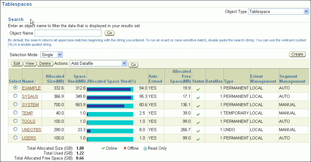

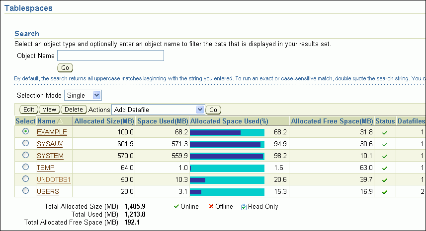

You use Database Control to view configuration, size, and status information about tablespaces.
To view tablespace information:
Go to the Database Home page.
At the top of the page, click Server to view the Server subpage.
In the Storage section, click Tablespaces.
The Tablespaces page appears.

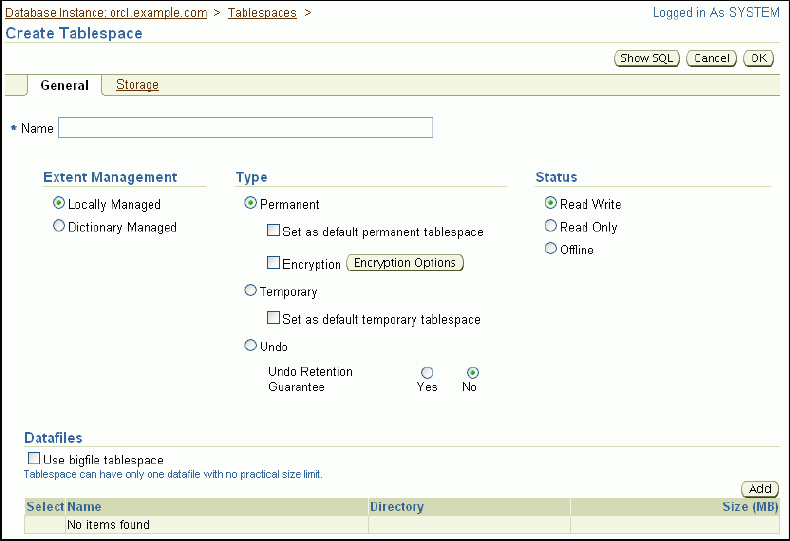

To create a tablespace:
Do one of the following:
To create a new tablespace, click Create (not shown in the screenshot).
To create a tablespace that is similar to an existing tablespace, in the Select column, select the tablespace whose attributes you want to reproduce. In the Actions list, select Create Like and then click Go.
The Create Tablespace page appears, showing the General subpage.
In the Name field, enter a name for the tablespace.
In the Extent Management section, select Locally Managed.
In the Type section, select Permanent.
See "Tablespace Types".
In the Status section, select Read Write.
See "Tablespace Status".
In the Datafiles section, click Add to add one or more data files to the tablespace.
The Add Datafile page appears.
If you select Use bigfile tablespace, then the tablespace can have only one data file. Bigfile tablespaces are used with very large databases that use Automatic Storage Management or other logical volume managers that support striping, RAID, and dynamically extensible logical volumes.If the Storage Type is File System, then in the File Name field, enter a file name. In the File Directory and File Size fields, enter appropriate values for your data file location and initial size.
In the Storage section, complete the following steps:
Select Automatically extend data file when full (AUTOEXTEND).
Set a suitable increment, such as 10 MB.
This is the amount of disk space that is added to the data file when it needs more storage space.
For Maximum File Size, do one of the following, depending on available storage:
Select Unlimited to permit the file to increase without limits.
Select Value, and then enter a value in KB, MB, GB, or TB.
Click Continue.
The Create Tablespace page returns.
(Optional) Toward the top of the page, click Storage to view the Storage subpage. Examine all of the default settings on this subpage.
See the online Help for more information about these settings.
Click OK to add the tablespace.
The Tablespaces page returns, showing the newly created tablespace.

This section explains how to set a tablespace to automatically extend when it reaches its size limit. The following instructions assume that the tablespace was previously not an autoextending tablespace.
To set a tablespace to automatically extend:
See Figure 6-4.
Select the tablespace for which you want to enable autoextend, and then click Edit.
The Edit Tablespace page appears.
Select the first data file associated with the tablespace, and then click Edit.

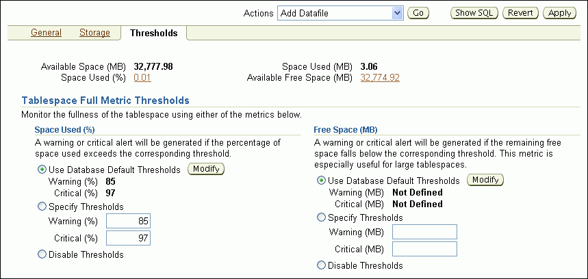

You receive an alert in Database Control when a space usage threshold for a tablespace is reached. There are two types of space usage alerts that you can enable: warning, for when tablespace space is somewhat low, and critical, for when the tablespace is almost completely full and action must be taken immediately.
For both warning and critical alerts, you can specify alert thresholds in the following ways:
By space used (%)
When space used becomes greater than or equal to a percentage of total space, an alert is issued.
By free space (MB)
When remaining space falls below an amount (in MB), an alert is issued.
Free-space thresholds are more useful for large tablespaces. For example, for a 10 TB tablespace, setting the percentage full critical alert to as high as 99 percent means that the database would issue an alert when there is still 100 GB of free space remaining. Usually, 100 GB remaining would not be a critical situation, and the alert would not be useful. For this tablespace, it might be better to use a free-space threshold, which you could set to issue a critical alert when 5 GB of free space remains.
For both warning and critical alerts for a tablespace, you can enable either the space used threshold or the free-space threshold, or you can enable both thresholds.
To change space usage alert thresholds for tablespaces:
See Figure 6-4.
Select the tablespace whose threshold you want to change, and then click Edit.
The Edit Tablespace page appears, showing the General subpage.
Click the Thresholds link at the top of the page to display the Thresholds subpage.
In the Space Used (%) section, do one of the following:
Accept the default thresholds.
Select Specify Thresholds, and then enter a Warning (%) threshold and a Critical (%) threshold.
Select Disable Thresholds to disable the percentage full thresholds.
In the Free Space (MB) section, do one of the following:
Select Specify Thresholds, and then enter a Warning (MB) threshold and a Critical (MB) threshold.
Select Disable Thresholds to disable the threshold for free space remaining.
Click Apply.

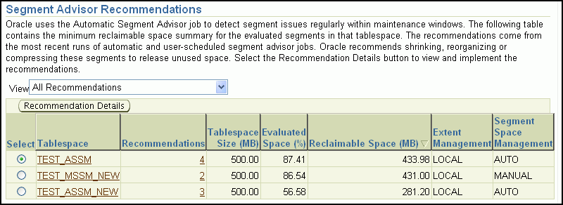

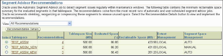

Segment Advisor recommendations are grouped by tablespace. Only tablespace names appear on the Segment Advisor Recommendations page in Database Control.
If a tablespace contains any segments for which a shrink operation or reorganization is recommended, then the tablespace appears on the Segment Advisor Recommendations page. This page estimates the amount of reclaimable space for each tablespace. If you request recommendation details for a tablespace, then Database Control displays the segments in that tablespace for which recommendations were generated.
See Figure 6-6 and Figure 6-7.

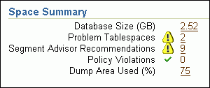

In the Space Summary section, click the numeric link adjacent to Segment Advisor Recommendations.
Figure 6-5 Home Page Space Summary Section
The Segment Advisor Recommendations page appears, showing recommendations from the most recent automatic and manual runs of the Segment Advisor.
Figure 6-6 Segment Advisor Recommendations Page
(Optional) In the View list, select Recommendations for Last Automatic Run to view recommendations from only the most recent automatic run of the Segment Advisor.

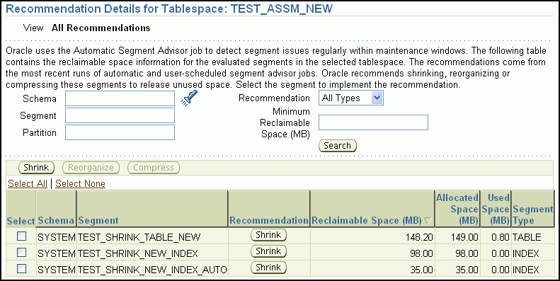

Select a tablespace, and then click Recommendation Details.
The Recommendation Details for Tablespace page appears.
This page lists the tablespace segments for which online segment shrink or reorganization is recommended.
Figure 6-7 Recommendation Details for Tablespace Page
(Optional) Reduce the number of segments displayed in the segment list by entering search criteria in the Schema, Segment, Partition, or Minimum Reclaimable Space fields, and then clicking Search.
Examine the recommendation for each segment, and then proceed as follows:
If the recommendation for any segments is to reorganize, then start reorganization for those segments by clicking the Reorganize button, or select multiple segments and then click the Reorganize button above the table. Follow the directions in the succeeding pages to generate a reorganization script for the selected segments.
If the recommendation for any segments is to shrink, then proceed with Step 7 through Step 13 for those segments.
Do one of the following to select one or more segments to shrink:
To reclaim space in a single segment, click Shrink under the Recommendation column for that segment.
To shrink one or more segments, select the segments, and then click the Shrink button above the table.
On the Shrink Segment: Options page, accept Compact Segments and Release Space.
This option returns freed space to the tablespace. If you do not want to release the freed space to the tablespace, then choose Compact Segments. You can rerun the shrink process later to release the freed space.
Choose Compact Segments if you believe that you may have long-running queries currently in operation that involve the segments being shrunk. Long-running queries that were started before the shrink operation completes might attempt to read from blocks that have been reclaimed, which results in an error. Alternatively, you can schedule the shrink operation for an off-peak period in Step 10.Click Implement.

Oracle recommends that you multiplex the online redo log. Multiplexing provides better protection for data if an instance or media failure occurs.
To multiplex your online redo log, you must add members to each online redo log group. It is not required that online redo log groups be symmetrical, but Oracle recommends that your groups all have the same number of members. A database must have a minimum of two online redo log groups.
When you multiplex the online redo log, the database must increase the amount of I/O that it performs. Depending on your configuration, this action may affect overall database performance.To multiplex the online redo log:
In the Storage section, click Redo Log Groups.
The Redo Log Groups page appears.
Select a group and click Edit.
The Edit Redo Log Group page appears.
Click Add.
The Add Redo Log Member page appears.
If the Storage Type is set to File System, then in the File Name field, enter a file name for the new redo log member.
For example, if your existing member file name is REDO01.log, then you might name this member REDO01a.log.
In the File Directory field, enter the directory where you want the data file to be stored on disk.
You can create this file in the same directory as the other member of the redo log file group, but it is recommended that you store members on separate disk drives. That way, if there is a drive failure, then you still have access to one member.
Click Continue, and then click Apply to accept your changes.
A confirmation message appears.
At the top of the page, click the Redo Log Groups link to return to the Redo Log Groups page.

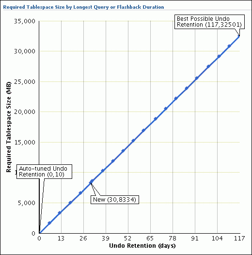

Although by default Oracle Database manages undo data and the undo tablespace automatically, if your installation uses Oracle Flashback features, then you may have to perform some undo management tasks to ensure the success of these operations.
Oracle Flashback operations resulting in snapshot too old errors indicate that you must intervene to ensure that sufficient undo data is retained to support these operations.
The following methods better support Oracle Flashback operations:
Set the minimum undo retention period for the autoextending tablespace to be as long as the longest expected Oracle Flashback operation.
You achieve this goal by setting the UNDO_RETENTION initialization parameter. See Oracle Database Administrator's Guide for details.
Change the undo tablespace to a fixed size.
For an autoextending undo tablespace, Oracle Database always automatically tunes the undo retention period to be slightly longer than the longest-running active query. However, this autotuned retention period may be insufficient to accommodate Oracle Flashback operations. If the undo tablespace has autoextending disabled, or has a fixed size, then Oracle Database uses a different method for tuning the undo retention period to better accommodate Oracle Flashback operations.
To change the undo tablespace to a fixed size, you must choose a tablespace size that is sufficiently large. If you choose an undo tablespace size that is too small, then the following errors could occur:
DML could fail because there is not enough space to accommodate undo data for new transactions.
Long-running queries could fail with a snapshot too old error, which means that there was insufficient undo data for read consistency.

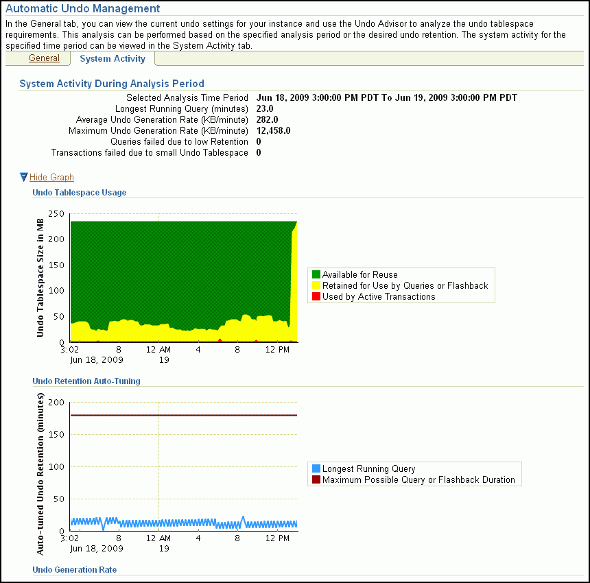

Oracle Enterprise Manager Database Control (Database Control) includes an Undo Advisor to help you determine the minimum size for the fixed size of the undo tablespace. See "Computing the Minimum Undo Tablespace Size Using the Undo Advisor".
You can use the Automatic Undo Management page to view the following information about your undo configuration:
Name and current size of the undo tablespace
Autoextend tablespace setting (Yes or No)
Current autotuned undo retention period
To view undo information:
In the Database Configuration section, click Automatic Undo Management.
The Automatic Undo Management page appears.

Go to the Automatic Undo Management page.
Decide whether you want to compute the minimum size of the undo tablespace based on statistics gathered over a designated time period (such as the last 7 days), or based on an undo retention period of a duration that you choose.
The automatically gathered statistics include the duration of the longest-running query and the undo generation rate. Computing the minimum undo tablespace size based on these statistics is advisable if you do not use Oracle Flashback features or if you do not expect future long-running queries to exceed the duration of previous long-running queries.
If you prefer to choose and enter the duration of a desired undo retention period, then the duration must be based on your expectations of the duration of future long-running queries or Oracle Flashback operations.
To compute the minimum undo tablespace size based on statistics gathered over a period, complete the following steps:
In the Analysis Period section, in the Analysis Time Period list, select the desired analysis time period.
If you select Customize Time Period, then a page appears that enables you to enter the starting and ending date and time for the period.
Select Automatically chosen based on longest query in analysis period.
Click Run Analysis.
The minimum required undo tablespace size is displayed in the Analysis Results section.
(Optional) Click Show Graph to view a graph of the analysis results.
To compute the minimum undo tablespace size based on a duration that you enter, complete the following steps:
In the Analysis Period section, select Specified manually to allow for longer duration queries or flashback.
In the Duration field, enter the desired duration of the undo retention period in seconds, minutes, hours or days.
You may compute this duration as follows:
Determine the duration of the expected longest-running query for your workload.
You can base your determination on the longest-running query recorded during a previous workload period. This information is available from the System Activity subpage of the Automatic Undo Management page. You choose the analysis period for this subpage by selecting from the Analysis Time Period list on the General subpage. You can choose a custom analysis period that corresponds to your typical workload period.
Determine the longest duration that is expected for an Oracle Flashback operation.
Take the maximum of these two durations.
In the Analysis Period section of the General subpage, click Run Analysis.
(Optional) Click the tick-mark, or point, on the curve that corresponds to the desired undo retention period.
The Duration field changes to match the selected undo retention period, and the Minimum Required Undo Tablespace Size field above the graph changes to reflect the matching required size.
(Optional) Click Apply.
The minimum undo retention period is set to the value of the Duration field.
Running an analysis or setting the minimum undo retention with the Undo Advisor does not change the size of the undo tablespace. You must follow the instructions in "Changing the Undo Tablespace to a Fixed Size" to change the size of the undo tablespace.See Also:
