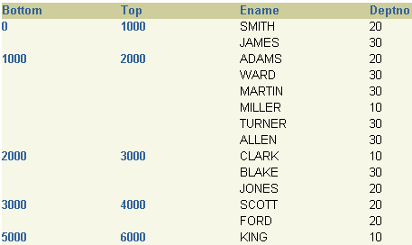

On the Template page, select Predefined Template and click Beige, then click Finish to display your report output in the Paper Design view. It should look something like this:
Figure 30-2 Paper Design view for the aggregating data report
In the Paper Design view, click the text Bottom and change the text to Salary Range.
Delete the text Top.
Note: You can also modify the other column headers to make the text more meaningful. |
