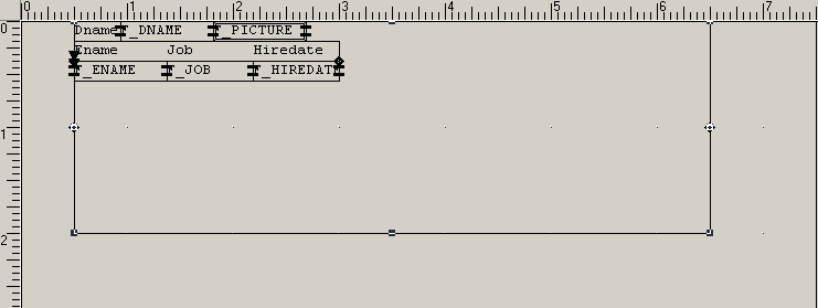

Now that you have created an initial layout for your report, you can rearrange your layout objects and add dynamic graphics.
To modify your layout:
In the Paper Layout view, select all the objects by pressing Ctrl+A on your keyboard.
Use the arrow keys on your keyboard to move all the objects 0.5 inches (1.5 centimeters) to the right.
In the Paper Layout view, expand the screen so that you can see down to 7 inches (18 centimeters) on the ruler.
In the Object Navigator, find your report name, then navigate to Paper Layout > Main Section > Body > M_G_DEPTNO_GRPFR.
Click R_G_DEPTNO. In the Paper Layout view, the R_G_DEPTNO repeating frame should also be selected.
While the R_G_DEPTNO repeating frame is selected, click the right part of the frame, and drag it to 6.5 inches (16.5 centimeters). The repeating frame should now expand from the 3.0 inch (7.5 centimeter) mark to the 6.5 inch (16.5 centimeter) mark on the top ruler.
Now, click the bottom part of the frame, and drag it to 2.0 inches (5 centimeters). You can see where you are by looking at the left-hand ruler. The repeating frame should now expand from the 0.5 inch (1.3 centimeter) mark to the 2.0 inch (5 centimeter) mark on the left-hand ruler.
Figure 24-4 Paper Layout view of the modified layout
Click the Flex Off button in the toolbar.
Move the Picture field to the right, and enlarge it to about 1.5 by 1.5 inches (4 by 4 centimeters).
In the Object Navigator, navigate to Paper Layout > Main Section > Body, then select the M_G_DEPTNO_GRPFR frame.
In the Paper Layout view, click the right edge of the frame and drag it to the right to include the Picture field.
Do the same for the R_G_DEPTNO repeating frame.
While R_G_DEPTNO is selected, choose Tools > Property Inspector to display the Property Inspector.
Under Repeating Frame, set the Maximum Records per Page property to 1
Note: By setting the maximum records per page to 1, only one state will display per page in your report. |
