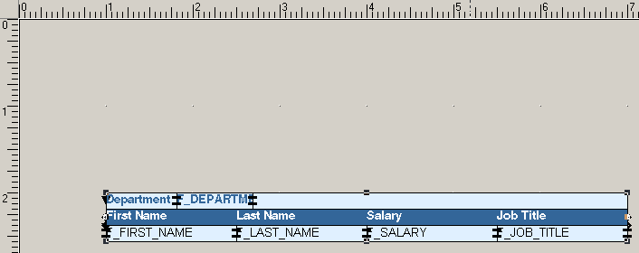

Click the Paper Layout view button in the toolbar to display the Paper Layout view.
Make sure the Confine On button in the toolbar is set to Confine mode on. Doing so enables you to move the objects in the Paper Layout view around the canvas.
In the Object Navigator, under Paper Layout > Main Section > Body, click the item M_G_DEPARTMENT_ID_GRPFR.
Notice that, in the Paper Layout view, the outermost frame is selected.
Using the arrow keys, move the frame about 2 inches (5 centimeters) down and 1 inch (2.5 centimeters) to the right.
You can use the rulers along the sides of the Paper Layout view as guidance. Your Paper Layout should now look something like this:
Figure 18-3 Paper Layout View of Adjusted Report Layout

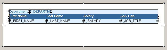

Make space for the border you will create that will surround each record. In the Object Navigator, select M_G_DEPARTMENT_ID_GRPFR again.
Drag each corner to make space around the inner repeating frame, so that the layout now looks like the following image. Notice the white space around the groups.
Figure 18-4 Paper Layout View with Expanded Repeating Frame

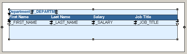

Now, let us make space between each record so that we can later put a horizontal line between the records. In the Object Navigator, click R_G_DEPARTMENT_ID.
In the Paper Layout view, click the bottom right corner and drag it down about 0.5 inches (1.5 centimeters) so that your layout now looks like this:
Figure 18-5 Paper Layout View with Expanded R_G_DEPARTMENT_ID Repeating Frame

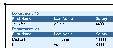

In the Paper Layout view, you can also change the font and style of the text. The steps in this section will show you how to modify the Department Number text.
To change the font:
In the Paper Design view, click the Paper Layout button in the toolbar.
In the Object Navigator, select the B_DEPARTMENT_ID and F_DEPARTMENT_ID fields so that you can change the font of the Department ID label and text.
Note: B_DEPARTMENT_ID refers to the boilerplate text "Department ID", which serves as the label for the F_DEPARTMENT_ID field. |
Click the title bar of Paper Layout view to make it the active window.
While the two fields are selected, choose Format > Font.
In the Font dialog box, choose a different font and size. In the example, we chose Times New Roman and 12 pt.
When you have finished your changes, click OK.
Note: Depending on the font and font size you choose, you may have to adjust the size of the fields to accommodate the text. In the example, since the font was increased, we selected the boilerplate text field and enlarged it. |
Display your report in the Paper Design view to see what it looks like. Here's an example:
Figure 18-7 Paper Design View of the Report with New Fonts
Save your report as graphics_your_initials.rdf.

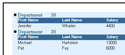

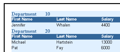

The steps in this section will show you how to add bullets so that a bullet displays next to each department ID.
To add bullets to your report:
In the Paper Layout view, make sure you have enough space next to the B_DEPARTMENT_ID field where you can add a bullet. The bullet needs to be within the R_G_DEPARTMENT_ID repeating frame so that it displays for each record.
Click the Ellipse tool in the tool palette.
Press the SHIFT key, then draw an ellipse next to the boilerplate text "Department."
Note: Pressing the SHIFT key while you draw the ellipse puts the tool in a "constrained" mode. When you create an ellipse in this mode, you can create a circle. Other tools are similar; for example, constraining the Rectangle tool creates a square. For more information on using these tools, refer to the Oracle Reports online Help. |
You should now see a circle in the repeating frame. To make the bullet a solid color, select the circle, then click the Fill Color tool in the tool palette.
In the color palette that displays, choose black.
Run your report to the Paper Design view to see what it looks like.
Note: When you are checking your layout, make sure that the ellipse displays within the R_G_DEPARTMENT_ID repeating frame. |
Figure 18-8 Paper Design View of the Report with Bullets

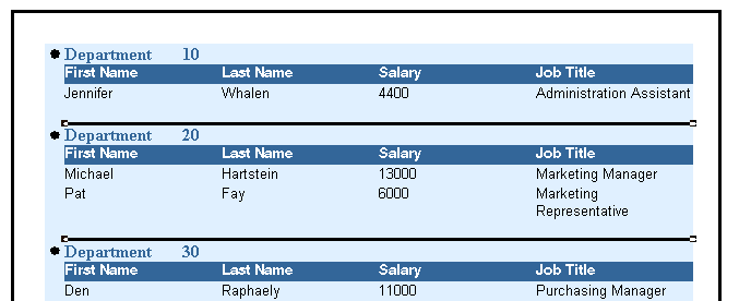

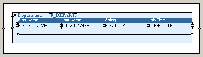

When you have a lot of data, you sometimes want to further distinguish each record, so that it is clear how the information is related. In this section, you will add a horizontal line to the layout that will display between each department record.
To add a line separator:
In the Paper Layout view, click the Line tool in the tool palette.
Press the SHIFT key, then draw a line in the R_G_DEPARTMENT_ID frame beneath the fields, like this:
Figure 18-9 Paper Layout View with Line Separator
Format the line the way you want it to appear. In our example, we chose Format > Line > Line Width > 2 pt. Then, we changed the color to black.
Run your report to the Paper Design view. It should now look something like this:
Figure 18-10 Paper Design View of Report with Line Separator
