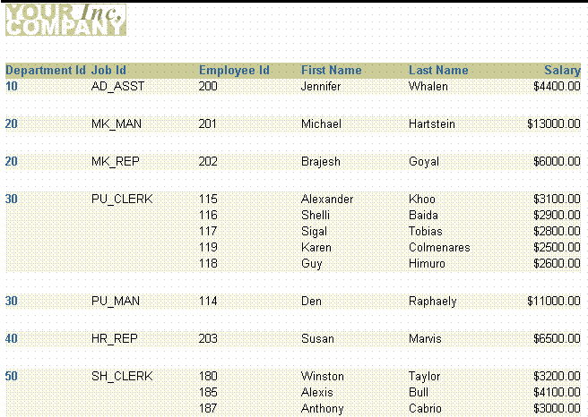

Figure 10-8 Group left report output with two break columns
The report above looks similar to the group left report you built in Section 10.2, "Group Report with One Break Column". However, notice that DEPARTMENT_ID values sometimes print more frequently than they did in the previous report. The DEPARTMENT_ID value repeats for each unique value of JOB_ID within the department. This behavior occurs because DEPARTMENT_ID is now grouped with JOB_ID and must print with JOB_ID. While DEPARTMENT_ID values may repeat several times, not until the position of PU_CLERK in department 30 does a job repeat, and not until that point can the break group actually break.

To see a sample group left report with two break columns, open the examples folder named break, then open the Oracle Reports example named grp2col_lft1.rdf. For details on how to access it, see "Accessing the Example Reports" in the Preface.

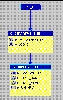

The first task in changing your previous report is to modify the data model by placing an additional column in the break group.
To add a column to the break group:
Open the report you created in the previous section.
In the Object Navigator, double-click the view icon next to the Data Model node to display the Data Model view.
In the Data Model view, click the break group, G_DEPARTMENT_ID, then click and drag the handle on the bottom center of the G_DEPARTMENT_ID group box down about 0.25 inches (0.5 centimeters) to resize it.
Click and drag the JOB_ID column in the G_EMPLOYEE_ID group and move it into the G_DEPARTMENT_ID group, underneath the DEPARTMENT_ID column.
Figure 10-9 Data model with two break columns

Click Finish. Notice the changes to the output in the Paper Design view. Also note how the formatting of the Salary field and the additional spacing between records is retained. When possible, Reports Builder will retain your manual modifications between uses of the Report Wizard.
