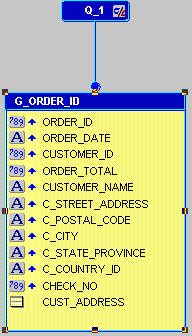

In the Object Navigator, under your report name, double-click the view icon next to the Data Model node to display the Data Model view.
Your data model should look like this:
Resize the G_ORDER_ID box by clicking at the top, then dragging the bottom center resize handle downwards. Your data model should now look something like this:

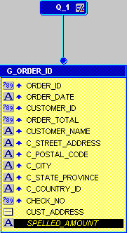

Your new formula column, called SPELLED_AMOUNT, now displays in the data model.
Figure 31-7 Data Model with SPELLED_AMOUNT formula column
