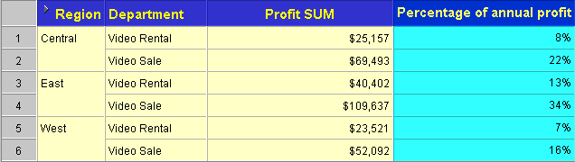

Percentages are worksheet items that enable you to quickly and easily calculate percentages of rows and columns. For example, to calculate monthly profit figures as a percentage of the annual profit figure.
The figure below shows a worksheet containing a percentage item called 'Percentage of annual profit'. From this column you can see that the Video Rental department in the Central region contributed 8% of the annual profit total (that is, $25,157).

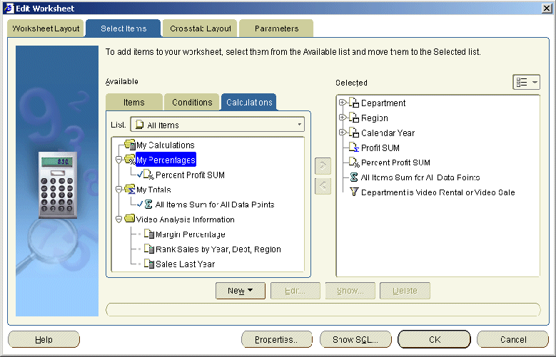

To display or hide a percentage:
Display the worksheet you want to analyze.
Choose Tools | Percentages to display the "Edit Worksheet dialog: Select Items tab: Calculations tab".
The Calculations tab lists existing calculations, percentages, and totals available in the worksheet. Active percentages are marked with a checkmark in the Available list and are also displayed in the Selected list.
To display an existing percentage, move the percentage from the Available list to the Selected list.
To hide an existing percentage, move the percentage from the Selected list to the Available list.
Click OK to close the Calculations tab and display the worksheet.
Discoverer refreshes the worksheet according to the options selected.

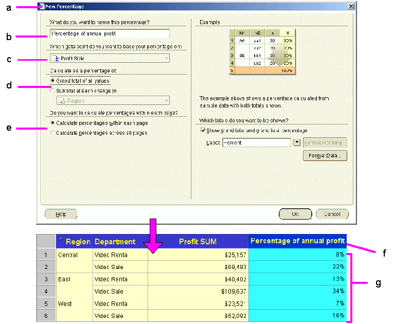

Click New and select New Percentage from the drop down list to display the "New Percentage dialog".
(optional) To change the default name of the new percentage, enter the name in the What do you want to name this percentage? field.
Use the Which data point do you want to base your percentage on? drop down list to specify which item to create a percentage for.
The drop down list displays numeric items currently displayed on the worksheet. If there is only one numeric item on the worksheet, this item is selected by default.

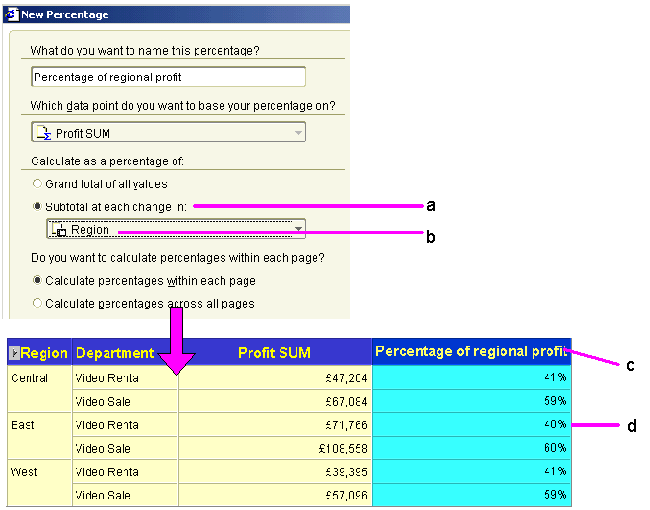

Use the Calculate as a percentage of options to choose where to display the percentage, as follows:
Select the Grand total of all values option to calculate the values as a percentage of the whole column.
Select the Subtotal at each change in option, then choose the item on which to group the data from the drop down list below.
For example, if the worksheet data is grouped by region, select region here to calculate a percentage sub-total for each region.
Use the Do you want to calculate percentages within each page? options to choose whether to calculate percentages for each page, or for all pages.
Use the Which totals do you want to be shown? check boxes to specify how to display grand totals and subtotals.
The options available depend on whether you have selected the Grand total of all values option, or the Subtotal at each change in option.
(optional) If you selected the Grand total of all values option, select the Show grand total and grand total percentage check box to calculate total values at the bottom of the worksheet.
You can also specify a label for the total, and click Format Heading and Format Data to specify how it looks on the worksheet.
(optional) If you selected the Subtotal at each change in option, select the Show subtotal and subtotal percentage check box to calculate subtotal values for each data sub-group.
(optional) If you selected the Subtotal at each change in option, select the Show the percentage of the grand total for each subtotal option to display the sub-group total as a percentage of the total value for all groups.
Click OK to save the details and display the Percentages dialog.
Click OK to close the Calculations tab and return to the worksheet.
Discoverer calculates the percentages and displays them on the worksheet.

Example 1: This example shows how to use the New Percentage dialog to create a percentage, and how the percentage is displayed on a worksheet. In the figure below, you calculate the profit sum for each region and department as a percentage of total profit.
Example 2: This example shows how to use the Edit Percentage dialog to produce percentage subtotals. In the figure below, you calculate a subtotal percentage value for each region. In other words, what percentage of profit does each department contribute to the region total.
