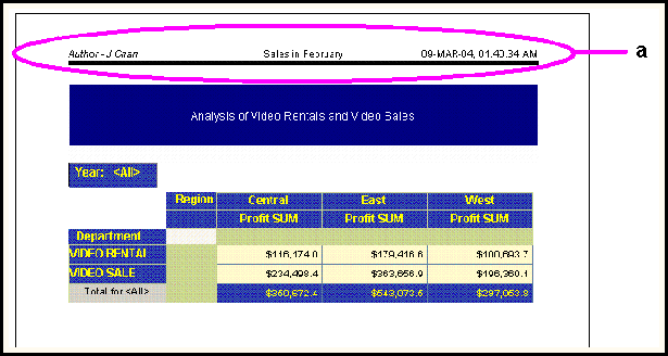

Page Setup options are worksheet settings that affect how a worksheet prints out. For example:

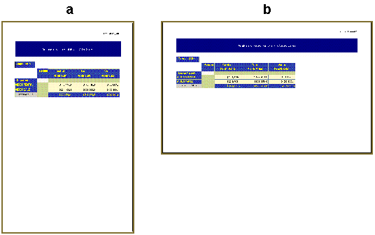

The Orientation setting (that is, Portrait or Landscape) determines the position of the worksheet relative to the printed page. The example below shows the same worksheet printed with a portrait orientation and a landscape orientation.
The Header settings enable you to add a header to the top of a printed worksheet. The example below shows a worksheet containing a header that is on the printed page but is not displayed on-screen in Discoverer Plus Relational. In this example, the header contains the name of the worksheet author, the worksheet title, the date and time, and a separating line.

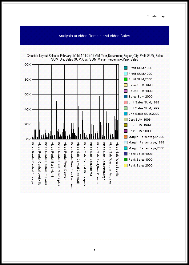

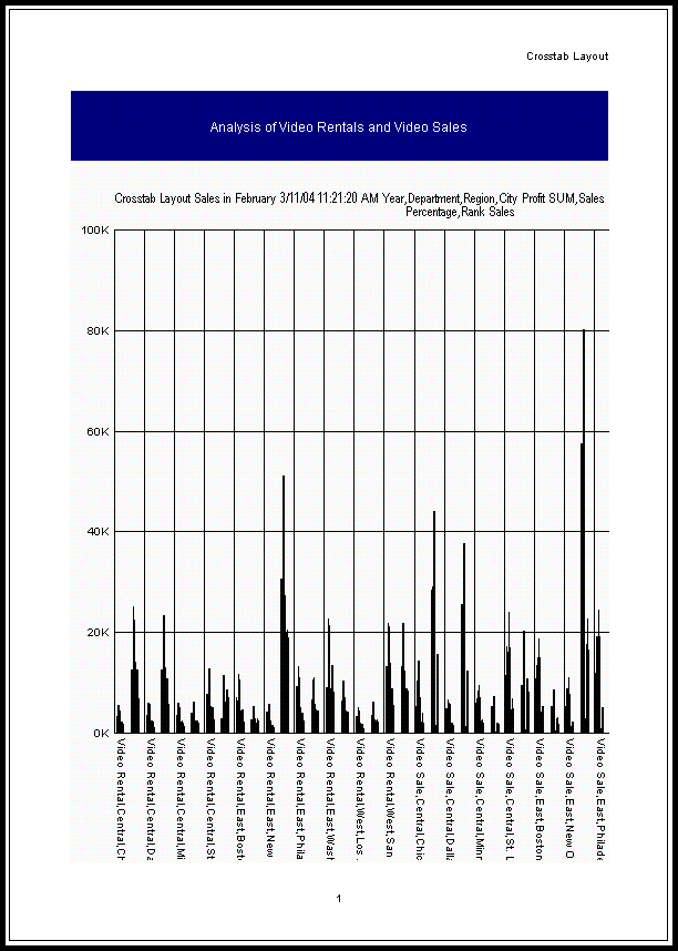

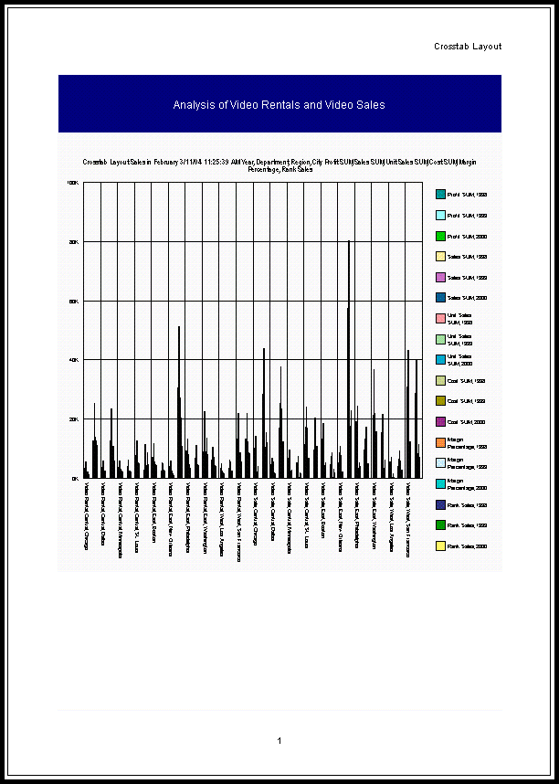

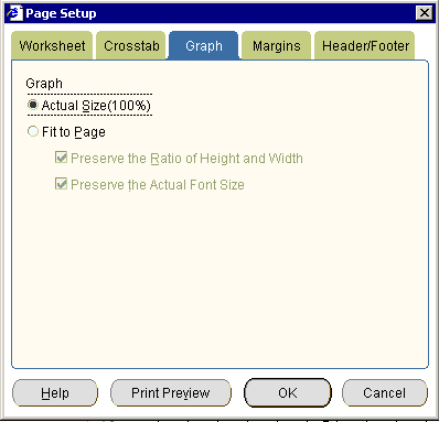

Page Setup options for graphs enable you to print a Discoverer graph in exactly the size you want. You set Page Setup options for a graph using the "Page Setup dialog: Graph tab".

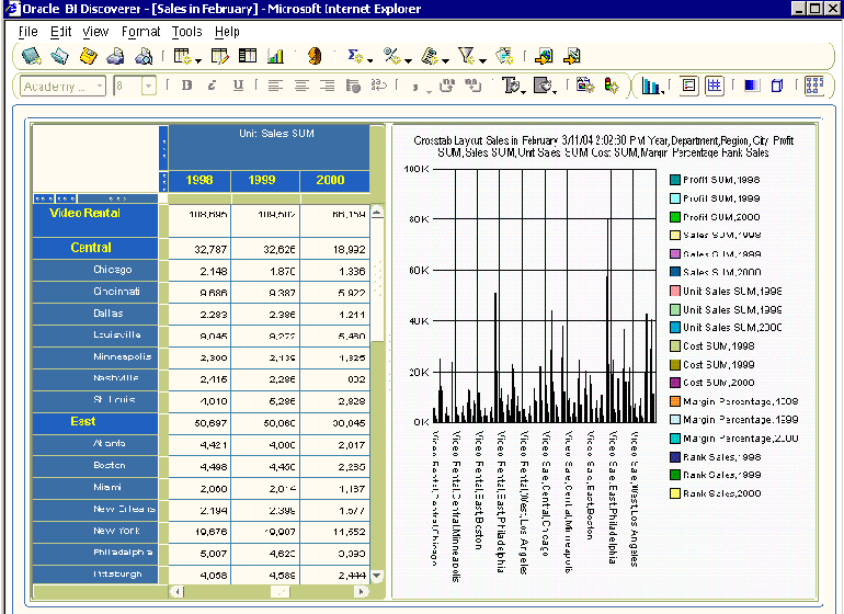

For example, you might have a large graph displayed on screen (see screenshot below).
If you select the Actual size check box on the "Page Setup dialog: Graph tab" and print the graph, Discoverer crops the graph. In the screenshot below you can see that Discoverer crops the graph legend from the right hand side.
If you select the Fit to page check box on the "Page Setup dialog: Graph tab" and print the graph, Discoverer prints the whole graph (see screenshot below).
If you select the Fit to page check box with Preserve the Ratio of Height and Width selected on the "Page Setup dialog: Graph tab" and print the graph, Discoverer maintains the graph proportions (see screenshot below).
If you select the Fit to page check box with Preserve the Ratio of Height and Width selected and Preserve the Actual Font Size selected on the "Page Setup dialog: Graph tab" and print the graph, Discoverer maintains the graph proportions and original font size (see screenshot below).

Use the "Page Setup dialog: Graph tab" to select how to print worksheet graphs.

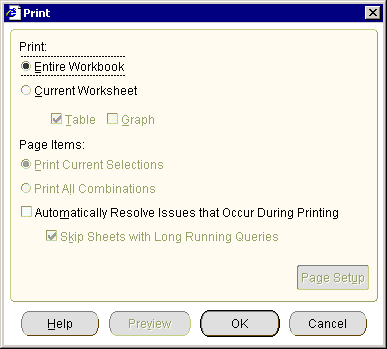

You print a Discoverer workbook when you want to print all worksheets in a workbook. When you print a workbook, you print all worksheet data and graphs based on Page Setup options selected for the individual worksheets (for more information, see "What are Page Setup options").
Note: If you want different print settings for individual worksheets, change the Page Setup options for each worksheet before you print the workbook (for more information, see "How to change Page Setup options for a worksheet").
If worksheets contain active parameters, Discoverer prompts you to enter parameter values to refine the data that you print.
To print a Discoverer workbook:
Open the workbook you want to print.
Choose File | Print to display the "Print dialog".
Select the Entire Workbook option.
Note: The Page Setup and Preview buttons and other options are grayed out when you print a workbook.
Click OK.

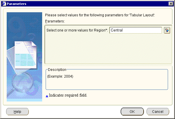

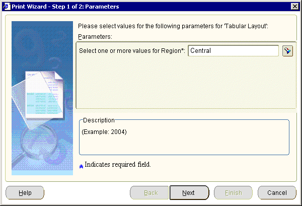

If any of the worksheets have active parameters, use the "Print Wizard dialog: Parameters page" to enter parameter values for each worksheet that has active parameters.
Discoverer then displays the operating system print dialog. For example, if you are using Windows, Discoverer displays the Windows Print dialog.
Use the operating system print dialog to set additional print options if required, and start the print job.
Discoverer prints the workbook on the printer selected.

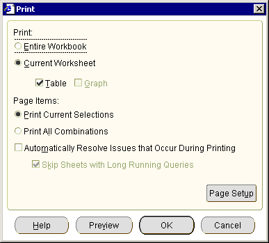

Use the Print dialog as follows:
Select the Current Worksheet check box.
Use the Table/Crosstab and Graph check boxes to specify the worksheet components you want to print.
(optional) Use the Page Items options to select the page item combinations you want to print.
(optional) To change the Page Setup options for the current worksheet, click Page Setup to display the "Page Setup dialog".
For example, you might want to create a worksheet header or footer, or change the margin size.
(optional) To check the printed worksheet layout before printing, click Preview to display the "Print Preview dialog".
(optional) To skip Discoverer alert messages that are displayed during printing, select the Automatically Resolve Issues That Occur During Printing check box.
Click OK.
If the worksheet has active parameters, use the "Print Wizard dialog: Parameters page" to enter parameter values for each active parameter.
