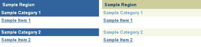

12.7.2.2 Changing Banner Colors and Fonts
Figure 12-13 shows the same item region with different banner and font color settings.
Figure 12-13 Same Item Region with Different Banner Colors
Description of Figure 12-13 follows
Description of "Figure 12-13 Same Item Region with Different Banner Colors"
