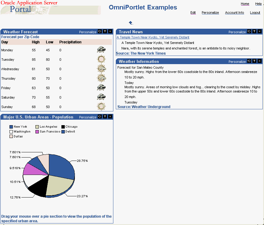

At the end of this chapter, you will create a page that contains four portlets, as shown in Figure 4-1.
Figure 4-1 Portal Page with Four OmniPortlet Examples

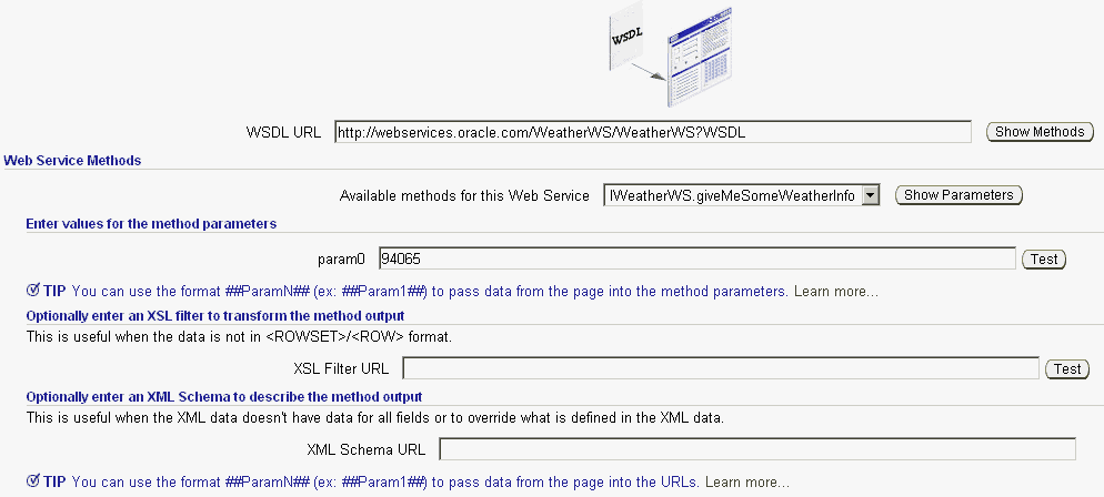

  3. On the Source page, in the WSDL URL field, enter the following URL:
    http://webservices.oracle.com/WeatherWS/WeatherWS?WSDL

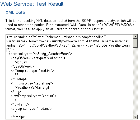

    This Web Service has one method (WeatherWS.giveMeSomeWeatherInfo) and accepts one parameter (param0). If you use a method that has parameters, the parameters will display in this section of the tab. You can enter a sample value for the parameter, then click Test to view the sample XML data, the SOAP response, and the SOAP Request.
  4. Click Show Methods.
  5. In the Web Service Methods section, in the param0 parameter field, enter a sample Zip code (for example, 94065), then click Test. The Web Service: Test Result window displays, where you can verify the XML data returned by the Web Service, as shown in Figure 4-3.
    Figure 4-3 OmniPortlet: Web Service Test Results Page
    Description of Figure 4-3 follows
    Description of "Figure 4-3 OmniPortlet: Web Service Test Results Page"
  6. Close the window.
    The Source page should look like the image shown in Figure 4-4.
    Figure 4-4 OmniPortlet: Web Service Source Tab
    Description of Figure 4-4 follows
    Description of "Figure 4-4 OmniPortlet: Web Service Source Tab"

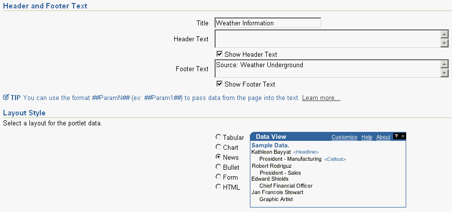

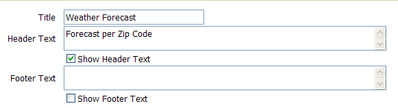

  9. On the View page, in the Title field, enter Weather Forecast.
  10. In the Header Text field, enter Forecast per Zip Code.
  11. Make sure the Show Header Text check box is selected, and clear the Show Footer Text check box, as shown in Figure 4-5.
    Figure 4-5 OmniPortlet: Web Service View Tab
    Description of Figure 4-5 follows
    Description of "Figure 4-5 OmniPortlet: Web Service View Tab"
  12. Make sure the Tabular radio button is selected, then click Next.

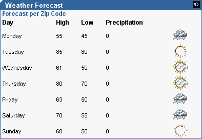

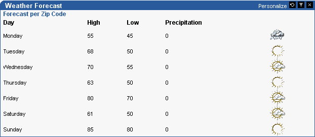

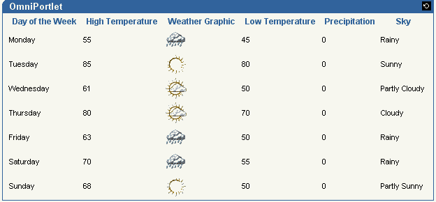

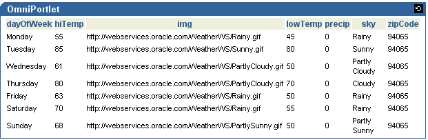

  15. Now that you've completed defining the portlet, click Finish. Your portlet should look like Figure 4-6.
    Figure 4-6 OmniPortlet: Web Service Portlet
    Description of Figure 4-6 follows
    Description of "Figure 4-6 OmniPortlet: Web Service Portlet"

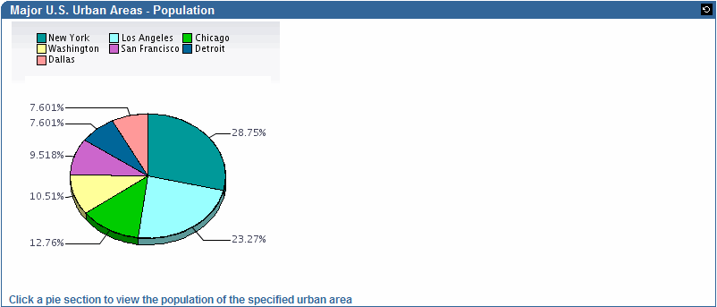

  11. In the Footer Text field, enter Click a pie section to view the population of the specified urban area.
    The text you just entered in the Footer Text field instructs your end users to click a pie section to view more details about the selected population. To enable this feature, you will need to complete the steps in Section 4.6, "Setting Up Portlet Parameters and Events".

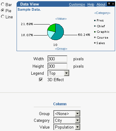

  13. Under Layout Style, select the Chart radio button, then click Next.
  14. On the Layout page, select the Pie radio button.
  15. In the Width field, enter 300.
  16. In the Height field, enter 300.
  17. From the Legend list, choose Top.
  18. Select the 3D Effect check box.
  19. Under Column Layout, from the Group list, choose <None>.
  20. From the Category list, choose City.
  21. From the Value list, choose Population. The Layout tab should now look like the image shown in Figure 4-7.
    Figure 4-7 OmniPortlet: Character-Separated Values (CSV) Layout Tab
    Description of Figure 4-7 follows
    Description of "Figure 4-7 OmniPortlet: Character-Separated Values (CSV) Layout Tab"
  22. Click Finish.
    Your portlet now displays on your portal page below the Weather Forecast portlet, and should look like Figure 4-8.

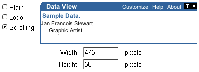

  14. On the Layout page, under News Style, select the Scrolling radio button.
  15. In the Width field, enter 475.
  16. In the Height field, enter 50.
    The News Style section of the Layout tab should now look like the image shown in Figure 4-9.

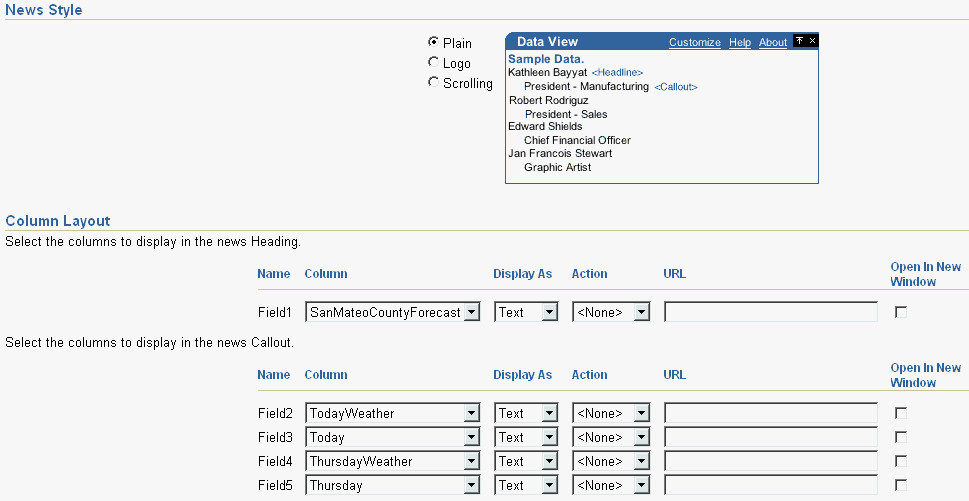

    Figure 4-9 OmniPortlet: XML Layout Tab - News Style
    Description of Figure 4-9 follows
    Description of "Figure 4-9 OmniPortlet: XML Layout Tab - News Style"

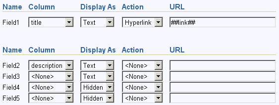

  17. Under Column Layout, next to Field 1 choose title from the Column list, Hyperlink from the Action list, and enter ##link## in the URL field, as shown in Figure 4-10.
    Figure 4-10 OmniPortlet: News Style Column Layout
    Description of Figure 4-10 follows
    Description of "Figure 4-10 OmniPortlet: News Style Column Layout"
  18. Next to Field2, choose description from the Column list and leave the default values for the other settings. Ensure this section of the Layout tab looks like Figure 4-11.
    Figure 4-11 Column Layout Section of the Layout Tab
    Description of Figure 4-11 follows
    Description of "Figure 4-11 Column Layout Section of the Layout Tab"

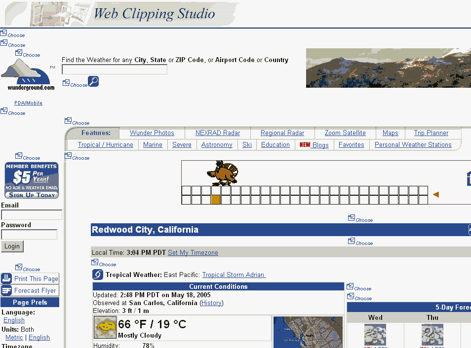

  5. On the Source tab, click Select Web Page.

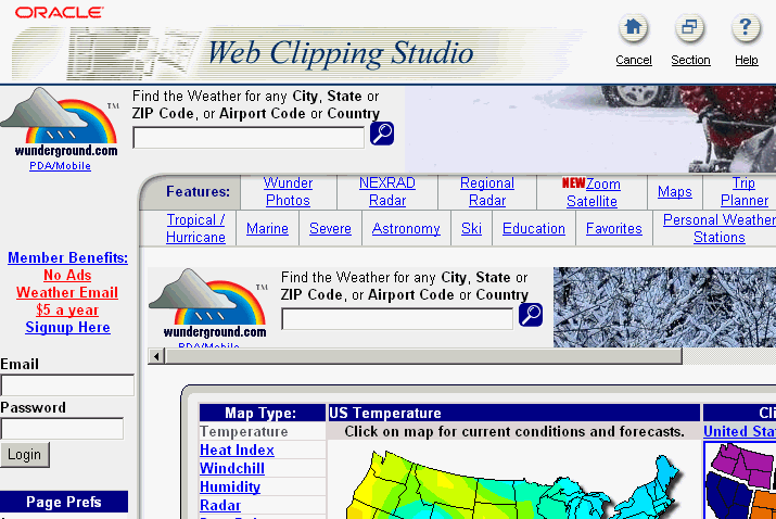

  6. On the Web Clipping Studio page that displays, in the URL Location field (Figure 4-13), enter the URL of the page you want to clip:
    http://www.wunderground.com
    You can use a different Web page, but keep in mind that your results will not match the example in this chapter.
    Figure 4-13 URL Location Field
    Description of Figure 4-13 follows
    Description of "Figure 4-13 URL Location Field"
    In this example, we use a third party Web site owned by The Weather Underground, Inc. Because this Web site is continually updated based on current weather forecasts, the images and steps included in this section may not reflect exactly what you see when you create this example. As you go further into this example, some of the steps may not work, as the owners may change the technology of this third party Web site.

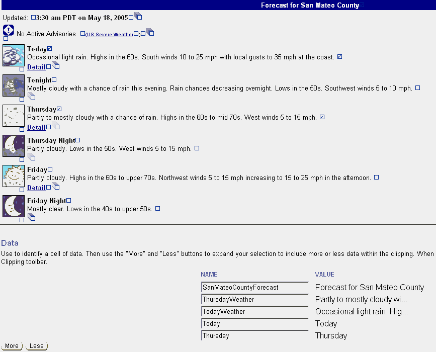

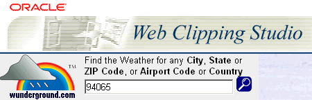

  7. Click Start to display the Web Clipping Studio. You should see the Web page display in the Web Clipping Studio, as shown in Figure 4-14.
    Figure 4-14 Web Clipping Studio Containing the www.wunderground.com Home Page
    Description of Figure 4-14 follows
    Description of "Figure 4-14 Web Clipping Studio Containing the www.wunderground.com Home Page"

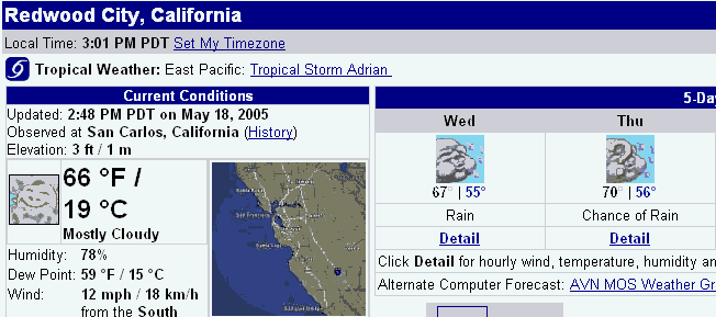

  8. On the home page, enter a zip code (for example, 94065) in the Weather field, as shown in Figure 4-15, then click the magnifying glass icon next to the field.
    Figure 4-15 Entering the Zip Code 94065 into the Weather Field
    Shows search for information using Web Clipping.
    Description of "Figure 4-15 Entering the Zip Code 94065 into the Weather Field"

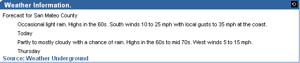

  9. The weather information for Redwood City, California displays in the Web Clipping Studio. A segment of the page is shown in Figure 4-16.
    Figure 4-16 Weather Information for Redwood City, California
    Shows sectioning target Web page.
    Description of "Figure 4-16 Weather Information for Redwood City, California"
  10. In the top right corner of the Web Clipping Studio, click the Section button, as shown in Figure 4-17.
    Figure 4-17 The Section Button
    Shows how to choose the search results.
    Description of "Figure 4-17 The Section Button"
  11. After you click the Section button, you'll notice that the elements of the Web page are broken down, and that a new icon displays called Choose at the top of each section. Figure 4-18 shows a snapshot of the Web Clipping Studio.
    Figure 4-18 Web Clipping Studio Displaying the Web Page Sections
    Description of Figure 4-18 follows
    Description of "Figure 4-18 Web Clipping Studio Displaying the Web Page Sections"

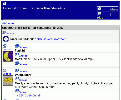

  12. Find the section shown in Figure 4-19, which shows the weather information for the city you chose (in this example, San Francisco Bay Shoreline).
    Figure 4-19 Weather Information for San Francisco Bay Shoreline with the Choose Icon
    Description of Figure 4-19 follows
    Description of "Figure 4-19 Weather Information for San Francisco Bay Shoreline with the Choose Icon"
  13. Click the Choose icon for this section, located directly above the "Forecast for San Francisco Bay Shoreline" title bar, as shown in Figure 4-19. The section displays in the Web Clipping Studio, as shown in Figure 4-20.
    Figure 4-20 Weather Information Section for San Mateo County in the Web Clipping Studio
    Description of Figure 4-20 follows
    Description of "Figure 4-20 Weather Information Section for San Mateo County in the Web Clipping Studio"
  14. After you have chosen the clipping, you can refine your data further by scraping the data, that is, selecting specific cells you wish to display in your portlet. Click the Scrape button (Figure 4-21).
    Figure 4-21 The Scrape Button
    Shows scraping data in Web Clipping Studio.
    Description of "Figure 4-21 The Scrape Button"
  15. While in Scraping mode, you can identify the text pieces in the Web clipping by selecting the check boxes next to each item. You can repeat these items at the column level, row level, or table level.
    In this example, we want to show the title and the description of each resulting article from our search. We can repeat the title and description at the row level, so that each result returned by the search displays only the title and the description of every result. In general, you choose the text items in the first row that contains all the pieces you wish to repeat for each row.
    After you click the Scrape button, you'll notice that check boxes display next to each item on the Web page, as shown in Figure 4-22.
    Figure 4-22 Scraping Check Boxes
    Description of Figure 4-22 follows
    Description of "Figure 4-22 Scraping Check Boxes"
  16. Select the output you want by selecting the check boxes next to the items.Figure 4-23 shows an example of a check box.
    Figure 4-23 Check Box for San Mateo County Title
    Shows selecting title.
    Description of "Figure 4-23 Check Box for San Mateo County Title"
    Depending on the color of the section you want to select, the check boxes may not be prominently displayed.
  17. After you select the check box for "Forecast for San Mateo County," notice that a corresponding label displays in the Data section of the Web Clipping Studio at the bottom of the screen, as shown in Figure 4-24.
    Figure 4-24 San Mateo County Label in Data Section
    Description of Figure 4-24 follows
    Description of "Figure 4-24 San Mateo County Label in Data Section"
  18. In the Name field, enter a more meaningful name, such as "SanMateoCountyForecast." Do not include spaces in the name.

  30. On the View tab, in the Title field, enter Weather Information.
  31. In the Footer Text field, enter Source: Weather Underground and make sure the Show Footer Text check box is selected.
  32. Under Layout Style, select the News radio button. The View tab should look like Figure 4-32.
    Figure 4-32 View Tab with the Options Selected
    Description of Figure 4-32 follows
    Description of "Figure 4-32 View Tab with the Options Selected"
  33. Click Next.
  34. Verify that the Layout tab looks like Figure 4-33.
  35. Click Finish.
  36. Your new Web Page portlet displays on the portal page, and should look like Figure 4-34.
    Figure 4-34 Weather Information Portlet on the Portal Page
    Description of Figure 4-34 follows
    Description of "Figure 4-34 Weather Information Portlet on the Portal Page"
Now that you have completed building all four example OmniPortlets, your page should look like Figure 4-35.
Figure 4-35 Portal Page Displaying the Four Example OmniPortlets
Description of Figure 4-35 follows
Description of "Figure 4-35 Portal Page Displaying the Four Example OmniPortlets"

  2. On the Source tab, replace the value of param0 (94065) with ##Param1##, as shown in Figure 4-37.
    Figure 4-37 param0 Set to ##Param1##
    Description of Figure 4-37 follows
    Description of "Figure 4-37 param0 Set to ##Param1##"

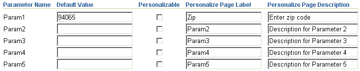

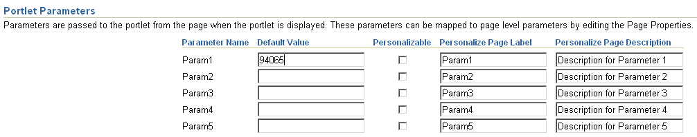

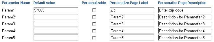

  3. Under Portlet Parameters, set the default value of Param1 to 94065.
  4. In the Personalize Page Label field, enter Zip.
  5. In the Personalize Page Description field, enter Enter zip code, as shown in Figure 4-38.
    Figure 4-38 Portlet Parameters Section of the Web Services Source Tab
    Description of Figure 4-38 follows
    Description of "Figure 4-38 Portlet Parameters Section of the Web Services Source Tab"
  6. Click OK.

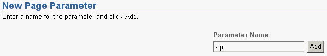

  3. Under New Page Parameter, in the Parameter Name field, enter zip, then click Add, as shown in Figure 4-42.
    Figure 4-42 New Page Parameter
    Description of Figure 4-42 follows
    Description of "Figure 4-42 New Page Parameter"

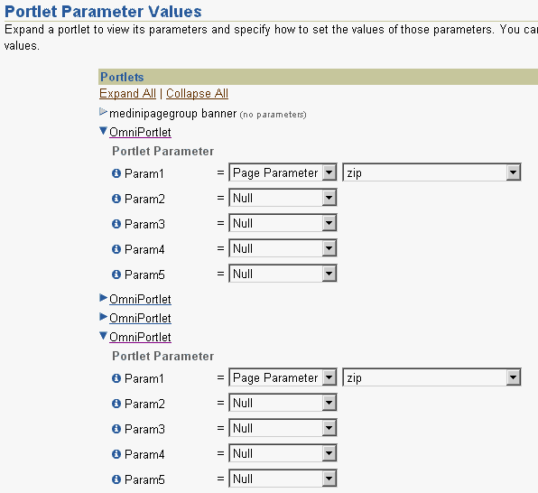

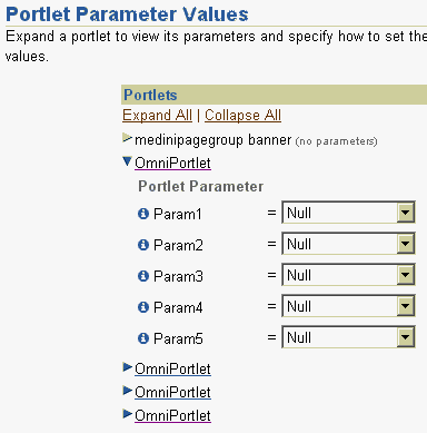

  5. Under Portlet Parameter Values, you will see a list of portlets listed. If you have followed all the steps in this chapter, you will see four instances of OmniPortlet listed. The Web Services portlet is the first in the list, and the Web Page data source is the fourth (or the bottom) instance of OmniPortlet in the list.
  6. Click the arrow next to the first instance of OmniPortlet to expand the Portlet Parameters list, as shown in Figure 4-44.
    Figure 4-44 Portlet Parameter Values Section
    Description of Figure 4-44 follows
    Description of "Figure 4-44 Portlet Parameter Values Section"
  7. Next to Param1, from the list, choose Page Parameter.
  8. From the list that displays, ensure that zip is selected.
  9. For the fourth OmniPortlet in the list, follow the same steps to set Param1 to the Page Parameter of zip, as shown in Figure 4-45.
  10. Figure 4-45 Portlet Parameters Section of the Page Parameters Tab
    Description of Figure 4-45 follows
    Description of "Figure 4-45 Portlet Parameters Section of the Page Parameters Tab"
The page parameter zip is now mapped to the portlet parameters for the Web Services and Web page portlets. Next, you will set up the chart portlet so that when a slice of the pie chart is clicked, the selected zip code will be sent to the page.

  1. In the Edit mode of the page, click the Edit Defaults icon for the chart portlet, as shown in Figure 4-46.
    Figure 4-46 Edit Defaults Icon for the Chart Portlet
    Description of Figure 4-46 follows
    Description of "Figure 4-46 Edit Defaults Icon for the Chart Portlet"
  2. Click the Layout tab.
  3. Under Chart Drilldown, choose Event1 from the Action list.
  4. Notice that in Edit Defaults mode, a new tab displays in the wizard called Events. Click the Events tab.
  5. On this tab, you will configure Event1 (which you set on the Layout tab) to pass the zip code from the chart to the page as the event output.
    Set Event1Param1 to zipcode, as shown in Figure 4-47, then click OK.
  6. Figure 4-47 Events Tab for the Chart Portlet
    Description of Figure 4-47 follows
    Description of "Figure 4-47 Events Tab for the Chart Portlet"
You have configured the chart portlet so that a user can click a slice of the pie chart, and set up an event so that the zip code selected in the pie chart will be sent to the page. Next, you will set up the page to accept this event parameter.

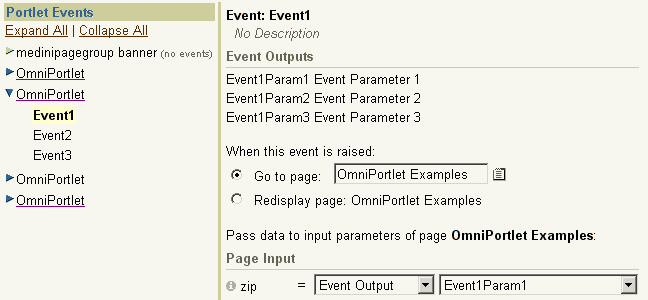

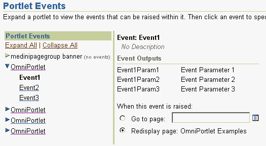

  1. On the page, in Edit mode, click the Page: Properties link, then click the Events tab.
  2. Expand the second OmniPortlet in the list to display the events below it, and select Event1, as shown in Figure 4-48.
    Figure 4-48 Portlet Events Section of the Page Events Tab
    Description of Figure 4-48 follows
    Description of "Figure 4-48 Portlet Events Section of the Page Events Tab"
  3. Select the Go to page radio button, then, next to the field, click the Browse Pages icon to search for the name of your page (in this case, OmniPortlet Examples). Next to your page name, click Return Object.
    If you do not know the name of the page, you can return to the Edit mode of the page by clicking Cancel. Then, click the Page Group: Properties link to view the display name of the page group. When you return to the Events tab of the Page Properties, you can click the Browse Pages icon to search for the page group, under which you should see the page name.
  4. Set the Page Input as shown in Figure 4-49.
    Figure 4-49 Page Input on the Events Tab
    Description of Figure 4-49 follows
    Description of "Figure 4-49 Page Input on the Events Tab"
  5. Click OK.
  6. Now, when you drag your mouse over the pie chart in the Chart portlet, you should notice that you can click one of the sections. Try clicking on the largest slice (New York). You will notice that the page refreshes.
    In the URL of the page, you should see a parameter value set after the page name, for example: OmniPortlet%20Examples?zip=10001. The Weather Forecast information changes, and looks something like Figure 4-50.
    Figure 4-50 Weather Forecast (Web Service) Portlet for New York
    Description of Figure 4-50 follows
    Description of "Figure 4-50 Weather Forecast (Web Service) Portlet for New York"

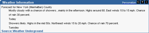

    The Weather Information portlet changes, and looks something like Figure 4-51.
    Figure 4-51 Weather Information (Web Page) Portlet for New York
    Description of Figure 4-51 follows
    Description of "Figure 4-51 Weather Information (Web Page) Portlet for New York"

  4. Click Finish. Your portlet looks like Figure 4-53.
  5. Figure 4-53 Initial View of an OmniPortlet Using the HTML Layout
    Description of Figure 4-53 follows
    Description of "Figure 4-53 Initial View of an OmniPortlet Using the HTML Layout"
  6. You'll notice that under "img," the URL displays instead of an actual image. To change the HTML source, click the Edit Defaults (pencil) icon to edit your OmniPortlet.
  7. Click the Layout tab.
  8. In the Repeating Section, look for the row with the code: <TD>##img##</TD>.
  9. Replace this code with: <TD><img src="##img##"></TD>.

    <TD>##zipCode##</TD>
  13. Perform the same action for any other headings you wish to change, then click Finish. Your portlet now looks like Figure 4-54.
    Figure 4-54 Final View of an OmniPortlet Using the HTML Layout
    Description of Figure 4-54 follows
    Description of "Figure 4-54 Final View of an OmniPortlet Using the HTML Layout"
