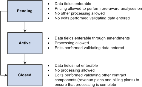

Status Flow
This diagram shows the flow between the contract header status values and the functionality for each header status value:
Status value flow of the contract header
Processing statuses can flow forwards only; that is, you cannot:
When you initiate a change in the processing status for a contract, the system performs a series of checks to ensure that the contract meets all necessary criteria to move to the next processing status level. Unless the contract meets all necessary criteria, the processing status cannot advance.
