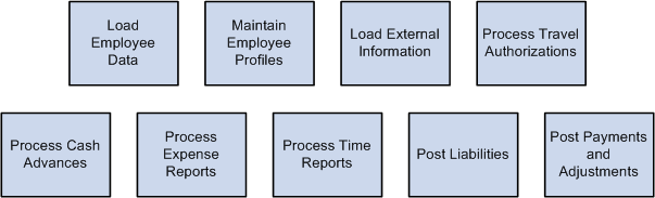

This diagram displays the business processes supported by PeopleSoft Expenses, which includes loading employee data, maintaining employee profiles, loading external information, processing travel authorizations, cash advances, expense reports, time reports and posting liabilities, payments and adjustments:
PeopleSoft Expenses business processes
We discuss these business processes in the business process chapters in this PeopleBook.
