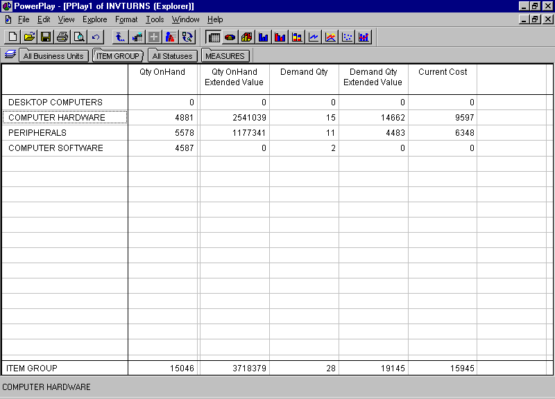

Click to jump to parent topicViewing and Analyzing Cube Data
After building a cube, use PowerPlay to view it. You can pivot, reposition, and manipulate data and create graphs and charts. To use Cognos PowerPlay, see the PowerPlay documentation. Here is an example of a typical cube viewed in PowerPlay:
Sample cube viewed in PowerPlay: analyze inventory balances and historical usage using OLAP reporting
