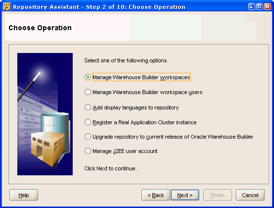

To use a repository, you must define an initial workspace, and the owner of that workspace. The following instructions use the Repository Assistant.
To create a workspace:
Start the repository assistant from the Start menu, selecting Program Files, then Oracle - OWB112, then Warehouse Builder, then Administration, then Repository Assistant.
On the Welcome screen of the Repository assistant, click Next.
On the Database Information screen, enter the connection information (Host Name, Port Number, and Oracle Service Name) for the repository database, and click Next.
On the Choose Operation screen, select Manage Warehouse Builder Workspaces. Click Next.

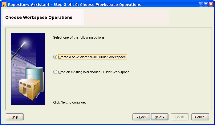

On the Choose Workspace Operations screen, select Create a New Warehouse Builder workspace. Click Next.

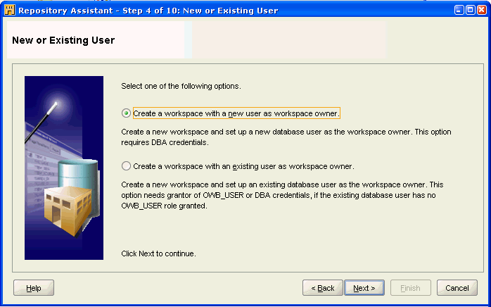

On the New or Existing User screen, select Create a workspace with a new workspace owner. Click Next.

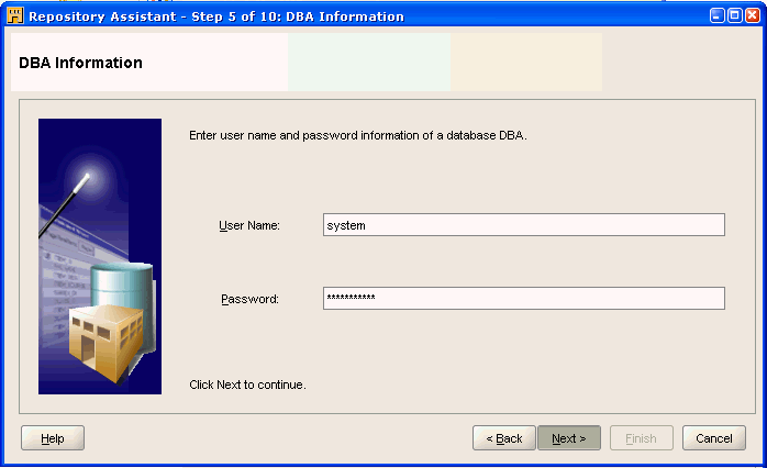

On the DBA Information screen, enter the User Name of a user with a SYS privilege, and that user's Password.
Click Next.

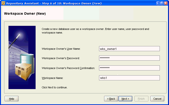

In the Workspace Owner (New) screen, enter the following:
Workspace Owner's User Name (wks_owner1)
Workspace Owner's Password
Workspace Owner's Password Confirmation
Workspace Name (wks1)
Click Next.

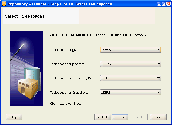

On the Select Tablespaces screen, enter the following:
Tablespace for Data (USERS, or the name of the desired tablespace)
Tablespace for Indexes (USERS, or the name of the same tablespace)
Tablespace for Temporary Data (TEMP)
Tablespace for Snapshots (USERS, or the name of the same tablespace)
Click Next.
Note that this step allows you to change the default tablespace details. The OWB repository is stored in the OWBSYS schema, but you must identify what tablespaces are used to store OWBSYS and certain other objects, like snapshots. You may choose tablespaces other than USERS, depending on your storage management strategy.

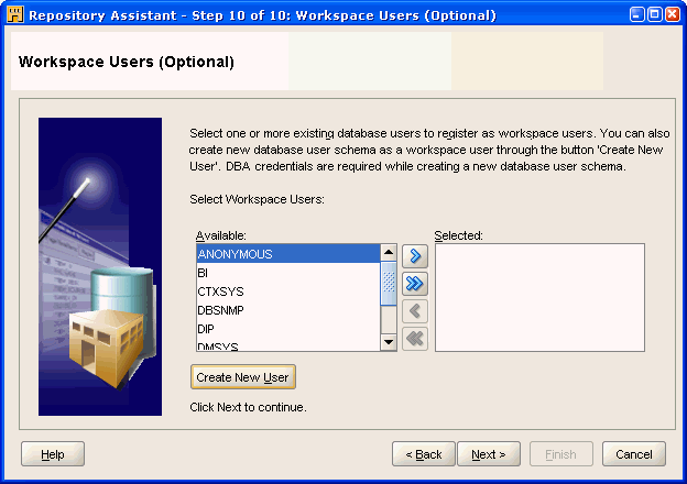

On the Workspace Users (Optional) screen, select the appropriate existing users from the Available list add them to the Selected list.
[Optional] Click Create New User to make new users who can access OWB. This takes you to step 14.
Click Next. This takes you to step 16.

In the Workspace Users (Optional) screen, click Next.
