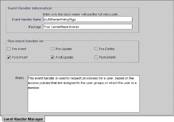

9.2 Event Handler Manager Form
This form is displayed in the Development Tools/Business Rule Definition folder. You use this form to manage the Java classes that process user-defined or system-generated actions (or events). These classes are known as event handlers. When you add a new event handler to Oracle Identity Manager, you must first register it here so that Oracle Identity Manager can recognize it.
There are two types of event handlers:
By using the Event Handler Manager form, you can specify when you want Oracle Identity Manager to trigger an event handler. An event handler can be scheduled to run as follows:
Figure 9-1 shows the Event Handler Manager form.
Figure 9-1 Event Handler Manager Form
Description of "Figure 9-1 Event Handler Manager Form"

Adding or Modifying an Event Handler
To add or modify an event handler:
  1. Open the Event Handler Manager form.
  2. To add an event handler to Oracle Identity Manager, enter the name of the event handler into the Event Handler Name lookup field.
    To modify an event handler, double-click the Event Handler Name lookup field.
    From the Lookup dialog box that is displayed, select the event handler that you want to edit.
  3. In the Package field, add or edit the name of the Java package of which the event handler is a member.
  4. Select the check boxes that correspond to when you want Oracle Identity Manager to trigger the event handler.
    You can schedule an event handler to run on preinsert, preupdate, predelete, postinsert, postupdate, and postdelete.
    Selecting a check box does not mean that the event handler is triggered at that time, for example, on preinsert. It signifies that the event handler can run at that time.
  5. In the Notes area, add or edit explanatory information about the event handler.
  6. Click Save.
    The event handler is added or modified.

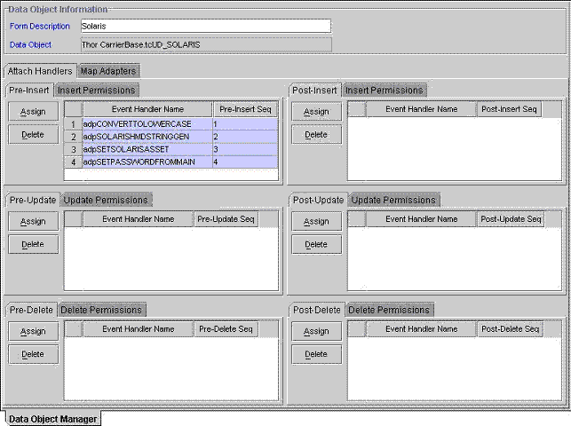

9.3 Data Object Manager Form
The Data Object Manager form is displayed in the Development Tools/Business Rule Definition folder. You use this form to:
Figure 9-2 shows the Data Object Manager form.
Figure 9-2 Data Object Manager Form
Description of "Figure 9-2 Data Object Manager Form"

9.3.1 Tabs of the Data Object Manager Form
After you start the Data Object Manager form and select a target data object, the tabs of this form become functional.
The Data Object Manager form contains the following tabs:
  • Attach HandlersMap Adapters
Each of these tabs is described in the following sections.
9.3.1.1 Attach Handlers Tab
You use this tab to select the rule generator adapters, entity adapters, or event handlers that will be assigned to or removed from a data object. This includes the following:
  • Specifying when Oracle Identity Manager triggers the assigned event handlers or adapters (on pre-insert, pre-update, pre-delete, post-insert, post-update, or post-delete).Setting the order in which Oracle Identity Manager triggers the adapters or event handlers that belong to the same execution schedule.
When an event handler, rule generator adapter, or entity adapter must no longer be triggered by Oracle Identity Manager, you must remove it from the data object.
For example, Oracle Identity Manager can trigger the adpCONVERTTOLOWERCASE, adpSOLARISHMDSTRINGGEN, adpSETSOLARISASSET, and adpSETPASSWORDFROMMAIN adapters on pre-insert. Based on the sequence numbers of these adapters, Oracle Identity Manager triggers the adpCONVERTTOLOWERCASE adapter first, followed by the adpSOLARISHMDSTRINGGEN, adpSETSOLARISASSET, and adpSETPASSWORDFROMMAIN adapters, respectively.
To see the user groups that can add, modify, and delete the current data object, click the Insert Permissions, Update Permissions, or Delete Permissions tabs, respectively.
