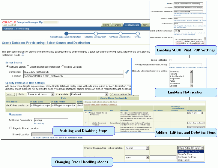

The following describes the types of customization you can perform with Deployment Procedures:
| Type 1 | Type 2 |
| Editing Default Deployment Procedures
You can edit an existing, default Deployment Procedure that is offered by Enterprise Manager Grid Control. You can perform the following tasks:
Creating Custom Deployment Procedures
You can create your own custom Deployment Procedure with new steps, phases, privilege levels, and so on. However, note that you can create custom Deployment Procedures only using Patching Deployment Procedures. You can perform the following tasks:
The following shows the different sections that need to be edited while customizing a Deployment Procedure to add or delete steps, enable or disable steps, enable e-mail notifications, and enable other privilege-level settings.

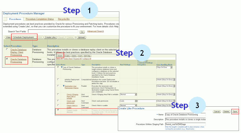

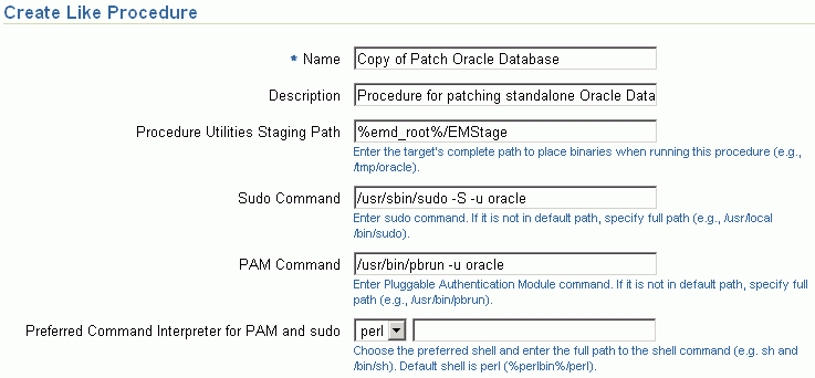

The first step towards customizing a Deployment Procedure is to create a copy of the default Deployment Procedure that is offered by Enterprise Manager Grid Control. Note that only a copy can be edited and customized with your changes; the default Deployment Procedures must always and will always remain unchanged.
To create a copy of a default Deployment Procedure, follow these steps:
In Grid Control, click the Deployments tab.
On the Deployments page, from the Deployment Procedure Manager section, click Deployment Procedures.
On the Deployment Procedure Manager page, select the Deployment Procedure you want to customize, and click Create Like.
On the Create Like Procedure page, edit the procedure to customize it according to your needs, and click Save.

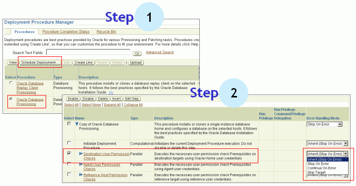

On the Create Like Procedure page, select the step or phase you want to delete, and click Delete.
Oracle recommends that you disable the steps or phases instead of deleting them because steps or phases once deleted cannot be retrieved, but steps or phases disabled can always be enabled later. For information about enabling and disabling steps or phases, see Enabling or Disabling Phases or Steps.
If you do not want to have some phases or steps in a Deployment Procedure, you can always disable them instead of deleting them. This is a preferred option because phases or steps once deleted cannot be retrieved, but phases or steps disabled can always be enabled later. For more information about phases and steps, see Understanding Phases and Steps.
To enable or disable phases or steps in a Deployment Procedure, follow these steps:
On the Create Like Procedure page, do the following:
To disable a phase or step, select the phase or step you want to disable, and click Disable.
To enable a phase or step, select the phase or step you want to enable, and click Enable.

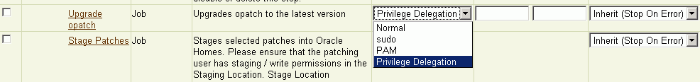

You can use SUDO, PowerBroker, and Privilege Delegation Settings globally, that is, for all steps, or only for some steps within a Deployment Procedure. This section explains the following:
For SUDO and PowerBroker, you can specify the SUDO and PowerBroker commands to run, and also set environment variables and the preferred command interpreter for them.

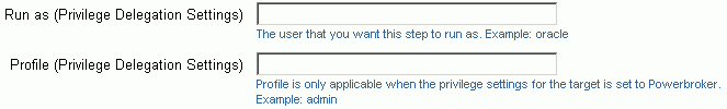

For Privilege Delegation, you can specify the user and the profile that the step must run as.
For each step, from the Run Privilege column, you can select either SUDO, PAM, or Privilege Delegation.
If you select SUDO or PAM, then in the Run Privilege Command/Privilege Delegation column, specify the Run As command. If you select Privilege Delegation, then specify the Run As value in the first text box and the Profile value in the second text box.
Note: If you select SUDO or PAM, and leave the Run Privilege Command column blank, then the commands as set in the SUDO Command and PAM Command fields are used. However, if you want some steps to override these globally declared commands, then in the Run Privilege Command column for that step, specify the commands that need to be used instead. If these settings are not made, then the Run As and Profile values specified along with preferred credential are used. |

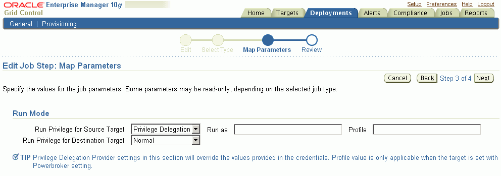

For file transfer-based job steps, you can apply the Privilege Delegation settings while editing that step. For example, one of the steps in the One Click Extend Cluster Database deployment procedure is Copy Archives. This is a file transfer-based job step for which you can apply the Privilege Delegation settings. To do so, you can click the step name and on the Map Parameters page, in the Run Mode section, from the Run Privilege for Source Target list and Run Privilege for Destination Target list, select Privilege Delegation. Then provide the Run As value and profile that must be used.
Note: For configuration collection-based job step, you can NOT apply any Privilege Delegation settings. For example, one of the steps in the One Click Extend Cluster Database deployment procedure is Refresh Host Configuration. This is a configuration collection-based step for which Privilege Delegation settings cannot be applied. |
Every step in a Deployment Procedure is preconfigured with an error handling mode that indicates how the Deployment Procedure will behave when the phase or step encounters an error. The error handling modes offered by Enterprise Manager Grid Control are:
Inherit - Inherits the error handling mode that was set for the enclosing phase. (When set for a step that is outside a phase, it inherits the error handling mode from the Deployment Procedure).
Stop On Error - Stops when an error is encountered. Deployment Procedure does not proceed to the next step until you correct the errors or override them.
Continue On Error - Continues even when an error is encountered.
Skip Target - Ignores the failed target on the list and continues with other targets.
For more information about steps, see Understanding Phases and Steps.
To change the error handling modes, follow these steps:
On the Create Like Procedure page, select a phase or step, and from the list provided in the Error Handling Mode column against that phase or step, select the mode you want to set.
Once the mode is selected from the list, Enterprise Manager Grid Control automatically refreshes the page with the newly selected mode for that phase or step.
