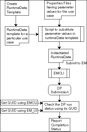

The following depicts the process to use EMCLI to run Deployment Procedures:
There are four required actions to run Deployment Procedures. Those steps are described below:
Step 1: Find the GUID of the procedure to be run using EMCLI. This is a one-time activity.
Step 2: Obtain the RuntimeData xml or RuntimeData template for the procedure that needs to be run. This is also a one-time activity.
Step 3: Create the properties file for the RuntimeData xml or RuntimeData template. This step is required for each execution of the procedure.
Step 4: Submit the RuntimeData template or RuntimeData, properties file for the given execution and procedure GUID as input to an out-of-box script that will generate a new runtime data response file and then use this response file to run the procedure using EMCLI.
Each of these steps is discussed in detail in the subsequent sections.
