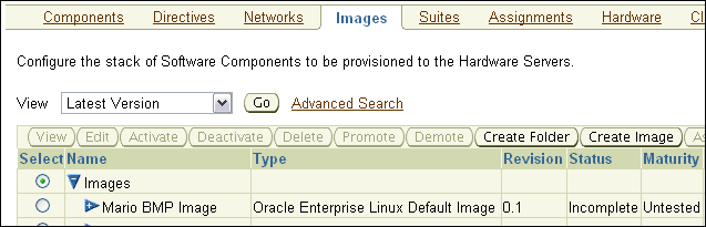

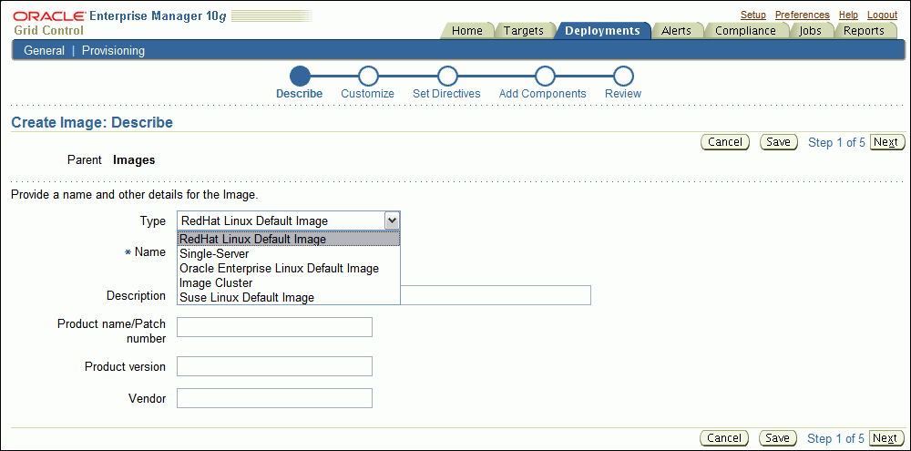

  1. Go to the Images tab and click Create Image. The following page is displayed:
    This figure displays the Create Image: Describe Page.
    In the Describe step, choose appropriate type of Default Image depending on the Operating System that needs to be provisioned on the bare metal servers. Enter a name for the image and other information that you may want to associate with it. Click Next.

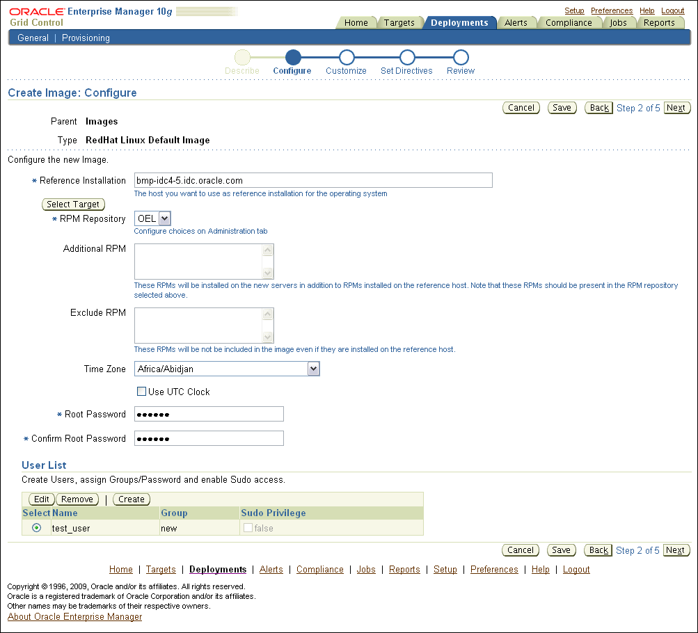

  2. The Configuration step comes up as shown below.
    This figure displays the Create Image: Configure Page.
The Configure step depends on the type of the type of Image selected in the earlier step and is different for different types of Images. On this page, specify the following details:
Reference Installation is the reference host or gold host used for creating OS components for this image. For information about reference host, see Overview of the Bare Metal Provisioning Environment.
RPM repository allows you to choose an RPM repository from a list of RPM repositories configured for use with the provisioning application.
Additional RPM allows you to add RPMs for installation on the servers to be provisioned.
Exclude RPM allows you to specify the RPMs to be excluded from the image.
Time Zone and UTC Clock are used for setting the time zone of the bare-metal boxes after provisioning the operating system on them. Select the time zone corresponding to the OMS time zone.
Root Password is the root password that needs to be set for the newly provisioned Linux box.
User List is the list of operating system users you want to configure for the newly provisioned Linux box. You can create users with sudo permission.
Clicking Next brings up the Customize and Set Directives steps. For Default Image case, the out-of-the-box directives are automatically associated during creation.

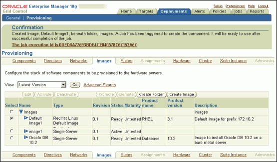

Image Creation Confirmation
Clicking on the job link will show the various steps executed by the job.
Once the job is finished a new Image can be seen in the Images table on the Images tab. This Image is created with version 0.1 is in Ready state for use. Any subsequent changes to the Image will lead to an increment of 0.1 in revision.

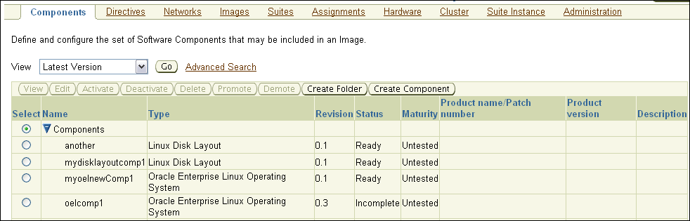

As a check, go to the components tab to check the components that have been created automatically created for the Default Image under the node "Oracle Components". The components created for the Default Image are non-editable as shown below:
This figure displays the Components tab.

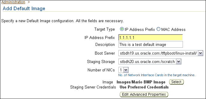

  1. Go to the Administration tab and click Add in the Default Images section on the Administration tab as shown below.
    Default Images Section
  2. The Add Default Image page appears.
    This figure displays Add Default Image Page.
    Enter the following values on this page:
    • IP Address Prefix or MAC Address:
      • IP Address Prefix is used to specify the IP prefix of subnet where the bare-metal machines would be added.
      • MAC Address is used to specify the MAC addresses of the bare metal machines to be added.
    • Choose a desired Boot Server and Stage Server from the list of servers configured with the provisioning application.
    • Specify the Image name to be used as the Default Image, select Use Preferred Credentials for the Stage server.
      Specify the number of network cards for the target machine in the Number of NICs field.

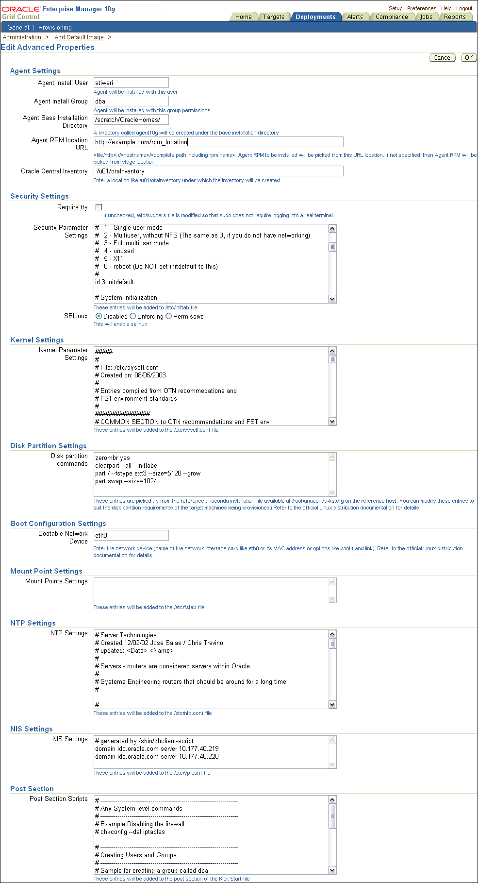

    • Click Edit Advanced Properties.
    Edit Advanced Properties Page
    You can provide the following properties:
    • In the Agent Settings section, specify the agent user, group, and Oracle home for the install, and the location of the agent RPM. If the agent RPM location is not specified, the RPMs will be picked up from the stage location. You can also specify the location where you want the Oracle Central Inventory to be created.
    • In the Security Settings section, you can add a script in the Security Parameters field. You can enable or disable SELinux.
    • In the Kernel Settings section, you can add a script in the Kernel Parameters field.
    • In the Disk Partition Settings section, you can specify the disk partition for new Linux machines. These entries are picked up from the reference anaconda installation file available at /root/anaconda-ks.cfg on the reference host. You can modify these entries to suit the disk partition requirements of the target machines being provisioned.
    • In the Boot Configuration Settings section, specify the name of the network interface card such as eth0 or its MAC address or options like bootif and link.
    • In the Mount Point Settings section, you can specify entries for the /etc/fstab file. You can specify mount points on the newly provisioned Linux machine. By default, mount point settings from the reference Linux machine are inherited.
    • In the NTP Settings section, you can specify entries for the /etc/ntp.conf file. You can specify NTP settings for the newly provisioned Linux machine. By default, NTP settings from the reference Linux machine are inherited.
    • In the NIS Settings section, specify entries for the /etc/yp.conf file. You can specify NIS settings for the newly provisioned Linux machine. By default, NIS settings from the reference Linux machine are inherited.
    • In the Post section, specify any set of commands that need to be executed on the newly provisioned machine. These commands will be appended to the post section of the kickstart file.

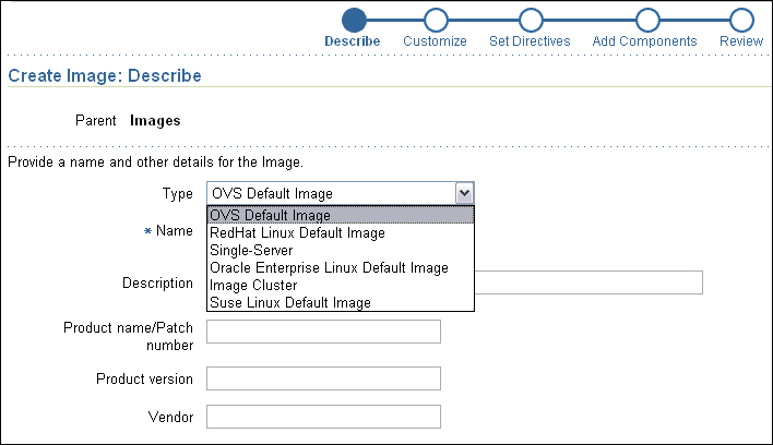

  1. In the Images tab, click Create Image.
  2. In the Create Image: Describe page, select Type as OVS Default Image, and specify a name and other details for the image. Click Next.

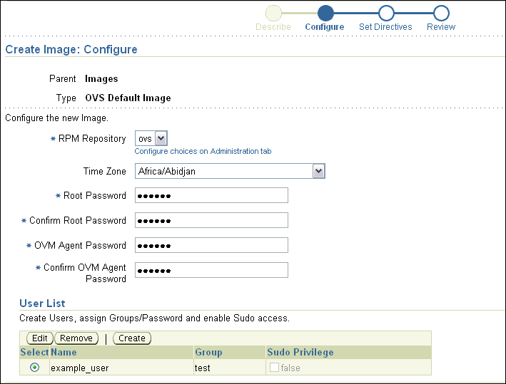

  3. In the Create Image: Configure page, select the RPM repository.
    Select the Time Zone and specify the root password for the operating system and the OVM agent password. The OVM agent password is used when registering the Virtual Server with the Server Pool.
    In the User List section, you can add users for the operating system during the provisioning process.
    Unlike bare metal provisioning of Linux boxes, when you provision virtual servers, you do not require a reference installation.

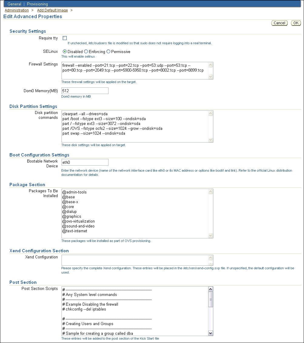

  10. Click Edit Advanced Properties.
  11. In the Edit Advanced Properties page, specify advanced properties for the operating system.
    In the Security Settings section, specify the following values:
    • Request tty - Select this option to set the "Defaults require tty" property in the /etc/sudoers file.
    • SELinux - Choose to disable or enable SELinux.
    • Firewall Settings - Specify firewall settings for the virtual server target.
    • Dom0 Memory (MB) - Specify memory size for the virtual server.
    In the Disk Partition Settings section, specify the disk partition configuration to be applied to the target machines.
    In the Boot Configuration Settings section, specify the network device name.
    In the Package section, you can specify the packages to be installed during the provisioning operation.
    In the Xend Configuration section, you can specify entries for the /etc/xen/xend-config.sxp file.
    In the Post section, specify any set of commands that need to be executed on the newly provisioned machine. These commands will be appended to the post section of the kickstart file. You can specify Kernel, NFS, NTP, and other configurations in the Post section.
    Unlike bare metal provisioning of Linux boxes, when you provision virtual servers, you will not configure the agent, since the virtual server will not explicitly contain an agent to monitor it.

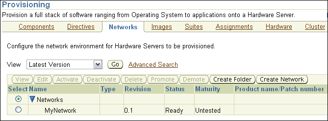

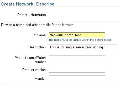

Creating A Network Component
Create a network component to provide network details for the machines you are provisioning.
To learn about creating a network component, see Creating a Network Component.

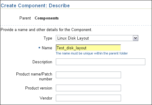

Creating A Disk Layout Component
Create a disk layout component to provide profiles for hard disk, physical disk partition, RAID configuration, logical volumes, and logical volume groups for the machines you are provisioning.
To learn about creating a disk layout component, see Creating Disk Layout Component.

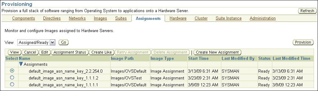

Creating An Assignment
Create an Assignment by associating the single-server image with the network component and any hardware component.
To learn about creating an assignment, see Creating Assignments.

To create a network profile, do the following:
  1. In the Networks tab, click Create Network.
    Networks tab
  2. In the Create Network: Describe page, specify the name, description, and product details for the network component. Click Next.
    Create Network: Describe Page.

  1. In the Components tab, click Create Component.
  2. In the Create Component: Describe page, select Type as Linux Disk Layout, and specify the name and other product details. Click Next.
    Create Component: Describe Page

  2. In the Create Component: Describe page, select Type as Linux Operating System, (RedHat Linux, Oracle Enterprise Linux, or SuSE Linux), and specify the name and other product details. Click Next.
  3. In the Create Component: Configure page, select the target host for the reference installation for the operating system, select the RPM repository, add or delete RPMs, specify the root password for the operating system and the list of operating system users you want to configure when the machine is provisioned. Click Next.
  4. In the Create Component: Set Directives page, choose the out-of-box operating system directives for the operating system component for single server component creation. The directive will be available at Oracle Directives/Baremetal Provisioning/Single Server/Linux/OS Staging. Click Next.
  5. Review the information you have provided and clickFinish.
The operating system component is created.
Creating Single Server Image
Follow these steps to create a single server image:
  1. In the Images tab, click Create Images.
    This figure shows the Images tab.

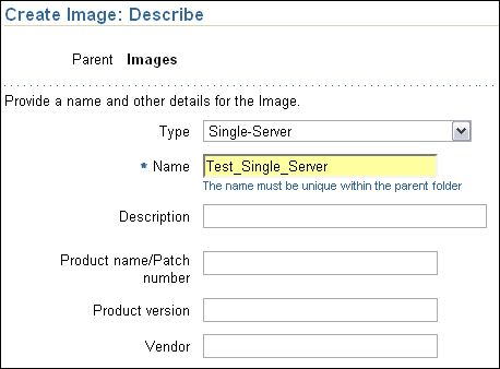

  2. In the Create Image: Describe page, select Type as Single-Server and specify the name and other product details. Click Next.
    This figure displays the Create Image: Describe page.
  3. In the Create Image: Customize page, add properties if you want to customize the image. Click Next.
  4. In the Create Image: Set Directives page, choose the out-of-box single server directives. The directives are available at Oracle Directives/Baremetal Provisioning/Single Server/Linux/Image Staging. Click Next.
  5. In the Create Image: Add Components page, add the disk layout component and OS component created earlier. Click Next.
  6. Review the information you have provided and click Finish.
The single server image is created.

  1. In the Assignments tab, click Create New Assignment.
    This figure displays the Assignments tab.
