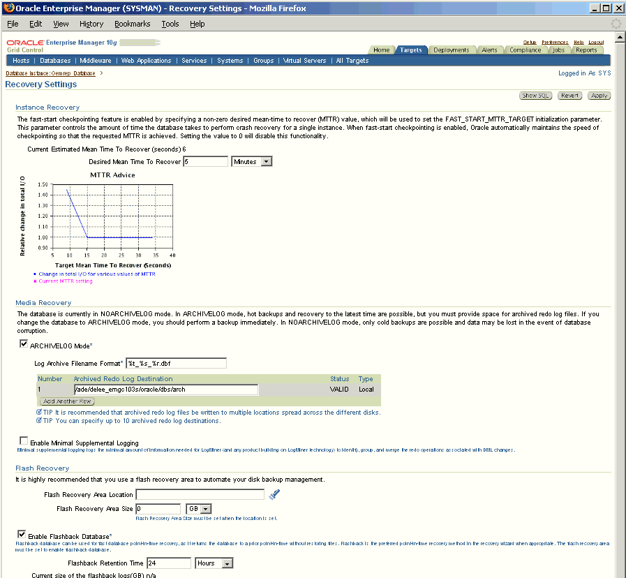

Setting Up the Backup
First, navigate to the Enterprise Manager Recovery Settings page (Target-->Database--><Repository Database Target>-->Availability-->Recovery Settings) and enable Archive Logging then Flashback Database as shown in Figure 10-1.
Figure 10-1 Recovery Settings Page
Description of Figure 10-1 follows
Description of "Figure 10-1 Recovery Settings Page"

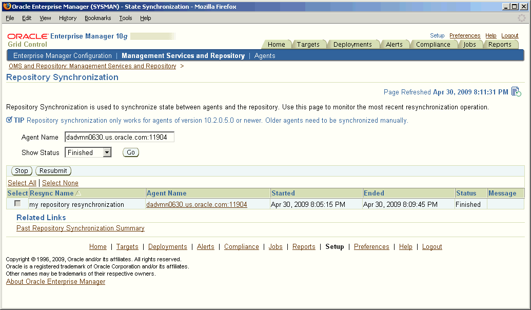

Beginning with Enterprise Manager version 10.2.0.5, a new repository resync feature allows you to automate the process of synchronizing the Enterprise Manager repository with the latest state available on the Agents. To resynchornize the repository with the Agents, you use Enterprise Manager Command-line utility (emctl) resync repos command:
emctl resync repos -full -name "<descriptive name for the operation>"
You must run this command from the OMS Oracle Home after restoring the repository but BEFORE starting the OMS. After submitting the command, start up all OMS's and monitor the progress of repository resychronization from the Enterprise Manager console's Repository Resynchronization page, as shown in Figure 10-3.
Figure 10-3 Repository Synchronization Page
Description of Figure 10-3 follows
Description of "Figure 10-3 Repository Synchronization Page"
Repository recovery is complete when the resynchronization jobs complete on all Agents.

  4. Initiate Repository resynchronization:
    emctl resync repos -full -name "<resync name>"
    from the OMS Oracle home of host "A"

resync repos
Submits a repository resynchronization operation. When the –full option is specified, all agents are instructed to upload the latest state to the repository. A list of agents can be specified using the –agentlist option to resync with a given list of agents.
Usage:
emctl resync repos (-full|-agentlist "agent names") [-name "resync name"] [-sysman_pwd "sysman password"]

statusresync repos
Lists the status of given repository resynchronization operation.
Usage:
emctl statusresync repos -name "resync name"
