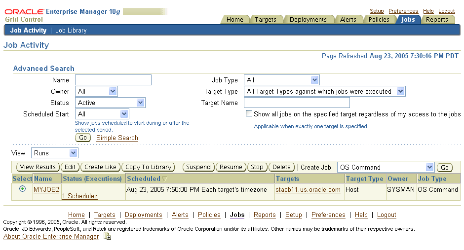

The Job Activity page (Figure 8-1) is the hub of the Job System. From this page you can:
Search for existing job runs and job executions
You can restrict the search by name, owner, status, scheduled start, job type, target type, and target name.
Create a job
View, edit, create like, suspend, resume, stop, and delete a run
View, edit, create like, suspend, resume, retry, stop, and delete an execution
