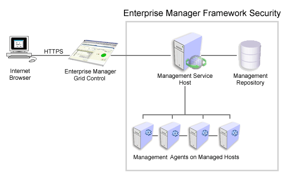

Figure 4-2 shows how Enterprise Manager Framework Security provides security for the connections between the Enterprise Manager components.
Figure 4-2 Enterprise Manager Framework Security
Surrounding text describes Figure 4-2 .
Enterprise Manager Framework Security implements the following types of secure connections between the Enterprise Manager components:
  • HTTPS and Public Key Infrastructure (PKI) components, including signed digital certificates, for communications between the Management Service and the Management Agents.

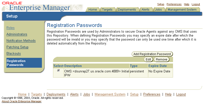

To run the emctl secure oms utility you must first choose an Agent Registration Password. The Agent Registration password is used to validate that future installation sessions of Oracle Management Agents and Oracle Management Services are authorized to load their data into this Enterprise Manager installation.

  6. You will be prompted for the Agent Registration Password, which is the password required for any Management Agent attempting to secure with the Management Service. Specify an Agent Registration Password for the Management Service.

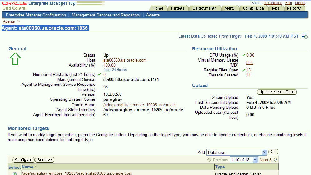

  6. Confirm that the Management Agent is secure by checking the Management Agent home page.
    You can also check if the Agent Management is secure by running the emctl status agent -secure command, or by checking the Agent and Repository URLs in the output of the emctl status agent command.
    In the General section of the Management Agent home page (Figure 4-3), the Secure Upload field indicates whether or not Enterprise Manager Framework Security has been enabled for the Management Agent.

Using the Grid Control Console to Manage Agent Registration Passwords
You can use the Grid Control Console to manage your existing registration passwords or create additional registration passwords:
  1. Click Setup at the top of any Grid Control Console page.
  2. Click Registration Passwords.
    Enterprise Manager displays the Registration Passwords page (Figure 4-4). The registration password you created when you ran the emctl secure oms command appears in the Registration Passwords table.
  3. Use the Registration Passwords page to change your registration password, create additional registration passwords, or remove registration passwords associated with the current Management Repository.
Figure 4-4 Managing Registration Passwords in the Grid Control Console
Surrounding text describes Figure 4-4 .
When you create or edit an Agent Registration Password on the Registration Passwords page, you can determine whether the password is persistent and available for multiple Management Agents or to be used only once or for a predefined period of time.
For example, if an administrator requests to install a Management Agent on a particular host, you can create a one-time-only password that the administrator can use to install and configure one Management Agent.
On the other hand, you can create a persistent password that an administrator can use for the next two weeks before it expires and the administrator must ask for a new password.

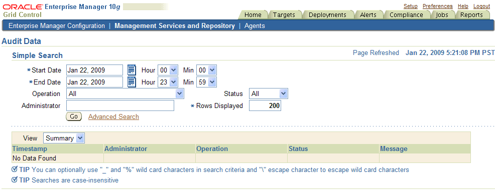

Searching the Audit Data
You can search for audit data that has been generated over a specified period. You can also search for the following:
  • Audit details of a specific user operation or all user operations.
  • Audit details of operations with a Success or Failure status or All operations.

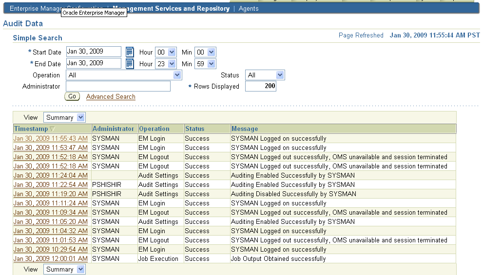

To view the audit data, click the Setup option. On the Setup page, click the Management Services and Repository tab. The Overview page is displayed. Click the Audit Data link under the Audit section. The Audit Data page is displayed.
Figure 4-5 Audit Data Search Page
Surrounding text describes Figure 4-5 .
Specify the search criteria in the fields and click Go. The results are displayed in the Summary table.
Figure 4-6 Audit Data Search Page
Surrounding text describes Figure 4-6 .

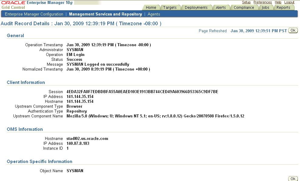

To view the details of each record that meets the search criteria, select Detailed in the View drop-down list. To drill down to the full record details, click on the Timestamp. The Audit Record page is displayed.
Figure 4-7 Audit Record Details Page
Surrounding text describes Figure 4-7 .
Field Name Description
General
Operation Timestamp The date and time on which the operation took place.
Administrator The id of the administrator who has logged into Enterprise Manager.
Operation The type of operation being audited.
Status The status of the operation which can be success or failure.
Message A descriptive message indicating the status of the operation.
Normalized Timestamp This is the UTC timestamp.
Client Information
Session This can either be the HTTP Session ID or the DBMS Session ID.
IP Address The IP address of the client's host machine.
Hostname The name of the client's host machine.
Upstream Component Type The type of client, Console, Web Service, EMCLI, being used.
Authentication Type The nature of the session (HTTP Session, DB Session).
Upstream Component Name The name of the client being used.
OMS Information
Hostname The host name of the Oracle Management Service.
IP Address The IP address of the Oracle Management Service.
Instance ID The Instance ID of the Oracle Management Service.
Operation Specific Information
Object Name The operation being performed on an object
