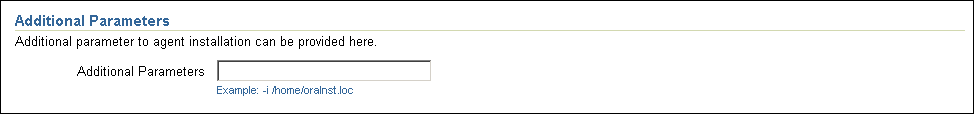

The additional parameters that you specify during the agent installation using the Agent Deploy application depend on the software source location that you have selected.
If you select the default source software location, you must specify additional parameters that are supported by the agentDownLoad script. See Table H-1 for a list of parameters supported by this script.
If you select an alternative location, you must specify additional parameters that are supported by Oracle Universal Installer (OUI). See Table H-2 for a list of parameters supported by OUI.
Also, if you cloning a Management Agent using the Agent Clone Wizard, you must specify additional parameters that are supported by OUI. See Table H-2 for a list parameters supported by OUI.
