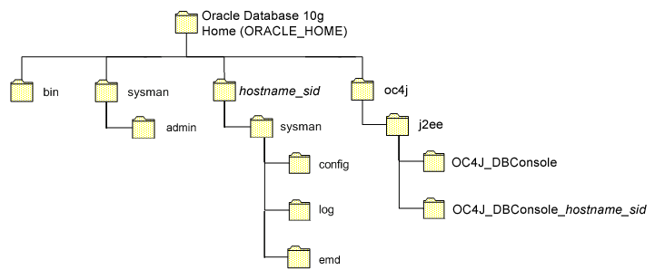

Understanding the Enterprise Manager Directories Installed with Oracle Database 10g
When you install Oracle Database 10g, you also install Oracle Enterprise Manager 10g Database Control. Database Control provides the tools you need to manage your Oracle Database 10g immediately after you install the database. As a result, the Oracle Database 10g installation procedure installs a set of Enterprise Manager directories and files into each Oracle Database 10g home directory.
In particular, the emctl commands required to control Database Console are installed into the ORACLE_HOME/bin directory.
The Management Agent and Management Service support files are installed in two locations in an Oracle Database 10g installation:
  • Files that are common and shared among all instances of the database are stored in the following directory of the Oracle Database 10g home:
    ORACLE_HOME/sysman
    For example, the administration files, which define the supported target types and the scripts used to perform Management Agent configuration tasks are stored in the ORACLE_HOME/sysman/admin directory.
  • Files that are unique to each instance of the database are stored in following directory of the Oracle Database 10g home:
    ORACLE_HOME/hostname_sid/ (for a single instance database)
    ORACLE_HOME/nodename_sid/ (for a cluster database)
    Throughout the rest of this guide, ORACLE_HOME/hostname_sid/ and ORACLE_HOME/nodename_sid/ may be used interchangeably. Both paths refer to the same concept – the Enterprise Manager directory for the specific database instance. The difference is that ORACLE_HOME/hostname_sid/ is used for single instance databases, while ORACLE_HOME/nodename_sid/ is used for cluster (Oracle RAC) databases. In cluster databases, nodename refers to the public name of the node, as specified during Cluster Ready Services (CRS) configuration for cluster environments.
    For example, if the database host name is mgmt1.example.com and the system identifier for the database instance is db42, the log files for the Management Agent and Management Service for that instance are installed in the following directory:
    ORACLE_HOME/mgmt1.example.com_db42/sysman/log
    If a hostname_sid directory does not exist in the Oracle Database 10g home directory, then Oracle Enterprise Manager 10g Database Control was never configured for the database instance.
In addition, the files required to deploy the Database Console as a J2EE application are installed into the ORACLE_HOME/oc4j/j2ee directory structure. Database Console is a J2EE application that is deployed using the standalone version of Oracle Application Server Containers for J2EE (OC4J). The OC4J_DBConsole directory contains the template files that are used to create database-specific deployment directories for each Database Console instance deployed in the Oracle home.
The installation and configuration files are stored in the ORACLE_HOME directory in the following sub-directories:
  • cfgtoollogs/cfgfw
  • cfgtoollogs/dbua
  • cfgtoollogs/netca
  • cfgtoollogs/rconfig
  • cfgtoollogs/dbca
  • cfgtoollogs/emca
  • cfgtoollogs/oui
  • cfgtoollogs/opatch
Figure 16-2 summarizes the location of the important Enterprise Manager directories in a typical Oracle Database 10g home directory. Note that references to hostname_sid are for single instance databases; cluster databases have paths of the form nodename_sid instead.
Figure 16-2 Important Enterprise Manager Directories in an Oracle Database 10g Installation
Description of Figure 16-2 follows
Description of "Figure 16-2 Important Enterprise Manager Directories in an Oracle Database 10g Installation"

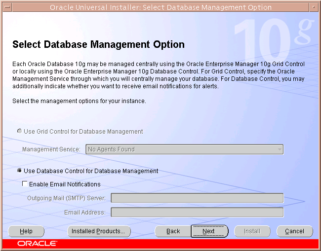

Configuring Database Console During and After the Oracle Database 10g Installation
The following sections describe how Oracle Enterprise Manager 10g Database Control is configured during the Oracle Database 10g installation. These sections also describe how you can configure Database Console after the installation:
Configuring Database Console During Installation
If you create a database while installing Oracle Database 10g, you have the option of configuring your database so it can be managed by Oracle Enterprise Manager 10g Grid Control Console or by Oracle Enterprise Manager Database Console.
Figure 16-3 shows the Management Options page, which allows you to select your database management options while installing Oracle Database 10g.
Figure 16-3 Selecting Your Management Options While Installing Oracle Database 10g
Description of Figure 16-3 follows
Description of "Figure 16-3 Selecting Your Management Options While Installing Oracle Database 10g"
To select Grid Control Console as your management option, the Oracle Management Service must be installed on a network host. In addition, the Oracle Management Agent must be installed on the host where you are installing the database. Otherwise, the Grid Control Console option is unavailable and you must instead choose to manage your database with Database Control.
For most of the Oracle Database 10g installation types, you must choose either Database Control or Grid Control as your management option when you create a database during the installation.
However, if you create a database using one of the following methods, you can choose not to configure Database Console:
  • Choosing to create a database during a custom installation
  • Choosing the Advanced database configuration option during an Enterprise or Standard Edition installation
  • Running Database Configuration Assistant (DBCA) after the installation
If you do not configure Database Console during the Oracle Database 10g installation, no hostname_sid directory is created in the resulting Oracle home directory (Figure 16-2).

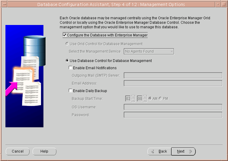

  3. Advance to the Operations page and select Configure Database Options.
  4. Advance to the Database page and select the database you want to configure.
  5. Advance to the Management Options page (Figure 16-4) and select the following options:
    • Configure the Database with Enterprise Manager
    • Use Database Control for Database Management
  6. Optionally, select the options for enabling e-mail notifications and enabling daily backups.
    For more information about Enterprise Manager notifications and daily backups, click Help on the Management Options page.
  7. Advance until the Finish button is available.
  8. Click Finish to reconfigure the database so it uses Database Console.
    After DBCA reconfigures the database, a new subdirectory appears in the Oracle home. This directory is named using the following format and contains Database Console configuration and state files specific to the database you just configured:
    hostname_sid
    For example:
    mgmthost1.example.com_myNewDB
    Note that for cluster databases, the directories are named nodename_sid.
Figure 16-4 Management Options Page in DBCA
Description of Figure 16-4 follows
Description of "Figure 16-4 Management Options Page in DBCA"
