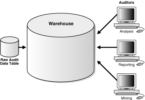

Figure 4-1 illustrates the Oracle Audit Vault audit data warehouse architecture. Audit Vault stores the audit records in the raw audit data table, which is typical of a traditional online transaction processing (OLTP) system that is optimized for insert performance for the records arriving from their audit sources.
Figure 4-1 Architecture of the Oracle Audit Vault Audit Data Warehouse
Audit records, stored in the raw audit data table go through an extraction and transformation process before the data loading process (ETL). The ETL operation takes place in the staging area. Oracle Audit Vault optimizes data in the data warehouse for data analysis, and includes the metadata and summaries that aid in these data analysis.
If you have been granted the AV_AUDITOR role, then you can directly access audit data in the audit data warehouse to analyze data, generate reports, and perform data mining. See Oracle Database Data Warehousing Guide for more information about Oracle data warehouses.

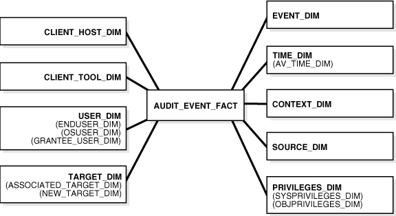

The audit data warehouse uses a logical design to model the logical relationships among the entities (tables) and their attributes (columns) as entity-relationship modeling. The audit record is the most important information, and it contains attributes or columns that describe it. Other information about the audit record is linked by foreign key to other tables that store this related information. This related information includes items such as its source information, its event information, its description of the objects in the source on which users performed actions, the client computer information from which these events originated, and the time when these events occurred. In data warehouse terminology, the audit record forms the fact table and its most important attributes form the dimension tables.
Oracle Audit Vault uses a star schema to model the audit data warehouse, as shown in Figure 4-2. The audit record is an entity (the fact table, AUDIT_EVENT_FACT) in the center of the star that is further described by its attributes (the dimensions) that form its points. A star schema optimizes performance by keeping queries simple and providing fast response time. All the information about each level is stored in one row.
Figure 4-2 Structure of the Oracle Audit Data Warehouse
The audit data warehouse involves a fact (the entity), which is an action, and dimensions (the attributes), which are details about the action. For example, a login attempt is a fact (an audit record). Who logged on, onto what system, at what time, using what authentication system, using what user name and password, and from what system are all dimensions (the attributes) about this fact. In the audit data warehouse, each fact represents an audit record and each dimension represents unique information about that audit record that further describes the audit record.
The fact table, AUDIT_EVENT_FACT, is linked to each dimension table by its foreign key. The fact table in the audit data warehouse contains the audit record ID, some attributes of the audit record for report generation, and the foreign keys to these dimensions. The main measure of the fact table is the result, whether a particular event was a success or failure.
A dimension is a structure, often composed of one or more hierarchies, that categorizes data to enable proper analysis of the data. Dimensions represent natural 1:n relationships between columns or column groups (the levels of a hierarchy) that cannot be represented with constraint conditions. Going up a level in the hierarchy is called rolling up the data, and going down a level in the hierarchy is called drilling down the data.
Level relationships specify top-to-bottom ordering of levels from most general (the root) to most specific information. They define the parent-child relationship between the levels in a hierarchy. A dimension hierarchy shows these level relationships. For example, the source dimension consists of two levels, source type and source, with the source being the child of its parent source type, as shown in Figure 4-3.
The primary key in the dimension tables is a unique identifier. Primary keys are represented with the characters PK. Foreign keys are represented by the characters FK.
The audit data warehouse includes the following dimensions:
Client Host. This dimension consists of various systems that are used by clients to perform the operation. The basic hierarchy is IP address, subnet, and domain. The CLIENT_HOST_DIM dimension table, described in Section 4.6.2, stores this information. Oracle Audit Vault populates this table dynamically, as the audit records are entered into the raw audit data table.
Client Tools. This dimension represents the information about the tools used to connect to the audit source database. The CLIENT_TOOL_DIM dimension table, described in Section 4.6.3, stores this information.
User. This dimension tracks the user information that is associated with the events occurring at the source database. There is no hierarchy associated with the user information. The USER_DIM dimension table, described in Section 4.6.10, stores this information.
Target. This dimension contains the information about the object on which the event is performed. The target is the object of the event. For example, if a user is granted a privilege, then the user becomes the target. If there is a query on the table, then the table is a target. The hierarchy is based on ownership of the target objects.
The TARGET_DIM dimension table, described in Section 4.6.8, stores this information. Oracle Audit Vault updates the TARGET_DIM table dynamically as audit records are entered into the raw audit data table. The target name is stored with the owner name appended to the target name (for example, SCOTT.EMP to represent the EMP table in the SCOTT schema).
Event. This dimension is built on the various events that can be performed in any of the source databases. Oracle Audit Vault uses a category of events to group events, and this forms the hierarchy used by this dimension. The EVENT_DIM dimension table, described in Section 4.6.5, stores this information.
Time. This dimension tracks actions over time. It is the most common use of the Oracle Audit Vault data warehouse. The hierarchy for time is based on calendar year.
The TIME_DIM dimension table, described in Section 4.6.9, stores this information. The time dimension tracks event time as well as for the time when the record was received into the raw audit data table. The granularity of the time dimension is one day, and the actual time of the event and recording of the event are stored as measures in the fact table. Oracle Audit Vault uses this time measurement to filter events to granularity smaller than a day.
Context. This dimension is used to represent the context information related to the audit event. This dimension has three levels: sub_context, context, and parent_context. You can use these levels to group events based on the context during analysis. The CONTEXT_DIM dimension table, described in Section 4.6.4, stores this information.
Source. This dimension consists of the list of source databases that send audit data to the data warehouse. The SOURCE_DIM dimension table, described in Section 4.6.7, stores this information.
Privileges. This dimension represents the information about the privileges used during the event. There is no hierarchy for this dimension. The PRIVILEGES_DIM dimension table, described in Section 4.6.6, stores this information.

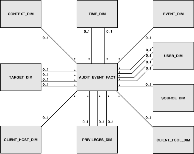

Figure 4-4 shows the relationships between the tables of the Oracle Audit Vault data warehouse.
Figure 4-4 Tables in the Oracle Audit Vault Data Warehouse
Table 4-3 through Table 4-12 contain information about the individual tables, including their columns, the data types for those columns, and whether the columns are allowed to be null. When the column is actually a reference to a dimension table, the referenced table is also listed. The asterisk and 0...1 show a one-to-many relationship that exists between the fact table and the dimension table.
