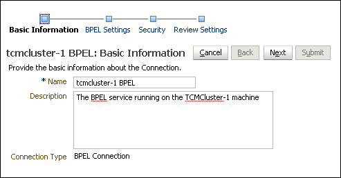

Create and modify connections to a BPEL server by expanding the Manage Connections panel in the Navigator Pane. Click the Create New Connection icon or click an existing connection and click Modify to display the BPEL Connection Basic Information page.
The following table describes the elements available on the page.
| Element | Description |
| Name | Provide a unique name for this connection. |
| Description | A brief description of the connection. |
| Connection Type | Identifies the type of connection. |
