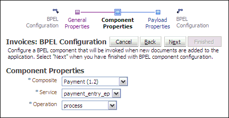

A.29 BPEL Component Properties Page
Select from the Composite, Service, and Operation fields to identify the BPEL process you want to initiate.
Access the Create Application BPEL Component Properties page by clicking Next on the Application BPEL Configuration Page or clicking Modify on an existing Application BPEL Configuration Component Properties page.
Surrounding text describes bpel_comp_prop.gif.
The following table describes the elements available on the page.
Element Description
Composite Select the name and version of a deployed BPEL composite. This is a required value.
Service Select the name of a service associated with the selected composite. This is a required value.
Operation Select the name of an operation associated with the selected service. This is a required value.
