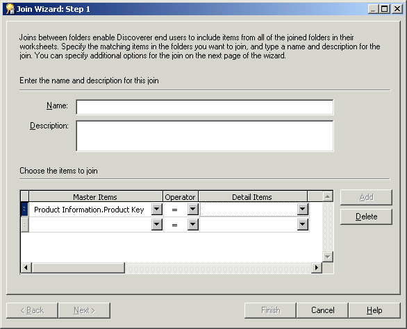

When you create a join using Discoverer Administrator, you specify a join condition that identifies the item in the master folder and the matching item in the detail folder. It is important to make sure you:
Define the join with the correct folder as the master. If a query uses two or more folders and you define the incorrect folder as the master, you might get misleading or incorrect results (for more information, see "What are fan traps, and how does Discoverer handle them?").
Choose the correct join option details. These details also determine whether summary folders can be used to speed up queries (for more information, see "What effect do joins have on query results and query performance?").

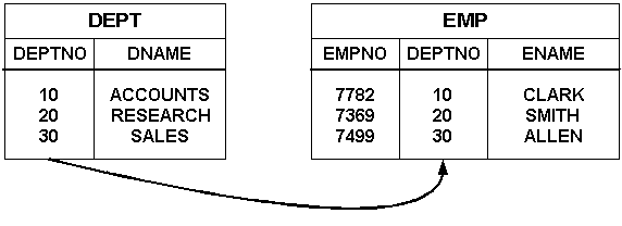

In Discoverer, a single item join relates two folders by specifying an item that is common to both folders in a join condition. A join condition is the combination of two join items related by a join operator. Typically, the join operator is the equals (=) sign and the join is therefore referred to as an equi-join (for more information about alternative join operators, see "What are non-equi-joins?").
For example, the schema below uses the common column DEPTNO to join the DEPT and EMP tables.
Every department in the DEPT table has a department name and a department number. Every employee in the EMP table has a name and belongs to a department (which is identified by its department number). To see the name of an employee and the name of the department in which they work, you need information from both the EMP table and the DEPT table.
Imagine that a Discoverer end user wants to see the name of every employee and the name of the department in which they work, as follows:
| DNAME | ENAME |
| ACCOUNTS | CLARK |
| ACCOUNTS | MILLER |
| RESEARCH | ADAMS |
| RESEARCH | FORD |
| SALES | JAMES |
In other words, DEPT.DNAME and EMP.ENAME.
The following SQL statement would achieve the required result:
select dname, ename from dept, emp where dept.deptno=emp.deptno
To enable the Discoverer end user to see the required result, you can do either of the following:
You can create a custom folder containing the above SQL statement (for more information, see "How to create custom folders").
You can create a join with one join condition (that is, a single item join) between DEPT.DEPTNO and EMP.DEPTNO (for more information, see "How to create joins").
Having defined the join:
In Discoverer Administrator you can create a complex folder, then drag DNAME from DEPT and ENAME from EMP into the complex folder (for more information, see "How to create complex folders").
The Discoverer end user can use the complex folder. Alternatively, the end user can select DNAME from DEPT and ENAME from EMP.

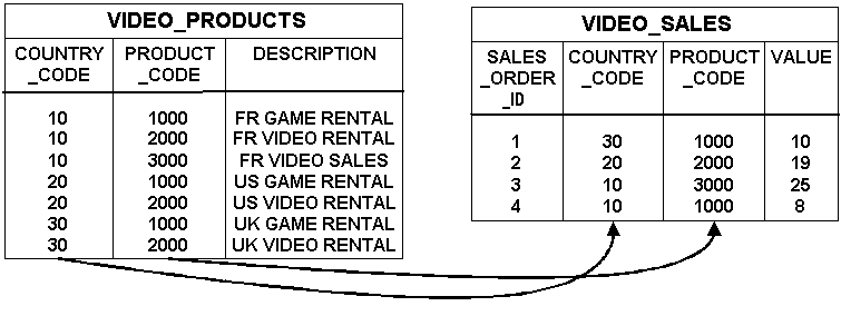

In Discoverer, a multi-item join relates two folders using more than one join condition, such that the join becomes true when all of the join conditions are met (for more information about join conditions, see "What are single item joins?").
For example, the schema below uses a combination of COUNTRY_CODE and PRODUCT_CODE to uniquely identify products.
Every product in the VIDEO_PRODUCTS table has a description and is uniquely identified by the combination of a country code and a product code (note that product codes are only unique within each country code). Every sale in the VIDEO_SALES table is of a particular product (which is identified by its country code and product code). To see the value of a sale and a description of the product that was sold, you need information from both the VIDEO_SALES table and the VIDEO_PRODUCTS table.
Imagine that a Discoverer end user wants to see the value of each sale and a description of the product that was sold, as follows:
| Description | Value |
| UK GAME RENTAL | 10 |
| US VIDEO RENTAL | 19 |
| FR VIDEO SALES | 25 |
| FR GAME RENTAL | 8 |
In other words, VIDEO_PRODUCTS.DESCRIPTION and VIDEO_SALES.VALUE.
select description, value from video_products, video_sales where video_products.country_code=video_sales.country_code and video_products.product_code=video_sales.product_code
You can create a join with two join conditions (that is, a multi-item join) between VIDEO_PRODUCTS.COUNTRY_CODE and VIDEO_SALES.COUNTRY_CODE, and between VIDEO_PRODUCTS.PRODUCT_CODE and VIDEO_SALES.PRODUCT_CODE (for more information, see "How to create joins").
Having defined the multi-item join:
In Discoverer Administrator you can create a complex folder, then drag DESCRIPTION from VIDEO_PRODUCTS and VALUE from VIDEO_SALES into the complex folder (for more information, see "How to create complex folders").
The Discoverer end user can use the complex folder. Alternatively, the end user can select DESCRIPTION from VIDEO_PRODUCTS and VALUE from VIDEO_SALES.

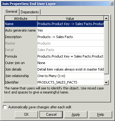

In some circumstances, you will always want Discoverer to use a join when querying a master folder and a detail folder. For example:
you might want a query to return values from both the master folder and the detail folder
you might want a query to return only those rows from the detail folder that have matching values in the master folder
Resolving joins is relatively time-consuming, so returning results from such a query might be relatively slow.
In other circumstances, it will not be necessary for Discoverer to query the master folder and the detail folder. For example:
if you know that values in the detail folder always have corresponding values in the master folder
if you know that you will always want the query to return all of the detailed values from the detail folder regardless of whether values exist in the master folder
If you set the appropriate option to indicate that Discoverer does not need to query the master folder, query performance will improve. However, be aware that not querying the master table might give you unexpected results. If you are not sure whether to include the master folder, see "Examples of how joins can affect query results from complex folders".
If you combine two or more folders in a complex folder (by using a join), Discoverer can improve query performance by detecting and removing joins that are not required (a process known as join trimming). If the SQLJoinTrim Discoverer registry setting is enabled (that is, if it is set to the default value of 1), Discoverer will remove joins from a query when both of the following conditions are met:
if Discoverer can return the requested rows without using the join
if you select the Detail item values always exist in master folder option for the join (for more information, see "Examples of how joins can affect query results from complex folders")
For more information about Discoverer registry settings, see Chapter 21, "Discoverer Registry Settings".
Discoverer will never use a summary folder to satisfy a query that uses a join with the Detail item values might not exist in master folder option selected (for more information, see the "Edit Join dialog: Options tab").

Outer joins are SQL constructs that enable you to return rows from one table when there are no matching rows in a table to which it is joined.
Consider the following scenario:
the master table DEPT contains rows for department 10 (ACCOUNTS), department 20 (RESEARCH) and department 40 (OPERATIONS)
the detail table EMP contains rows for Clark (department 10), Smith (department 20) and Allen (a former employee of department 30, which no longer exists)
Figure 10-10 Master and detail tables DEPT and EMP, where the rows returned are determined by the position of the outer join construct in the query
The following examples use the schema in the above figure to illustrate how the position of the outer join determines the rows returned from a query.
Example 1 - Outer join placed on the master table
Imagine that a Discoverer end user wants to see all employee records, even when an employee does not belong to a department. The required results are as follows:
| DNAME | ENAME |
| ACCOUNTS | CLARK |
| RESEARCH | SMITH |
| <NULL> | ALLEN |
select dname, ename from dept, emp where dept.deptno(+)=emp.deptno
When the outer join is placed on the master table, the database returns each detail row for which there is no matching master row, and all matching detail and master rows. In the SQL statement, the plus (+) symbol signifies the outer join.
You can create a join with a single join condition between DEPT.DEPTNO and EMP.DEPTNO and select both the Detail items might not exist in the master folder option and the Outer join on master option in the "Edit Join dialog: Options tab" (for more information about creating joins, see "How to create joins").
Example 2 - Outer join placed on the detail table
Imagine that a Discoverer end user wants to see all department records even when a department does not have any employees. The required results are as follows:
| DNAME | ENAME |
| ACCOUNTS | CLARK |
| RESEARCH | SMITH |
| OPERATIONS | <NULL> |
select dname, ename from dept, emp where dept.deptno=emp.deptno(+)
When the outer join is placed on the detail table, the database returns each master row for which there is no matching detail row, and all matching master and detail rows. In the SQL statement, the plus (+) symbol signifies the outer join.
You can create a join with a single join condition between DEPT.DEPTNO and EMP.DEPTNO and select Outer join on detail in the "Edit Join dialog: Options tab" (for more information about creating joins, see "How to create joins").
You create a join to enable end users to include items from different folders in the same worksheet.
To create a join:
Display the "Workarea: Data tab" and select the item in the master folder that will match an item in the detail folder.
Tip: For more information about which is the master and detail folder, see "What are joins?".
Choose Insert | Join to display the "Join Wizard: Step 1 dialog".
The master item is displayed in the Master Items field.
Tip: If you want to change the folder and item in the Master Items field, choose the More items option at the bottom of the drop down list.
Click the Operator down arrow and select a join operator from the drop down list to specify the join type.
Click the Detail Items down arrow to display the "New Join dialog".
Select the folder and the detail item for the join.
You can choose a detail item from a folder in the same business area or in any other open business area.
By specifying a master item, a detail item, and a join operator, you have created a join condition. Joins that have only one join condition are referred to as single-item joins (for more information, see "What are single item joins?").
Tip: If you want to change the folder and item in the Detail Items field, choose the More items option at the bottom of the drop down list.
In some circumstances, you will need to create more than one join condition (for more information, see "What are multi-item joins?").
(optional) To create a multi-item join:
Click Add to display a new row for a new join condition.
Use the drop down lists for Master Items and Detail Items to select a new pair of items from the same master and detail folders as the previous join condition.
Note: If you specify a master or detail item from a folder that was not included in the previous join condition, the previous join condition is removed.
Add new join conditions until you have specified all the matching items in the master folder and the detail folder.
Click Next to display the "Join Wizard: Step 2 dialog".
Select the join details for this join as follows:
Detail item values always exist in the master folder (Typical)
Select this option to improve query performance (for more information, see "What effect do joins have on query results and query performance?").
Detail item values might not exist in the master folder
Select this option if you cannot be sure that all the values in the detail folder have matching values in the master folder. Note that selecting this option might return unexpected results (for more information, see "What effect do joins have on query results and query performance?").
(optional) Select any of the following options for this join, as required:
No outer joins
Select this option to not create any outer joins, and display all matching master and detail rows.
Select this option to display master rows that have no corresponding detail items, and all matching master and detail rows.
Select this option to display detail rows that have no corresponding master, and all matching detail and master rows. This check box is only available if the Detail item values might not exist in the master folder option is selected.
One to one relationship between master and detail
Select this check box to specify that there is a one to one relationship between master and detail tables.
Note: Clear this check box if you are creating an outer join.
For more information about the above options, see:
Click Finish to save the changes and close the dialog.

You can view or edit a join using either or both of the following methods:
using the "Edit Join dialog: Items tab" and "Edit Join dialog: Options tab" to:
view and edit join items
add and remove join items
edit the join name and description
view and edit join options
using the "Join Properties dialog" to:
view and edit join properties for one or more joins
view dependent objects for one or more joins
Both methods are described below.
How to edit a join using the Edit Join dialog
You might want to edit a join using the Edit Join dialog.
To edit a join using the Edit Join dialog:
Select a join on the "Workarea: Data tab" and choose Edit | Edit... to display the "Edit Join dialog: Items tab".
Edit the join name, description, and join conditions as required.
Display the "Edit Join dialog: Options tab".
Edit the join options as required.
Click OK to save any changes you have made and close the dialog.
To view or edit join properties using the Join Properties dialog:
How to edit a join using the Join Properties dialog
You might want to edit a join using the Join Properties dialog.
Select a join on the "Workarea: Data tab" and choose Edit | Properties to display the "Join Properties dialog".
Tip: You can select more than one join at a time by holding down the Ctrl key and clicking another join. All properties that are common to each selected join are displayed. If the value of a property is not common to all of the selected joins, the Value field is blank.
Make changes as required.
Click OK to save any changes you have made and close the Join Properties dialog.

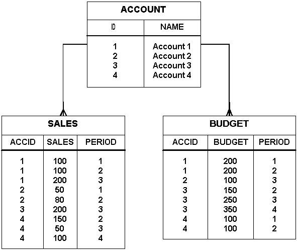

A fan trap is a group of joined database tables that might return unexpected results. The most common manifestation of a fan trap occurs when a master table is joined to two or more detail tables independently.
Although this construction is relationally correct, you are likely to return incorrect results if you use a straightforward SQL statement to aggregate data points.
However, if you use Discoverer to aggregate the data points, Discoverer will never return incorrect results, provided fan trap detection is enabled. Every query that Discoverer generates is interrogated for potential fan traps. If a fan trap is detected, Discoverer can usually rewrite the query using inline views to ensure the aggregation is done at the correct level. Discoverer creates an inline view for each master-detail aggregation, and then combines the results of the outer query.
For an example of how Discoverer will return correct results when a straightforward SQL statement will return incorrect results, see "Example of a fan trap".
In some circumstances, Discoverer will detect a query that involves an unresolvable fan trap schema, as follows:
if the detail folders use different keys from the master for the join
if there is a direct join relationship between the detail folders (thereby creating an ambiguous circular relationship)
if non-aggregated values are chosen from more than one of the detail folders
if more than one detail folder has a separate join relationship to a different master folder
In the above circumstances, Discoverer disallows the query and displays an error message.
In addition, Discoverer controls which columns can be totalled. If a worksheet displays values of items from both the master folder and the detail folder, Discoverer will not total the values together. Instead, Discoverer will display a null to prevent incorrect or unexpected results.
For more information about enabling or disabling fan trap detection in Discoverer, see the Oracle Fusion Middleware User's Guide for Oracle Business Intelligence Discoverer Plus.
Consider an example fan trap schema that includes a master folder (ACCOUNT) and two detail folders (SALES and BUDGET), as shown below:
Every account can have several sales figures and several budget figures for each period.
Imagine that a Discoverer end user wants to answer the question, "What is the total sales and total budget by account?". The aggregates (SUM) from the two detail tables come from the same master table (ACCOUNT).
This relatively simply query will produce:
correct results if you use Discoverer (provided fan trap detection is enabled)
Producing correct results using Discoverer
To answer the question, "What is the total sales and total budget by account?", Discoverer:
selects the name of the account (from ACCOUNT.NAME)
calculates the sum of SALES (from SALES.SALES)
calculates the sum of BUDGET (from BUDGET.BUDGET)
Discoverer returns correct results, as shown below:
| Account | Sales | Budget |
| Account 1 | 400 | 400 |
| Account 2 | 130 | 100 |
| Account 3 | 200 | 750 |
| Account 4 | 300 | 200 |
Discoverer interrogates the query, detects a fan trap, and rewrites the query to ensure the aggregation is done at the correct level. Discoverer rewrites the query using inline views, one for each master-detail aggregation, and then combines the results of the outer query.
The following example shows the SQL that Discoverer uses to return the correct results:
SELECT inACC as Name, SUM(inSalesSum) as SALES_SUM, ,SUM(inBudgetSum) as BUDGET__SUM, FROM
(SELECT masterID AS OutMasterIDSales, SUM(SalesDetailsSales) AS inSalesSum FROM (SELECT ID AS masterID, NAME AS masterName FROM ACCOUNT) INLineAccount, (SELECT ID AS SalesDetailId, ACCID AS SalesDetailAccID, SALES AS SalesDetailsSales FROM SALES )INLineSales
WHERE(masterID = SalesDetailAccID(+)) GROUP BY masterID) inner1, (SELECT masterID AS OutMasterIDBudget, SUM(BudgetDetailBudget) AS inBudgetSum, masterName AS inACC FROM
(SELECT ID AS masterID, NAME AS masterName FROM ACCOUNT) INLineAccount, (SELECT ID AS BudgetDetailId, ACCID AS BudgetDetailAccID, BUDGET AS BudgetDetailsSales FROM BUDGET )INLineBudget
WHERE(masterID = BudgetDetailAccID(+)) GROUP BY masterName, masterID ) inner2 WHERE ((OutMasterIDBudget = OutMasterIDSales)) GROUP BY inACC
The result is correct because each sale and each budget is summed individually (one for each master-detail aggregation) and is then combined with a join based on the master key(s).
Producing incorrect results using a straightforward SQL statement
To answer the question, "What is the total sales and total budget by account?", you might consider using a staightforward SQL statement such as the following:
SELECT Account.Name, SUM(sales), SUM(budget) FROM Account, Sales, Budget Where Account.id=Sales.accid AND Account.id=Budget.accid GROUP BY Account.Name
This straightforward SQL statement returns incorrect results, as shown below:
| Account 1 | 800 | 1200 |
| Account 2 | 130 | 200 |
| Account 3 | 600 | 750 |
| Account 4 | 600 | 600 |
Although the results are relationally correct, they are obviously wrong. For example, the results indicate that the total sales figure for Account 1 is 800 but you can see from the SALES table that the total sales figure for Account 1 is 400 (that is, 100+100+200).
The incorrect results are based on a single query in which the tables are first joined together in a temporary table, and then the aggregation is performed. However, this approach causes the aggregates to be summed (incorrectly) multiple times.
Discoverer warns about fan trap join configurations in complex folders by displaying a message indicating that an invalid join configuration exists. To make sure that Discoverer returns correct results for complex folders, you can edit the Formula property of the detail item and explicitly specify the aggregate formula.
Click the Detail Items drop down list to display the "New Join dialog".
The New Join dialog enables you to select the detail folder and item for the new join.
Click the + symbol next to the Store and Sales Details folder to expand the folder's items.
Select the Transaction Date item and click OK to close the New Join dialog.
Click Finish to accept the default join options and close the Join Wizard: Step 2 dialog.
