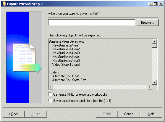

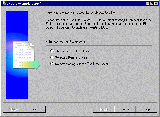

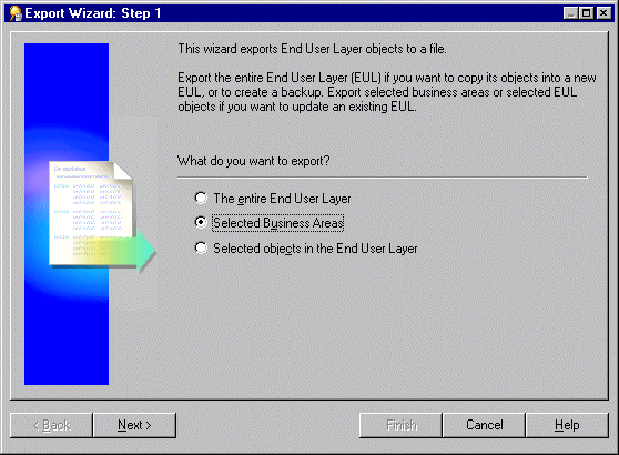

"How to export the entire EUL using the Discoverer Export Wizard"

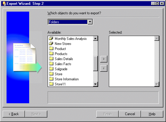

"How to export selected business areas using the Export Wizard"
"How to export selected EUL objects using the Export Wizard"

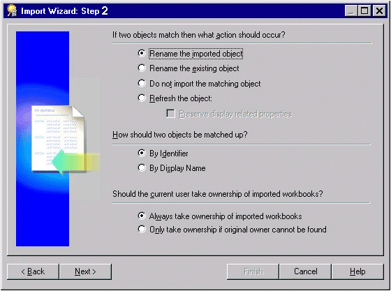

"How to import EUL objects from a file using the Import Wizard"

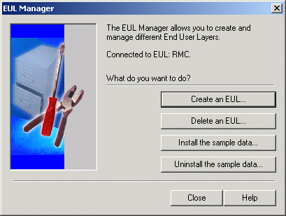

The EUL Manager dialog enables you to create or delete the set of tables that make up an EUL.

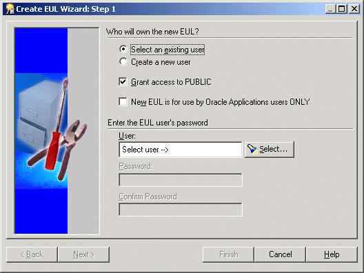

To create an EUL for an existing database user:
Choose Tools | EUL Manager to display the "EUL Manager dialog".
Click Create an EUL to display the "Create EUL Wizard dialog".
Select the Select an existing user option.
Select or clear the Grant access to PUBLIC check box as required:
select this check box to enable all users in the current database to access the new EUL
clear this check box to enable only the EUL owner to view data through the new EUL
Note: It is recommended that you clear this check box where security might be an issue.
Select or clear the New EUL is for use by Oracle Applications users ONLY check box as required:
select this check box to restrict the new EUL to Oracle Applications users only (for more information about Applications Mode EULs, see Chapter 17, "Using Discoverer with Oracle Applications")
clear this check box to create a standard EUL
Note: The choice that you make here is final. You cannot change a standard EUL into an Oracle Applications EUL (and vice versa).
Click the Select button to display the "Select User/Role dialog" where you search for, and select, the database user that you want to own the new EUL.
If you specified a database user other than the current user to be the EUL owner, you must specify the database user's password.
Passwords are case-sensitive in Oracle databases (Enterprise Edition release 11.1 or later).
Click Finish.
Discoverer Administrator displays the Creating EUL progress bar and creates a new EUL for the specified database user.

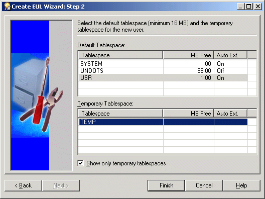

Specify the default and temporary tablespaces for the new database user.
If you are unsure which to choose, see your database administrator. For more information, see the "Create EUL Wizard: Step 2 dialog".

To export the entire EUL using the Discoverer Export Wizard:
Choose File | Export to display the "Export Wizard Step 1 dialog".
Select the The entire End User Layer option and click Next to display the "Export Wizard: Step 2/3 dialog".

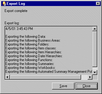

Click Finish to create the export file (and any additional files selected) in the specified location and display the Export Log.
The Export Log displays information about what has been exported.
(optional) Click Save to specify a name and location to save the Log file.
Click Close to finish.
Use this option when you want to use the export file to update an existing EUL with selected business areas.
To export the selected business areas using the Export Wizard:
Select the Selected business areas option and click Next to display the "Export Wizard: Step 2 dialog (to export selected business areas)".
Move the business areas that you want to export from the Available list to the Selected list.
You can select more than one business area at a time by holding down the Ctrl key and clicking another business area.
Click Next to display the "Export Wizard: Step 2/3 dialog".
Click Browse to display the Save As dialog.
Browse for the location to save the business area export file.
Enter a suitable name for the exported business area.
(optional) Select the Generate XML for exported workbooks check box to save any workbook definitions in XML format.
(optional) Select the Save export commands as a text file (*.txt) check box to save the export commands that created this export to a text file.
This creates an additional text file containing the commands used to create this export and applies the file extension txt. This file can then be used with the command-line interface (for further information about the command-line interface, see Chapter 22, "Discoverer Command-line Interface").

To export the selected objects using the Export Wizard:
Select the Selected Objects in the End User Layer option and click Next to display the"Export Wizard: Step 2 dialog (to export selected objects)".
Use the Which objects do you want to export? drop down list to display the EUL object types that you want to export to a file.
For example, folders, item classes and item hierarchies.
Note: If you select a business area above, Discoverer exports just the definition of the business area and not its folders and items. To export business area folders and items, you must select them explicitly.
Move the object that you want to export from the Available list to the Selected list.
You can select more than one object at a time by holding down the Ctrl key and clicking another object.
Click Next to display the "Export Wizard: Step 2 dialog (to export selected business areas)".

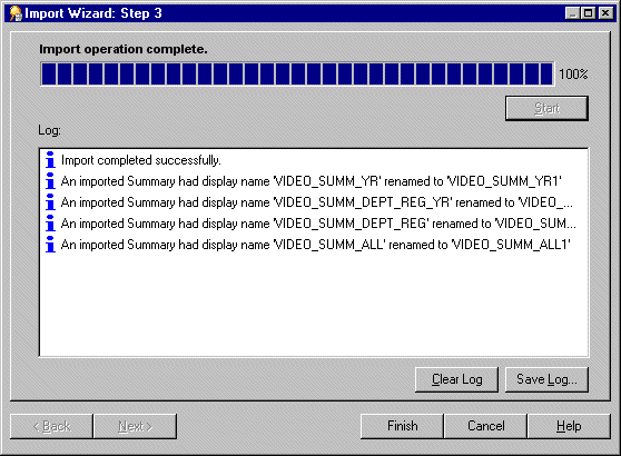

To import EUL objects from a file using the Import Wizard:
Choose File | Import to display the "Import Wizard: Step 1 dialog".
Click Add to display the Open dialog.
Locate and select one or more import files and click Open to return to the "Import Wizard: Step 1 dialog".
Selected files appear in the Import File list.
Click Next to display the "Import Wizard: Step 2 dialog".
This dialog enables you to specify how Discoverer Administrator processes matching objects from another EUL. For more information about matching objects from another EUL, see "What are identifiers?".
Specify what action should occur if two objects match.
An object means any EUL object, for example, folder, item, calculated item.
Specify whether to preserve display related properties (only available if the Refresh the object option is selected).
Specify how you would like objects to be matched up.
Specify whether the current user should take ownership of imported workbooks.
Click Next to display the "Import Wizard: Step 3 dialog,".
This dialog enables you to start the import and monitor its status as each EUL object is processed.
Click Start to begin the import.
Tip: You can stop the import at any point by clicking Cancel. For example, you might want to stop the import if there are warning messages in the Import Log.
(optional) After a completed import, click Save log... to save the status information to a text file in a specified location.
Click Finish to close the "Import Wizard: Step 3 dialog,".

The minimum default tablespace of 3MB suggested in the "Create EUL Wizard: Step 2 dialog" is based upon storage parameters that the EUL specifies when creating database objects for the EUL. If you install the tutorial, the figure of 3MB will be exceeded.
A newly created EUL has the following space requirements:
approximately 2.8MB without tutorial data
approximately 3.8MB with tutorial data
The amount of space that is actually used will depend on other factors, including the block size specified for the tablespace in which the EUL is created.
As an approximate guide, adding a typical business area to an EUL will increase the size of the EUL by 1MB. The more complicated the business area (for example, the more summary folders and complex items it contains), the more space the business area will require.
A default tablespace of 10-20MB will be adequate under normal conditions, but the amount of default tablespace required is determined by the amount of metadata that defines your EUL. Therefore, the default tablespace required could be larger, or smaller than the amount available in the tablespace that you select.
