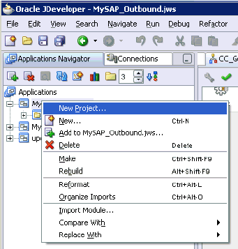

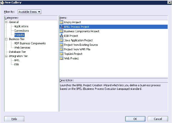

  2. Click the Application Navigator tab and select New Project from the context menu.
    The New Gallery dialog is displayed.
    New Gallery dialog
  3. Select the BPEL Process Project and then click OK.

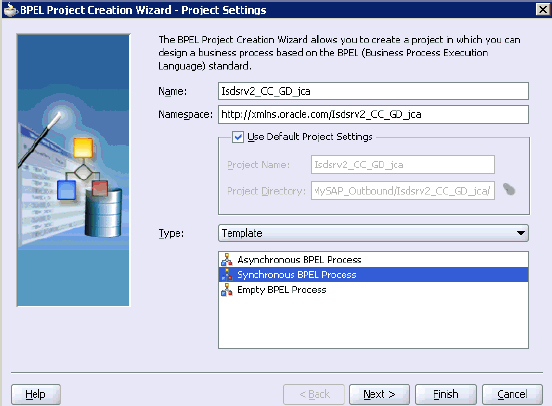

  4. Enter a name for the new BPEL process project in the Name field.
  5. Select Synchronous BPEL Process from the Template Type list and click Next.

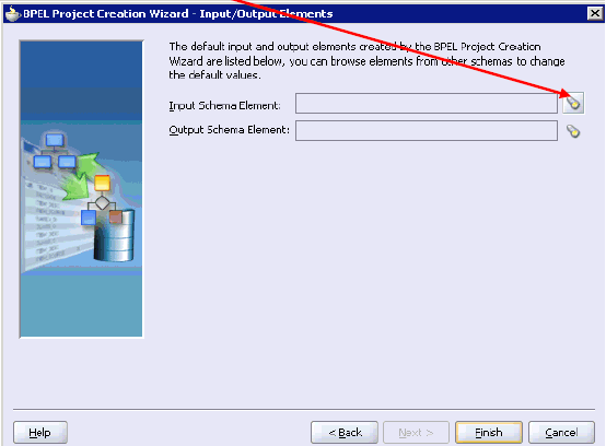

    The BPEL Project Creation Wizard - I/O Elements page is displayed.
    Input/Output Elements page

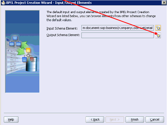

  6. Click the Browse icon to the right of the Input Schema Element field.
    The Select Schema dialog is displayed.

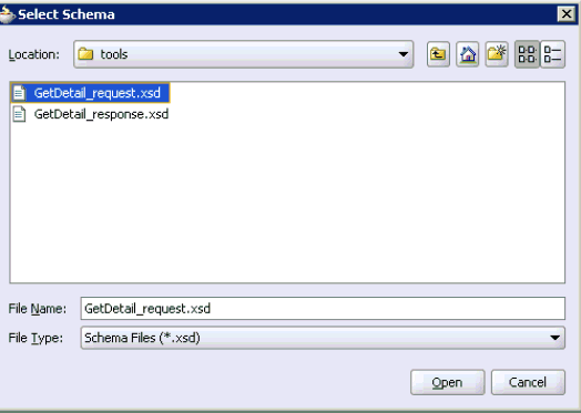

  7. Navigate to the default exported schema location:
    <soadp1>\adapters\application\tools
  8. Select the request XML schema file (.xsd) for the corresponding business object and click Open.

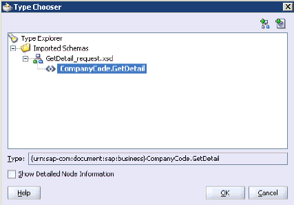

    The Type Chooser dialog is displayed.
    Type Chooser dialog
  9. Expand Imported Schemas, the request XML schema (for example, GetDetail_request.xsd), and then the method (for example, CompanyCode.GetDetail).
  10. Click OK.

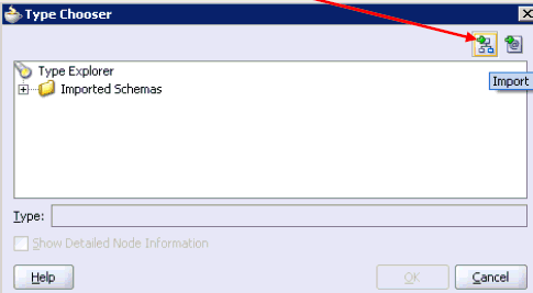

  11. Click the Browse icon to the right of the Output Schema Element field.
    Type Chooser dialog

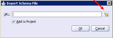

  12. Click the Import Schema icon.
    The Import Schema File dialog is displayed.

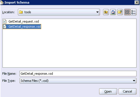

  13. Click the Browse icon.
    The Import Schema dialog is displayed.
  14. Navigate to the default exported schema location:

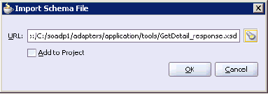

  15. Select the response XML schema file (.xsd) for the corresponding business object and click Open.
    You are returned to the Import Schema File dialog.
  16. Uncheck the Add to Project option.
  17. Click OK.

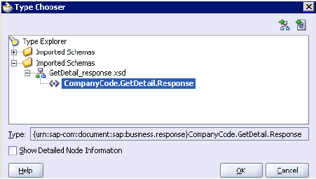

    Type Chooser dialog

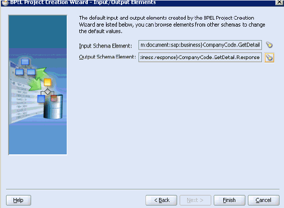

  18. Expand Imported Schemas, the response XML schema (for example, GetDetail_response.xsd), and then the method (for example, CompanyCode.GetDetail.Response).
  19. Click OK.
    You are returned to the BPEL Project Creation Wizard - I/O Elements page.
  20. Click Finish.

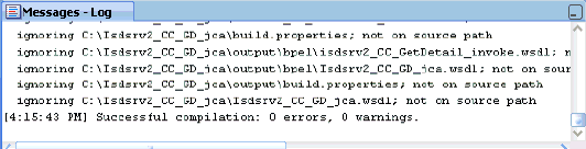

  22. Compile the outbound BPEL process project.
    Messages tab
  23. Verify that there are no error or warning messages during compilation.

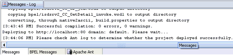

  24. Deploy the outbound BPEL process project.
  25. After the deployment is successful, go to the BPEL console and execute the deployed process.
    A successful response is received.

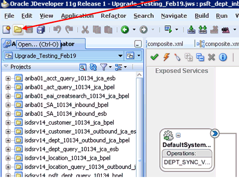

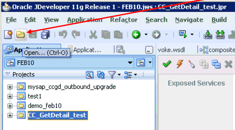

  1. Start Oracle JDeveloper 11g.
    Open icon

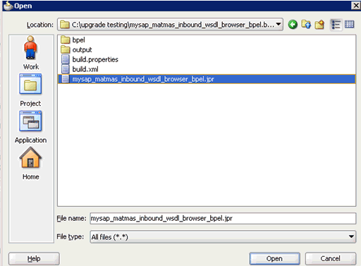

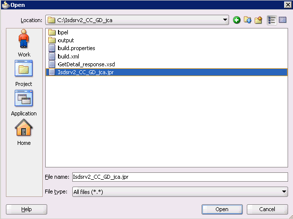

  2. Select an available application (for example, FEB10) and click Open from the tool bar.
    The Open dialog is displayed.
    Open dialog
  3. Open the 10.1.3.x project (for example, Isdsrv2_CC_GD_jca) and select the .jpr extension file (for example, Isdsrv2_CC_GD_jca.jpr).
  4. Click Open.

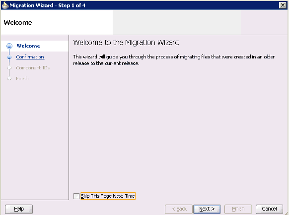

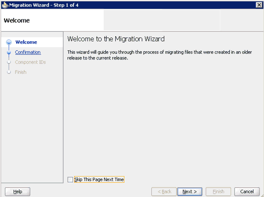

    The Migration Wizard is displayed.
    Migration Wizard
  5. Click Next.

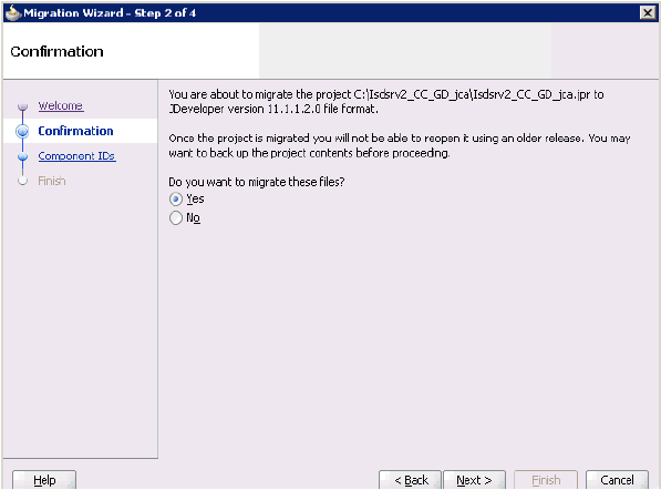

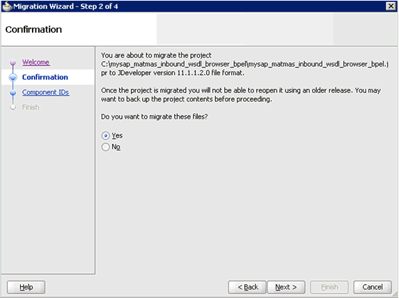

    The Confirmation page is displayed.
    Confirmation page
  6. Verify that Yes is selected (default) and click Next.

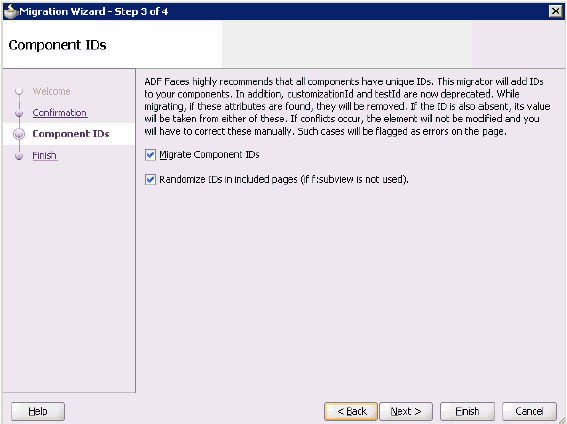

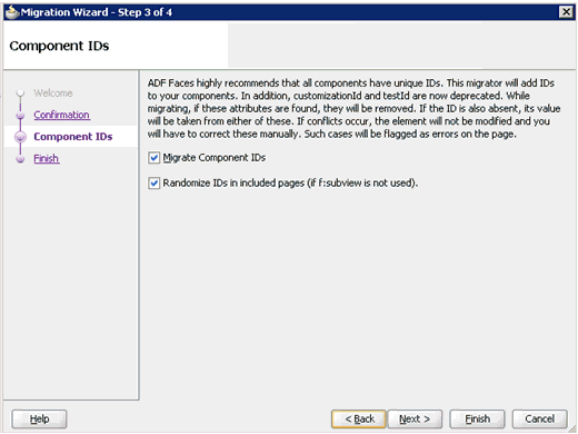

    The Component IDs page is displayed.
    Component IDs page
  7. Accept the default values and click Next.

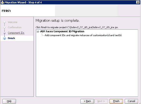

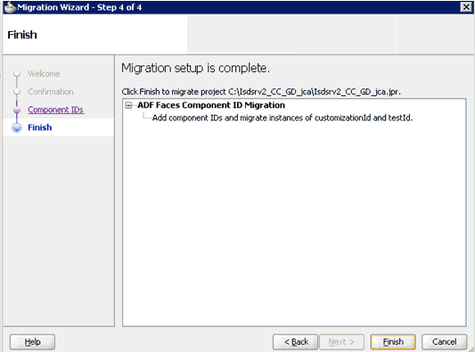

    The Finish page is displayed.
    Finish page

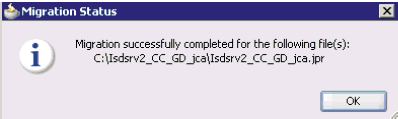

  8. Click Finish.
    The following message is displayed.
    Migration Status message
  9. Click OK.

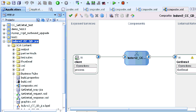

    The 10.1.3.x project is now available in your 11g environment.

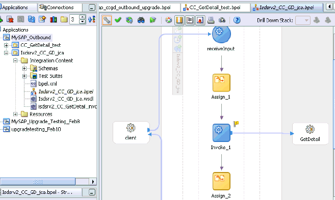

    migrated BPEL project
  10. Expand the migrated project in the left page (for example, Isdsrv2_CC_GD_jca) and double-click the composite.xml file to verify that the project opens without any errors.
  11. Click Save.

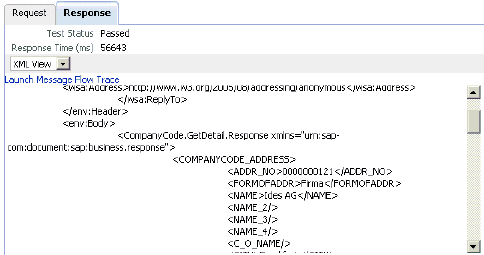

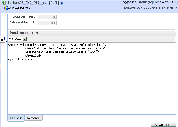

  14. After the deployment is successful, go to the Oracle Enterprise Manager console and execute the deployed process either in Tree View or XML View and get the successful response.
    Input XML in XML View
    Input XML
    Output XML that is received
    Output XML

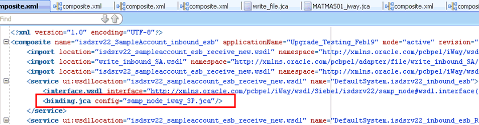

Post-Upgrade Requirement

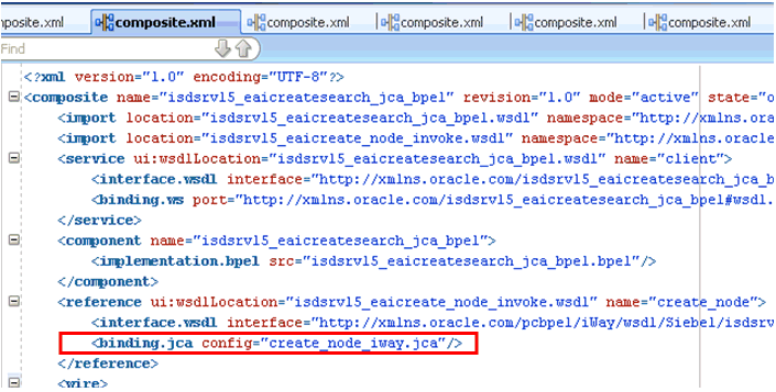

The following changes must be made for every outbound ESB and BPEL process after the corresponding project is migrated to 11g.
  1. Expand the migrated project and double-click the composite.xml file.
  2. Click source.
  3. Navigate to the reference section, check for the .jca file that has the naming convention as xxxx_iway.jca and replace with xxxx_iway_3P.jca (adding _3P as a suffix).
    Original:
    <reference ui:wsdlLocation="isdsrv15_eaicreate_node_invoke.wsdl" name="create_node"><interface.wsdl interface="http://xmlns.oracle.com/pcbpel/iWay/wsdl/Siebel/isdsrv15/create_node#wsdl.interface(create_nodePortType)" xmlns:ns="http://xmlns.oracle.com/sca/1.0"/><binding.jca config="create_node_iway.jca"/></reference>
    Modified:
    <reference ui:wsdlLocation="isdsrv15_eaicreate_node_invoke.wsdl" name="create_node"><interface.wsdl interface="http://xmlns.oracle.com/pcbpel/iWay/wsdl/Siebel/isdsrv15/create_node#wsdl.interface(create_nodePortType)" xmlns:ns="http://xmlns.oracle.com/sca/1.0"/><binding.jca config="create_node_iway_3P.jca"/></reference>
    JCA Properties Source
  4. Open the project folder and rename the same .jca properties file by adding _3P as a suffix in the .jca file (for example, create_node_iway_3P.jca).

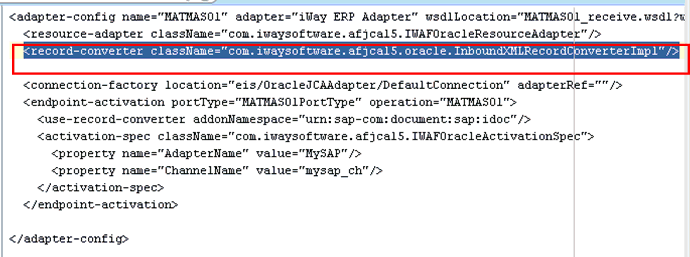

  5. Remove the following line from the JCA properties file in the migrated project and deploy it successfully:
    <record-converter className="com.iwaysoftware.afjca15.oracle.InboundXMLRecordConverterImpl"/>
  6. Trigger the event messages from the ERP system (for example, SAP GUI) and ensure that successful instances are received in the Oracle Enterprise Manager console.

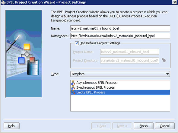

    The BPEL Project Creation Wizard - Project Settings page is displayed.
  5. Select Empty BPEL Process from the Template Type list and click Finish.
    completed process

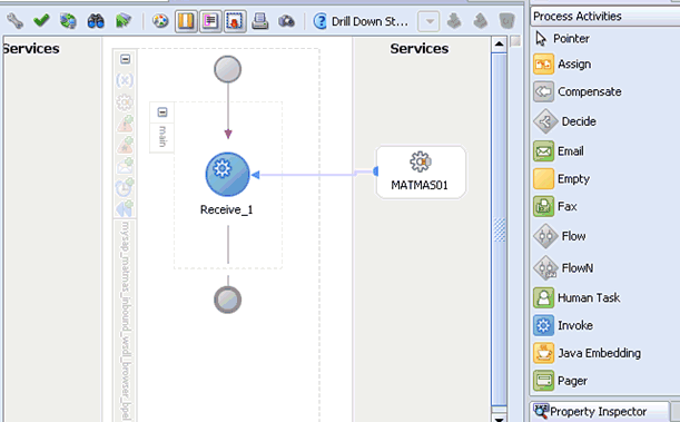

  6. Continue with the creation of a standard BPEL inbound process using Partnerlink and Receive components.

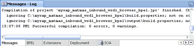

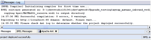

  7. Compile the inbound BPEL process project.
    Messages tab
  8. Verify that there are no error or warning messages during compilation.
  9. Deploy the inbound BPEL process project.

  2. Select an available application and click Open from the tool bar.
    Open dialog
  3. Open the 10.1.3.x project and select the .jpr extension file (for example, mysap_matmas_inbound_wsdl_browser_bpel.jpr).
  4. Click Open.
    Migration Wizard
  5. Click Next.
    Confirmation page
    Component IDs page
    Finish page

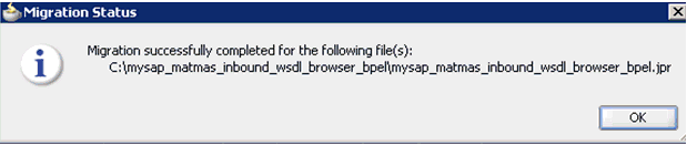

  8. Click Finish.
  9. Click OK.

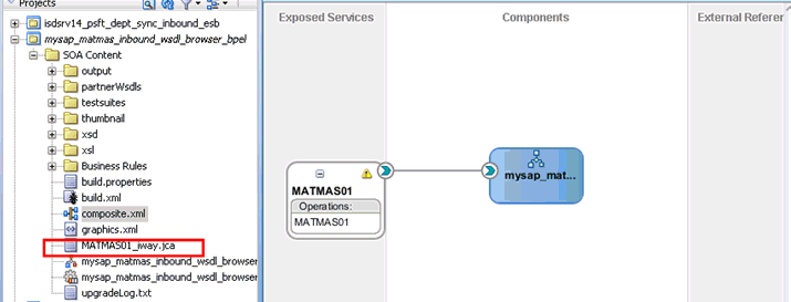

    migrated project
  10. Expand the migrated project in the left page and double-click the composite.xml file to verify that the project opens without any errors.
  11. Double-click the JCA properties file that is associated with this project (for example, MATMAS01_iway.jca).
  12. Remove the XMLRecordConverter line, as shown in the following image.
    JCA properties file
  13. Click Save.
  14. Compile and then deploy the migrated BPEL process project.
    Messages tab
  15. Verify that there are no error or warning messages during compilation and deployment.
  16. After the deployment is successful, trigger the event messages from the ERP system (for example, SAP GUI).
    The successful instances for the deployed process are received in the Oracle Enterprise Manager console.

The following changes must be made for every inbound ESB and BPEL process after the corresponding project is migrated to 11g.
  2. Click source.
  3. Navigate to the service section, check for the .jca file that has the naming convention as xxxx_iway.jca and replace with xxxx_iway_3P.jca (adding _3P as a suffix).
    Original:
    <service ui:wsdlLocation="isdsrv22_sampleAcct_receive.wsdl" name="samp_node"><interface.wsdl interface="http://xmlns.oracle.com/pcbpel/iWay/wsdl/Siebel/isdsrv22/samp_node#wsdl.interface(samp_nodePortType)" xmlns:ns="http://xmlns.oracle.com/sca/1.0"/><binding.jca config="samp_node_iway.jca"/></service>
    Modified:
    <service ui:wsdlLocation="isdsrv22_sampleAcct_receive.wsdl" name="samp_node"><interface.wsdl interface="http://xmlns.oracle.com/pcbpel/iWay/wsdl/Siebel/isdsrv22/samp_node#wsdl.interface(samp_nodePortType)" xmlns:ns="http://xmlns.oracle.com/sca/1.0"/><binding.jca config="samp_node_iway_3P.jca"/></service>
  4. Open the project folder and rename the same .jca properties file by adding _3P as a suffix in the .jca file (for example, samp_node_iway_3P.jca).
