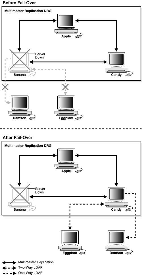

Since 10g (10.1.4.0.1), Oracle Internet Directory has supported failover of LDAP replicas from one supplier to another. Administrator intervention is required. Figure 38-1 shows a typical failover scenario.
This scenario has the following features:
Apple, Banana and Candy are multimaster replicas in the same DRG.
Damson is a read-only fan-out replica of Banana. That is, it is a partial replica using one-way LDAP replication.
Eggplant is an updatable fan-out replica of Banana. That is, it is a partial replica using two-way LDAP replication.
If Banana goes down, replication between the multimaster DRG and its fan-out replicas is broken.
An administrator can switch Eggplant and Damson to a new supplier, Candy.

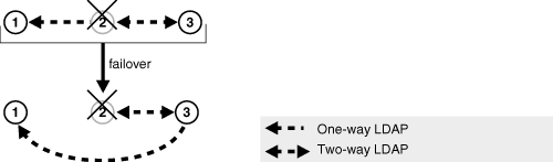

In most cases, you should fail over the replica in a way that preserves the original replica type. In the case shown in Figure 38-4, node 2 is the old supplier for both node 1 and 3, and node 1 is read-only. When node 2 fails, you could, in theory, set up either node 1 or 3 as the new supplier node. Best practice, however, is to fail over node 1 so that node 3 is the supplier. This preserves node 1's original, read-only replica type.

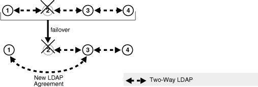

If the new agreement is a two-way agreement, after you compare and reconcile the consumer with its new supplier, you must also compare and reconcile all other replicas that are connected to the new supplier with the new supplier. For example, in Figure 38-5, Node 2 has a two-way agreement with Node 3. Node 3 is connected to another replica, Node 4. When Node 2 fails, you set up a two-way agreement between node 3 and node 1. After comparing and reconciling node 3 with node 1, you must also compare and reconcile Node 4 with node 3 to ensure that the replicas are synchronized.
