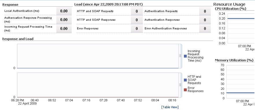

This is the home page for your Oracle Identity Federation server instance.
This page summarizes statistics about the server instance. For details about the metrics shown here, see Section 7.1.2, "Performance Summary".
Oracle Identity Federation provides a number of built-in metrics to enable application developers, system administrators, and others to measure application specific performance information. Metrics for system, state, and phase events are available in these functional areas:
