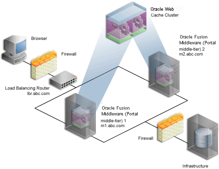

This section describes how you can set up Oracle Portal in a multiple middle-tier environment, front-ended by a Load Balancing Router (LBR) to access the same Oracle Metadata Repository.
Note: As with all out-of-the-box portal installations, this solution is best for internal deployments because it is not configured to use SSL. For the Oracle recommended way of configuring secure enterprise deployments, refer to the Oracle Fusion Middleware Enterprise Deployment Guide for Java EE. |
The purpose of an LBR is to provide a single published address to the client tier, and front-end a farm of servers that actually service the requests, based on the distribution of the requests done by the LBR. The LBR itself is a very fast network device that can distribute Web requests to a large number of physical servers.
Let us assume that we want to configure the multiple middle-tier configuration, shown in Figure 6-1. In the example, we show Oracle Web Cache on the same computer as the Oracle Portal middle tier, although they can theoretically be on different computers.
Figure 6-1 Multiple Middle-Tier Configuration with a Load Balancing Router
Table 6-1 Additional Information

Your configuration now looks like Figure 6-2, with the details described in Table 6-1.
Figure 6-2 Installation of Oracle Portal Middle Tier

After these steps, your configuration looks like Figure 6-3 with the details described in Table 6-1.
Figure 6-3 Oracle Portal Being Accessed Through the LBR

After these steps, your configuration looks like Figure 6-1.
Note: For adding more middle tiers, follow the procedures outlined in Section 6.3.4, "Step 4: Install a New Portal (M2)" and Section 6.3.5, "Step 5: Configure the New Middle Tier (M2) to Run Your Existing Portal", for each middle tier. |

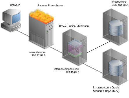

A reverse proxy server is a host process that is used as part of a firewall architecture to isolate the internal hosts from the externally accessible host(s). It does this by providing a proxy through which external requests must pass to access internal services. Typically, a proxy server takes the form of a dual-homed host. This means that it is a host with two network interface cards. One interface connects to the external network, and the other interface connects to the internal network, or demilitarized zone (DMZ) of the firewall.
Table 6-2 shows an architecture in which the browser accesses the server through the hostname that is published by the proxy server. The proxy server then forwards the request to the actual host within the firewall.
Caution: For this configuration to work properly, you must first configure OracleAS Single Sign-On to work with the reverse proxy server. Information on deploying OracleAS Single Sign-On with a proxy server can be found in the Oracle Application Server Single Sign-On Administrator's Guide. |
Figure 6-5 Reverse Proxy Server Configuration
For this example, consider the following:
| Property | Value |
| External server name | www.abc.com |
| External server port | 80 |
| Internal server name | internal.company.com |
| Web Cache listening port | 8090 |
| Web Cache Administration port | 8091 |
| Web Cache invalidation port | 8093 |
| OHS listening port | 8888 |
Note: The name and port values used in this section are for illustration purposes only, and you will need to substitute these with your own. Refer to Managing Ports, in the Oracle Fusion Middleware Administrator's Guide. |

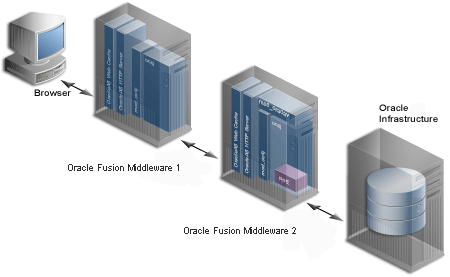

You can deploy Oracle Web Cache on a dedicated server that front-ends one or more Oracle Portal middle-tier servers. Oracle Web Cache performs well even on commodity hardware, so a dedicated deployment does not have to be costly in terms of hardware expenditure. In general, it is recommended to use a computer with 1 GB of memory. Both the cache server and middle-tier server need to use a high speed network card to ensure site performance. Refer to Section 1.3, "Understanding Caching in Oracle Portal" for an overview of how caching works in Oracle Portal.
To set up this topology, the administrator of the Web site needs to disable the Oracle Web Cache that was installed on the same computer as Oracle Portal middle tier, and set up a new Oracle Web Cache instance on a dedicated server. Figure 6-6 shows the topology where Oracle Portal uses a dedicated Oracle Web Cache instance.
Figure 6-6 Oracle Portal Using a Dedicated Oracle Web Cache Instance
For the Oracle Portal middle tier, you must install OracleAS Infrastructure first, and then the Portal middle tier.
After installing the OracleAS Infrastructure and middle tier on their respective servers, install J2EE and Web Cache middle tier on the dedicated server.
You can also install a standalone version of Oracle Web Cache from: http://www.oracle.com/technology/software/products/ias/web_cache/index.html
Oracle Universal Installer automatically configures and starts Oracle Portal middle tier and Oracle Web Cache on the same computer during the Oracle Portal middle-tier installation. You need to disable the Oracle Web Cache installed on the Oracle Portal middle-tier computer that is not used, and configure the dedicated Oracle Web Cache installed on a different computer to communicate with Oracle Portal middle tier.
Configuring a dedicated Oracle Web Cache for Web site: www.company.com, port number: 7777 involves the following six tasks:
