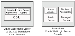

Figure 3-1 compares a typical standalone OC4J instance with a standalone Oracle WebLogic Server domain. In both cases, HTTP requests to each are handled by built-in HTTP listeners.
In Oracle WebLogic Server, the managed servers are similar to the OC4J instances you configured in Oracle Application Server 10g. However, Oracle WebLogic Server always provides a dedicated administration server, which hosts the Oracle WebLogic Server Administration Console. The Administration Console provides a Web-based management tool for Oracle WebLogic Server, similar to the Application Server Control used to manage OC4J.
Note that you can configure a simple Oracle WebLogic Server development domain with no managed servers. In such an environment, you would deploy your applications to the administration server. However, more typically, the administration server is dedicated to hosting the Administration Console and you deploy your applications to one or more managed servers within the domain.
Figure 3-1 Comparison of Oracle WebLogic Server and OC4J Standalone Architecture

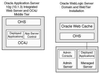

Figure 3-2 shows a typical Oracle Application Server 10g Release 2 (10.1.2) Integrated Web Server and OC4J middle tier installation and how it compares to a similar topology in Oracle Fusion Middleware 11g.
In Oracle Fusion Middleware, you must install and configure a separate Web tier installation, using the installation and configuration tools available on the WebTier and Utilities CD-ROM.
Figure 3-2 Comparison of Oracle WebLogic Server and OC4J with a Front-End Web Server

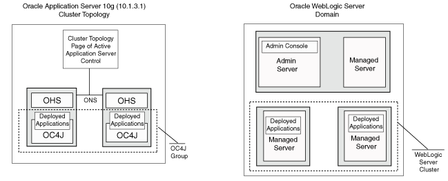

Table 3-1 compares the OC4J clustering features with those available in Oracle WebLogic Server.
Figure 3-3 illustrates differences between OC4J and Oracle WebLogic Server clustering.

Figure 3-3 Comparison of OC4J Groups and Oracle WebLogic Server Clusters

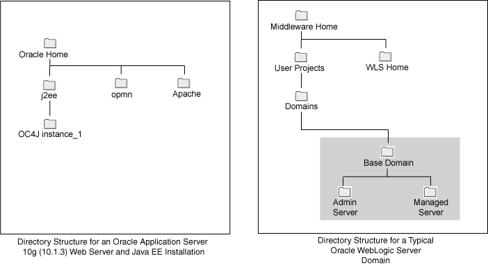

The directory structure of a typical Oracle WebLogic Server domain differs from the directory structure of an Oracle Application Server 10g instance in several ways.
When you install Oracle Application Server 10g, you create a single Oracle home that contains the j2ee directory. The OC4J-specific configuration files and log files reside inside the j2ee directory.
In Oracle WebLogic Server, the installation is enclosed within a Middleware home. Within the Middleware home, the installer creates the Oracle WebLogic Server home directory. When you configure a domain, the Oracle WebLogic Server Configuration Wizard creates a new domain inside the user_projects directory.
Figure 3-4 shows the difference between the Oracle WebLogic Server and OC4J directory structures.
Figure 3-4 Comparison of the Oracle WebLogic Server and OC4J Directory Structures

As shown in Figure 3-4, the binary and configuration files associated with the OC4J instances you create are stored in a subdirectory structure inside the Oracle Application Server 10g Oracle home (the j2ee directory structure). Not only is this direct file system association required, but the relationship between the OC4J binaries and the configuration of instances is at a per instance level.
In contrast, Oracle WebLogic Server provides a clear separation between the installed software and its different configuration instances. A single Oracle WebLogic Server installation can be used to create multiple domains, each with a different set of servers.
By default, the Oracle WebLogic Server configuration wizard assumes that you will place the configuration files for each domain inside the user_projects/domains directory. However, the files associated with a domain can reside anywhere within the file system. For a WebLogic Server instance to run from a domain directory, the only requirement is that the Oracle WebLogic Server directory must be accessible.
Note also that in the WebLogic Server model, the relationship between the WebLogic Server binaries and the configuration of instances is at a per domain (set of instances) level.
