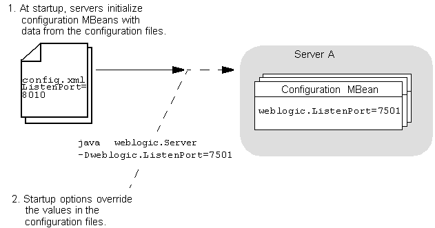

In most cases, you do not use startup options to override the configuration that is saved in the domain's config.xml
file. However, in some extraordinary cases you might need to do so.
Tip: When you use a startup option to override a configuration value, the server instance uses this value for the duration of its life cycle. Even if you use the Administration Console, the WebLogic Scripting Tool, or some other utility to change the value in the configuration, the value will remain overridden until you restart the server without using the override. |
For example, in a production environment, your organization might have a policy against modifying the domain's config.xml
file, but you need to shut down the Administration Server and restart it using a temporary listen port. In this case, when you use the weblogic.Server
command to start the Administration Server, you can include the -Dweblogic.ListenPort=7501
startup option to change the listen port for the current server session. The server instance initializes its configuration MBeans from the config.xml
file but substitutes 7501
as the value of its listen port. When you subsequently restart the server without passing the startup option, it will revert to using the value from the config.xml
file, 8010
. (See Figure 3-1.)
